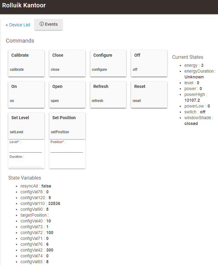

I guess it does. Actually, it's the standard driver provided by HE. Plz see screenshots:

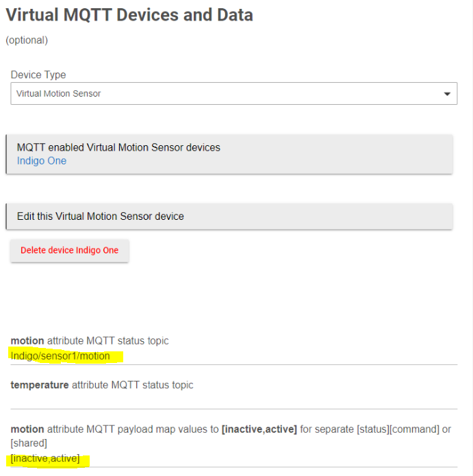

We can do that now - what you need is to decide on a topic that the status of the motion sensor (from Indigo) will be sent to and the payload. If you can use 'active' 'inactive' that makes it easier in HE but you can use anything. Don't create the topic inside the homie/... tree - place it elsewhere.
Let's assume you use
Indigo/sensor1/motion
and the payload is either active or inactive
When this is working from Indigo (or MQTT Explorer) - i.e. it updates as the sensor in Indigo does then we will import this 'arbitrary' device into HE
Select a Device Type of Virtual Motion Sensor and enter a name at the bottom eg "Indigo One" - click outside the name field and then 'Create Device Indigo One'
Now enable this device in the second dropdown and click 'Edit this Virtual Motion Device' and select your device Indigo One and 'Update' You will see some extra data for the device. You should fill in the motion status topic with the MQTT topic you chose. Check there is no leading space.
Note that further down inactive|active are already the default value for status of this device. If you choose other values then they should be entered here.
Now click
Next and Done..
(You may have to re-run the app once more through to done)
You have now created your virtual device and it is linked to the status topic that Indigo is updating so it will reflect the Indigo motion sensor status. You can't control the Indigo sensor from HE though - that doesn't make sense and you didn't want to anyway.
Let me know if that works for you

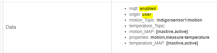

The difference to your initial approach here is that the virtual motion sensor was created from within the MQTT app and is thus a child device of the app. If you look within the device itself it will have the following extra data.
