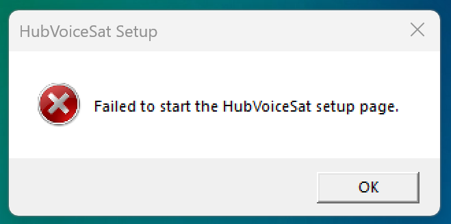

Ok, a different issue I'm afraid, when I run the HubVoiceSat.exe nothing happens, I can see the executable in the processes list, but no web page opens :frowning:
Damn, okay. Need more info though. Version?
Also, be sure to delete everything in your HubVoiceSat folder and replace it with the new contents of the Dropbox download. Things have changed a bit.
I just fired up version 2026.04.08.1 and it loaded fine. Took about 30 seconds though... still working on that! After you make sure you have the latest version. Double click on the HubVoiceSat.exe and watch the directory. A third file should popup, hubvoice-runtime.lock. Once that is in there, wait a few more seconds and the webpage should open.
If the hubvoice-runtime.lock is already in there before clicking on the exe, that could be a problem right there. If the hubvoice-runtime.lock is in the folder, then the process in already running. Look in the toolbar (right hand corner) and see if the little microphone is there. If it is, right click on it and see if it's running or stopped. If it's running, double click the icon and the webpage will open. If it's stopped, select 'Shutdown and Exit' and the lock should disappear from the folder. You can now double click on the exe again. If you shut down from the icon and the lock is still in the folder, you'll need to reboot to clear the lock.
Seems you and I are the only two working on this, so hang in there! lol. I do appreciate it.

@bptworld Sadly still not working mate.
To be sure I rebooted although this didnt remove the .lock file.
But after reboot there was a change, simply an error.
There is nothing in the system tray in order to try anything further.
Also checked the event logs for anything sinister, sadly no further information in there either :unamused:

Sadly the same error box. But ran the runtime again.
