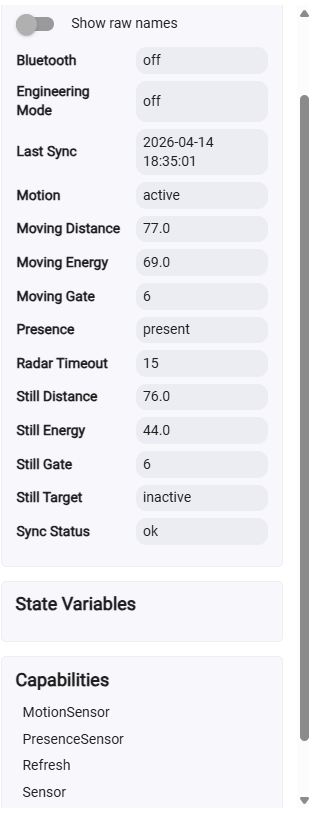

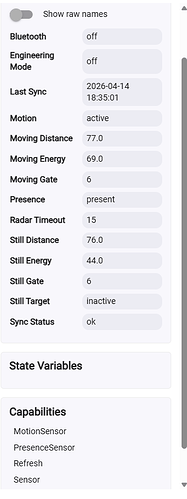

I added a LD2410 (mmwave) sensor to the board, changed the code a bit and BAM, it works! :smile: Lots of testing to do but it looks promising. I also have a LD2450 (mmwave with tracking) to play around with but haven't done anything with that one yet.

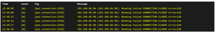

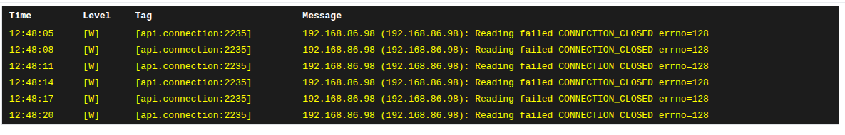

The last comment is i am getting scrolling errors on my HA-PE with it complaining about the connection. I have moved the Jetson to the same network vlan to prevent any chance of firewall and such being a problem.

Well that update does seem to have fixed most of what i said previously. Loopback and the external ip are now enabled for both runtime and setup pieces. The issue with the Piper voice seems to not be reoccurring even after saving the configuration data again. Values seem to persist after exiting the HubvoiceSAT.
What is till occuring is the wake word isn't working,and i am getting the errors shown above from the HA PE web ui.
