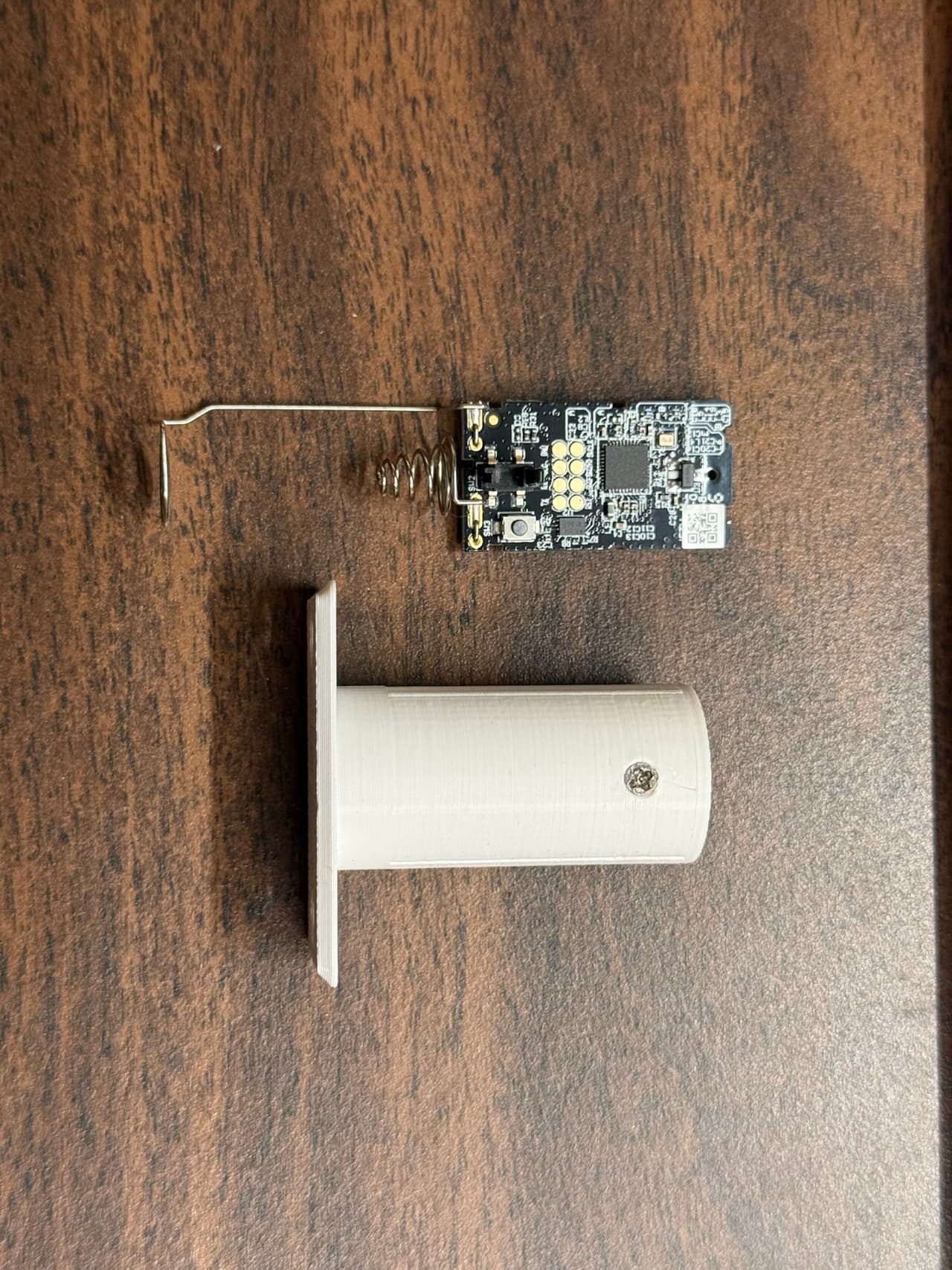

What drew me to these is their size. I designed, and 3D printed custom housings that convert them to a recessed door sensor. I have several of the Aeotec recessed sensors and wanted something about the same diameter to keep hole size reasonably small. The new housing is virtually the same diameter, yet about half the length of the Aeotec. I plan to add another 6-10 door sensors and the Aeotec Z-Wave version is fairly pricey.

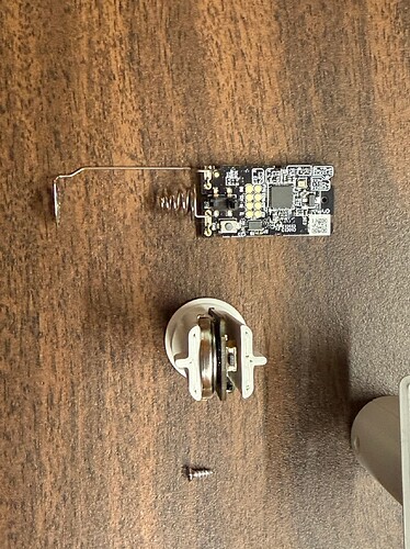

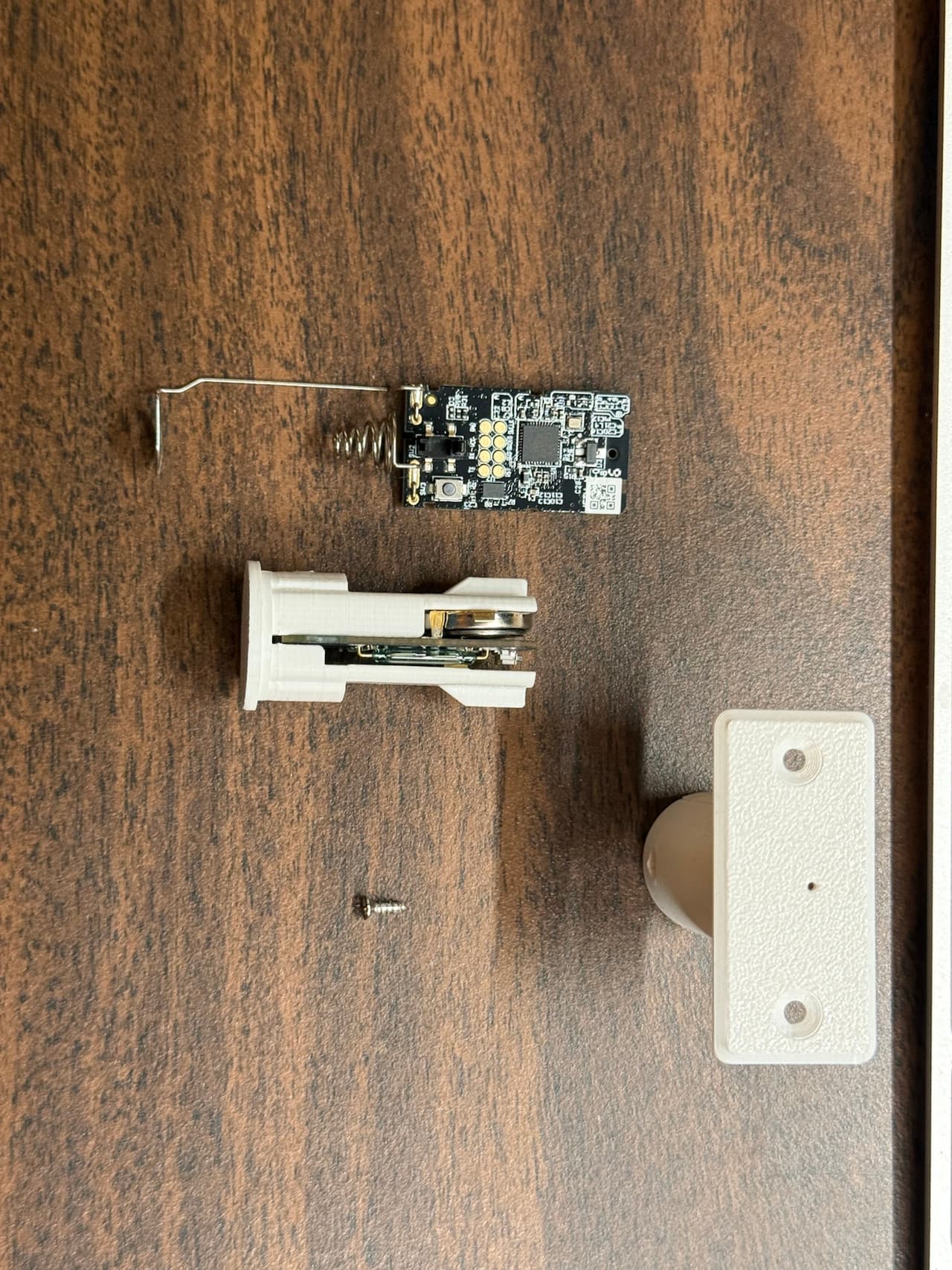

I did find one small issue that's probably related to the driver. When it's removed from the backing plate, the LED shows tamper status. This however, does not show in Hubitat.
In the three photos I've attached, You'll see the Philips Hue sensor, which is longer, with the battery connection terminals. The PCB is 17mm wide, whereas the Aqara PCB is 16.1mm. The disadvantage to the Aqara is the button battery because the holder increases the width to 16.5mm. Still narrower than the Hue, but it's not centered which requires the casing to be a slightly larger diameter than preferred. In any event, I should be able to make the Hue sensor work as a recessed device.
