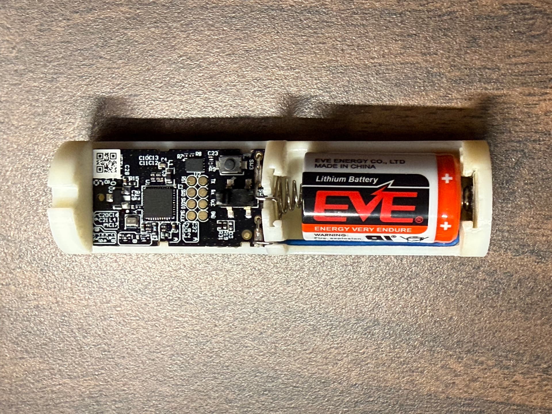

On this Hue sensor, there aren't any reed switches. It appears they have placed a hall effect sensor on each side of the board, perpendicular in orientation to each other. Since they are centered, The magnet can be mounted on the left, right, or top. This theory also supports what the instruction leaflet shows.

Well, I guess it's going to be the Hue Contact Sensor. I designed and printed the carrier for the battery and PCB. There is quite a bit of detail, so I used a 0.2mm nozzle. The material is ASA for strength. This is ultimately what I had achieved with the custom housing for the Aqara sensor. It's just too bad it's flaky (without help) outside of their own environment.
This will definitely work. It's a little larger diameter than I'd hoped for, but Rev 2 may come along to shave some of that off. It will fit into a 7/8-Inch hole using the outer mounting housing (not shown yet as the final version is on the print bed). I've also managed to preserve the functionality of the tamper switch, although it doesn't seem to register in Hubitat even when the LED is flashing a warning. I'm not too concerned about this.

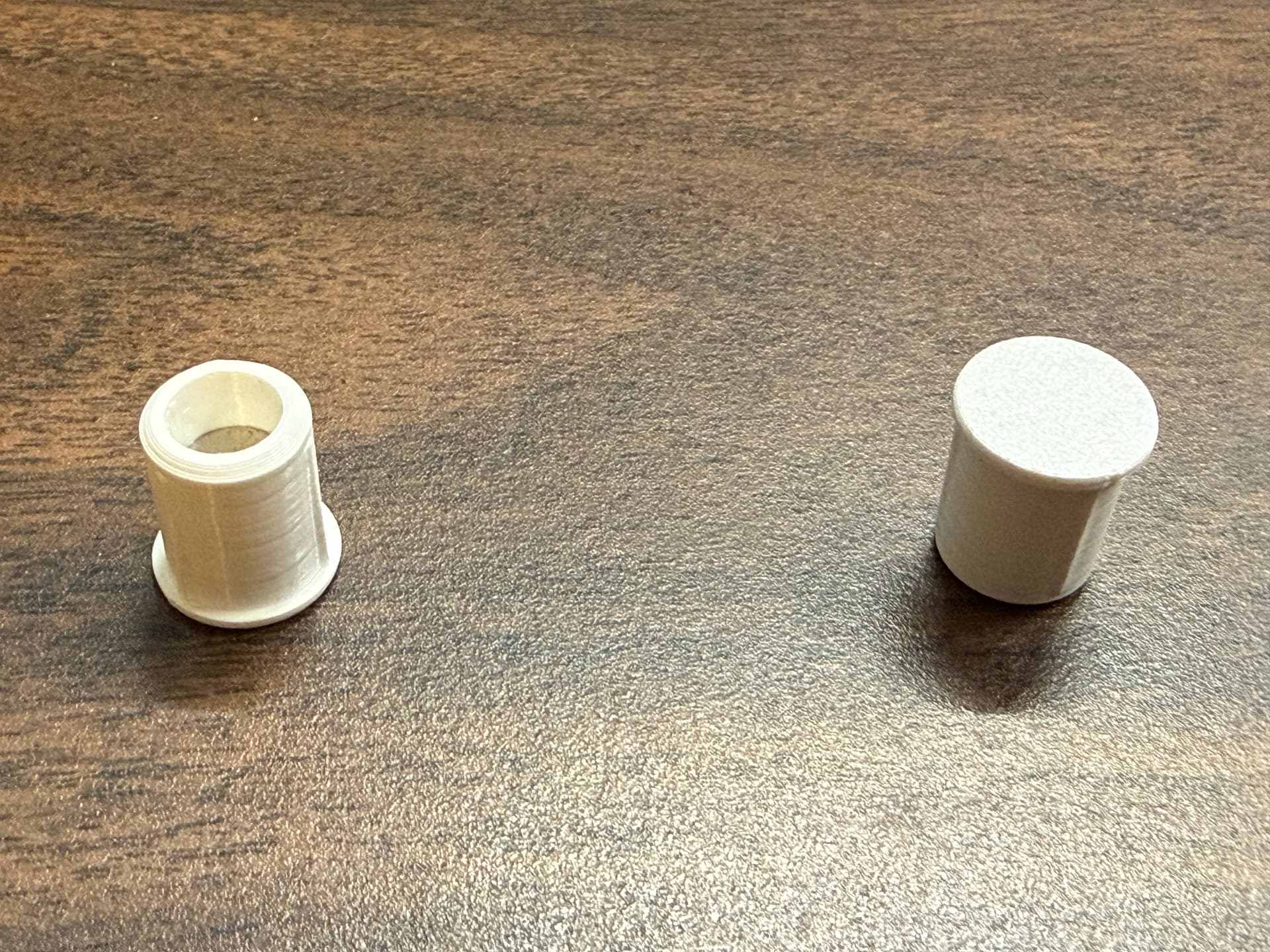

I bought some small neodymium magnets and printed housings for them. These will press into the door jamb just like any similar commercial product.

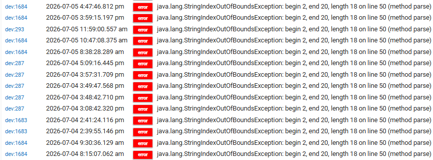

So, I love my Aqara contact sensors (they are working great, stay connected, have a wonderful battery life, etc.), but I’m getting the same index out of bounds error on every single one. For example:
I’m using the built-in driver:

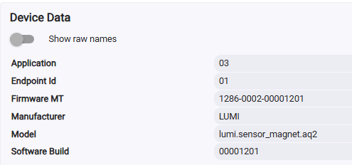

They are IDed as follows:
It’s a minor issue in the grand scheme of things, given they seem to be working well, but these are the only errors I see in my logs. I guess I just want to report the issue to whomever is responsible for the driver. I’d be happy to run any tests or gather more information to help identify the issue.

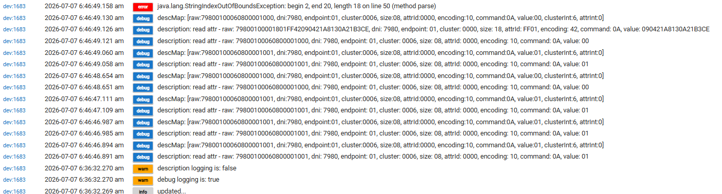

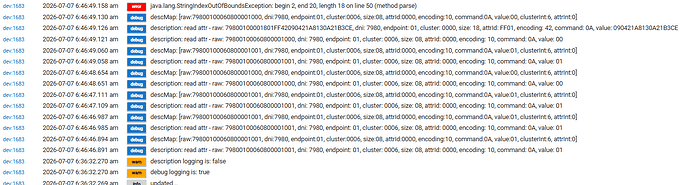

Can you enable debug logging then post those results?
Here’s one with debugging on:
can you copy and then paste the text of 3 lines 6:46:49.126 through 6:46:49.158 in that log?, that way i don’t have to manually type the data, thanks!
**dev:1683**2026-07-07 6:46:49.158 am
error
java.lang.StringIndexOutOfBoundsException: begin 2, end 20, length 18 on line 50 (method parse)
**dev:1683**2026-07-07 6:46:49.130 am
debug
descMap: [raw:79800100060800001000, dni:7980, endpoint:01, cluster:0006, size:08, attrId:0000, encoding:10, command:0A, value:00, clusterInt:6, attrInt:0]
**dev:1683**2026-07-07 6:46:49.126 am
debug
description: read attr - raw: 79800100001801FF42090421A8130A21B3CE, dni: 7980, endpoint: 01, cluster: 0000, size: 18, attrId: FF01, encoding: 42, command: 0A, value: 090421A8130A21B3CE
