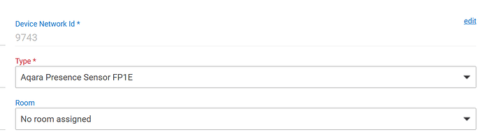

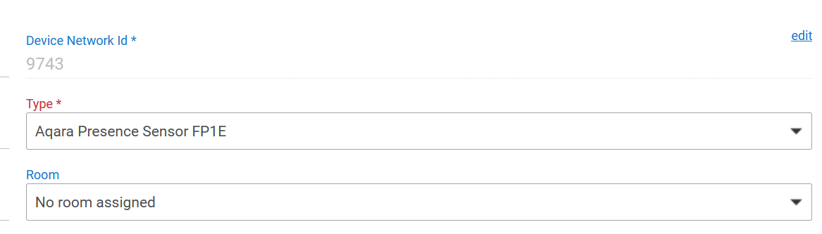

Just tried the Double Luck voodoo. The device paired in the fashion. I noticed that the Device Type section is red. I've tried a couple times selecting the FP1e in the drop down and saving but it continues to go back to RED after a refresh
I can't recall seeing this label in red color... Is your Zigbee radio working OK?
'Aqara Presence Sensor FP1E' is the Hubitat built-in system driver, not the custom one we discussed before.
