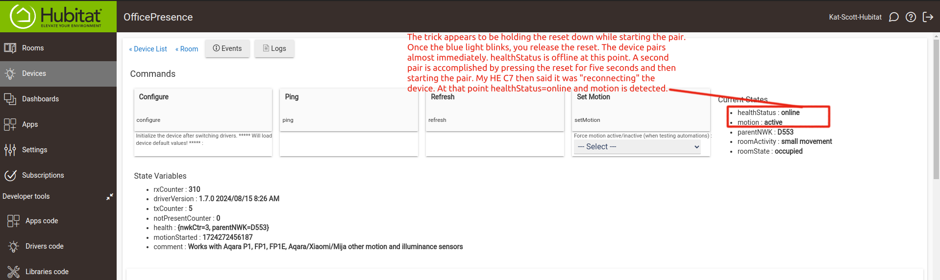

Ok, so you were absolutely correct about trying several times. After the 25th time, it worked.
I noticed that the other driver has "motion zones". Are motion zones one of your future plans?
Byt the way, thanks so much for all your comments. I'd have to say that diligence seems to be the word of the day.
