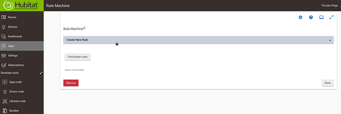

Perhaps the easier question to ask is, in the Apps page, do you see something like this, with a Legacy App, or just Rule Machine.

I'm having the same issue. A new C5 hub. Did the latest firmware update 2.3.6.146. I added Rule Machine and get the error 404 when I try to make a new rule. Tried removing Rule machine, reboot, reinstall. No love. Any suggestions?
