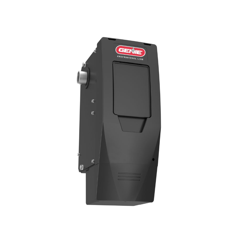

just fyi this solution, using the relay, does not work for the side mount openers, which are so much better from a space standpoint and way quieter in operation.
since there is no wires anywhere in the setup. the overhead light and the wall mount buttons are both bluetooth. there is no way to intercept based on How to Use the ZEN16 MultiRelay as a Garage Door Opener on Hubitat - Zooz Support Center
i really hope either it can be reversed engineered again or genie opens up their API, i have at least emailed support asking for hubitat support or opening the API :man_shrugging:
