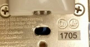

If I'm remembering correctly, the Enbrighten branding was a few years after the 2017 batch that had the capacitor issue. OP should check the date code (which doesn't require removing the switch).
While that issue did manifest after a power cycle, it would be rather odd for nearly 30 switches to fail at once. Could there have been a power surge?
Is the date code on the front of the switch? So just remove the faceplate?

Right. A label like this says May 2017 manufacture. As far as I know, all the switches with failing caps were 2017 manufacture.
That dimmer says "2044B" while the switch that's working right next to it says "2146B". And they're "UltraPro" if that makes a difference (too many different switch brands!). Dimmer is for the bathroom lights, switch is for the bathroom fan.
