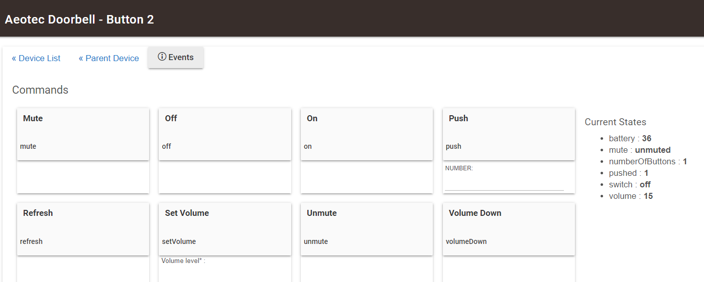

I know the driver still partially works as when I clicked refresh the battery level changed. But pushing the button no longer gets the "switch" status to change.
FYI, I switched back to the Aeotec Doorbell 6 driver as the new one deletes the component devices.

I have driver set to "Aeotec Doorbell 6" and am still not seeing button presses in the EVENTS log. Has this been fixed to work this way?
I read through this whole thread and maybe I'm missing it but I don't see any clear evidence that this was ever rectified? Am I missing something?
I'm not sure. I am using the built-in driver called "Aeotec Siren 6 New" with the Doorbell 6, and as indicated in the screen shots below, I can definitely see pushed events. Also, automations based on the button being pushed work perfectly.
Ok you're using a different driver. Let me try the siren driver and see how it goes, thanks!
@bcopeland
I can reproduce the issue that @wogfun saw with the built-in "Aeotec Doorbell 6" driver.
Basically, while the Doorbell button component devices are created, when the button is pushed, no event is generated for either the parent device or the child device.
In contrast, events are generated when the same device is used with the built-in "Aeotec Siren 6 New" driver, although this driver doesn't permit the creation of doorbell button component devices.
