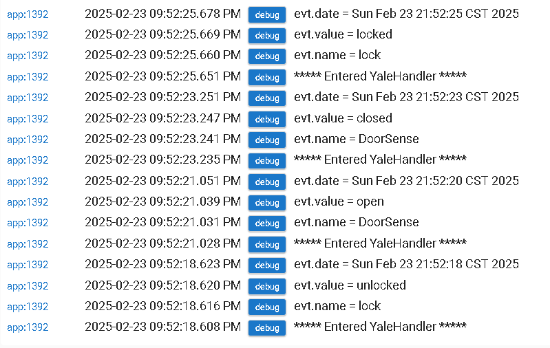

Adding DoorSense To Z-Wave Yale Driver
I have recently purchased a Yale Assure Lock 2 (YRD450-F-ZW3-619). It has a Z-Wave module in it and I have also purchased the Wi-Fi bridge that works with it. I have used the Generic Z-Wave Lock driver and it does not include anything for DoorSense. The source code for that driver is not available so I did a search and found https://raw.githubusercontent.com/hansandersson/hubitat/master/yale-assure-z-wave-lock.groovy source code. This driver worked OK except for lock codes which does not concern me at this time. I have never written a driver so I thought modifying this one would be fun to try. I have added code to the driver and it functions in my custom app when I subscribe to my new attribute DoorSense. Now my question is that if you look at the inline code I added to the routine "zwaveEvent(hubitat.zwave.Command cmd)" at line 962 to provide DoorSense I am VERY sure that this code should be in a separate new zwaveEvent() routine. I could not figure out how to do that and would love for someone to tell me the proper way I should include this functionality. I really appreciate the help.
My modified driver follows:

Update 6 hours later:
When I open and close the door I do see in the device page under Current States the "DoorSense" properly showing open and closed. I also see when I manually or with the app lock and unlock the status is reported on the device page correctly. But, when I select lock and unlock from the device page is does not work. When I select lock on the device page I do see in the log "[DTH] Executing lock() for device Yale Assure 2 - Front Door" (from line 1025) but the lock does not respond and no error reported.
I found out that the driver I was trying to modify did not comply with S2 security. I found a few articles in the Hubitat doc's and was able to add the Supervision class and zwaveSecureEncap() and now I have Lock() and Unlock() working. When I try to get the lock codes I am getting an error. It would seems likely that the lock is sending back the data encoded for S2. If that is true how do I convert the data to be decoded so I can use it? Thanks

Thanks to everyone above that helped me. I have modified a Yale Assure Lock 2 driver I found that was written in 2019 that did not have S2 security concerns in it. I have added that coding (I hope) and it looks like it works. I put in some initial code for DoorSense but could not finish it because my lock no longer will send any Door Sense info to parse() for final coding. The DoorSense coding worked but it needed to be moved to its own zwaveEvent() routine. I added the routine but then found out I couldn't finish coding. Please do a find for "DoorSense" and look at the comments if you want that functionality.
Yale Assure Z-Wave Lock Driver

        /* The following "indented" code was a first attempt at adding DoorSense.
         * This code worked but before I could move it to it's own zwaveEvent
         * routine the lock would not generate anything to the parse() routine.
         * I added two unfinished zwaveEvent routines above:
         *    zwaveEvent(hubitat.zwave.commands.notificationv3.NotificationReport cmd)
         *    zwaveEvent(hubitat.zwave.commands.alarmv1.AlarmReport cmd)
         * So, I do not believe the following code will funtion anymore.  If you comment
         * out the above routines it will probably work... better yet please move/modify
         * the following code and put it in the proper zwaveEvent() routine.
        try {
            def cmdMap = GetMap(cmd.toString())
        //        log.debug "*** cmdMap *** = " + cmdMap
            def encapsulatedCmd = cmd.encapsulatedCommand(commandClassVersions)
        //        log.debug "*** encapsulatedCmd *** = " + encapsulatedCmd
            def Map = GetMap(encapsulatedCmd.toString())
        //        log.debug "*** encapsulatedMap *** = " + Map
        catch (e){
            log.warn "updated() threw $e"
            log.debug "Exception catch in 'zwaveEvent(hubitat.zwave.Command cmd)'"
        // is this a NotificationReport
        if (encapsulatedCmd.toString().indexOf("NotificationReport") == 0) {
            log.debug "got NotificationReport"
            // is this v1AlarmType = 0x2b  (DoorState/DoorSense)
            if (Map.v1AlarmType == 43) {
                // what is the state of DoorSense
                log.trace "got v1AlarmType = 43"
                switch (Map.v1AlarmLevel) {
                    case 0:  // Door is open
                        log.trace "got v1AlarmLevel = 0  (Door Open)"
                        sendEvent(name: "DoorSense", value: "open", isStateChange: true)
                        break;
                    case 1:  // Door is closed
                        log.trace "got v1AlarmLevel = 1  (Door Closed)"
                        sendEvent(name: "DoorSense", value: "closed", isStateChange: true)
                        break;
                    case 2:  // Door Propped (door open for longer than configurable door propped open)
                        log.trace "got v1AlarmLevel = 2  (Door Propped)"
                        sendEvent(name: "DoorSense", value: "Propped", isStateChange: true)
                        break;
                    default:
                        log.trace "NotificationReport Error (Received non supported v1AlarmLevel from lock)"
                        break;
    createEvent(displayed: false, descriptionText: "$cmd")

def zwaveEvent(hubitat.zwave.commands.notificationv3.NotificationReport cmd) {
	log.trace "[DTH] Executing 'zwaveEvent(hubitat.zwave.commands.notificationv3.NotificationReport' with cmd = $cmd"
    if (cmd.v1AlarmType == 43) {
        switch (cmd.v1AlarmLevel) {
                break;
                break;
                break;
            default:
                break;

Don't know if you're still trying to get DoorSense working. I got obsessed with it and heavily modified the driver that you linked. It reports door sense events now and registers the door as a contact sensor so existing code can work with it. The lock codes is updated to work with Lock Code Manager as well. I apologize upfront for the coding and commenting quality, especially the commenting. This is just a hobby for me and I've never programmed in an organized setting.
 * 	Z-Wave Lock
 *  Derivative Work Copyright 2025 Joe McNamee
 *  (Previous: Derivative Work Copyright 2019 Hans Andersson, Copyright 2024 William Siggson)
 *  Licensed under the Apache License, Version 2.0 (the "License"); you may not use this file except
 *  in compliance with the License. You may obtain a copy of the License at:
 *      http://www.apache.org/licenses/LICENSE-2.0
 *  Unless required by applicable law or agreed to in writing, software distributed under the License is distributed
 *  on an "AS IS" BASIS, WITHOUT WARRANTIES OR CONDITIONS OF ANY KIND, either express or implied. See the License
 *  for the specific language governing permissions and limitations under the License.
  *  Joe McNamee modified code to work properly with doorsense and enable contact sensor
  *  Also brought event handling to current standard (sendevent vs createevent percolation), corrected lock code support for lock code manager
metadata {
	definition (name: "Yale Assure Z-Wave Lock", namespace: "Mrjoemac", author: "Joe McNamee") {

 * Responsible for handling DoorSense events
 * @param cmd: The AlarmReport command to be parsed
 * @return: does not return data
private def handleDoorSenseReport(cmd) {
    log.trace "[DTH] Executing 'handleDoorSenseReport' with cmd = $cmd"
	def deviceName = device.displayName
    def map = [ name: "contact", value: "open", descriptionText: "", isStateChange: true ]
    map.data = [ lockName: deviceName ]
    switch (cmd.alarmLevel) {
            map.value = "open"
            map.descriptionText = "Door opened"
            sendEvent(map)
            break;
            map.value = "closed"
            map.descriptionText = "Door closed"
            sendEvent(map)
            break;
            map.value = "open"
            map.descriptionText = "Door propped opened"
            sendEvent(map)
            break;
        default:
            log.trace "NotificationReport Error (Received non supported DoorSense alarmLevel from lock)"
            break;
