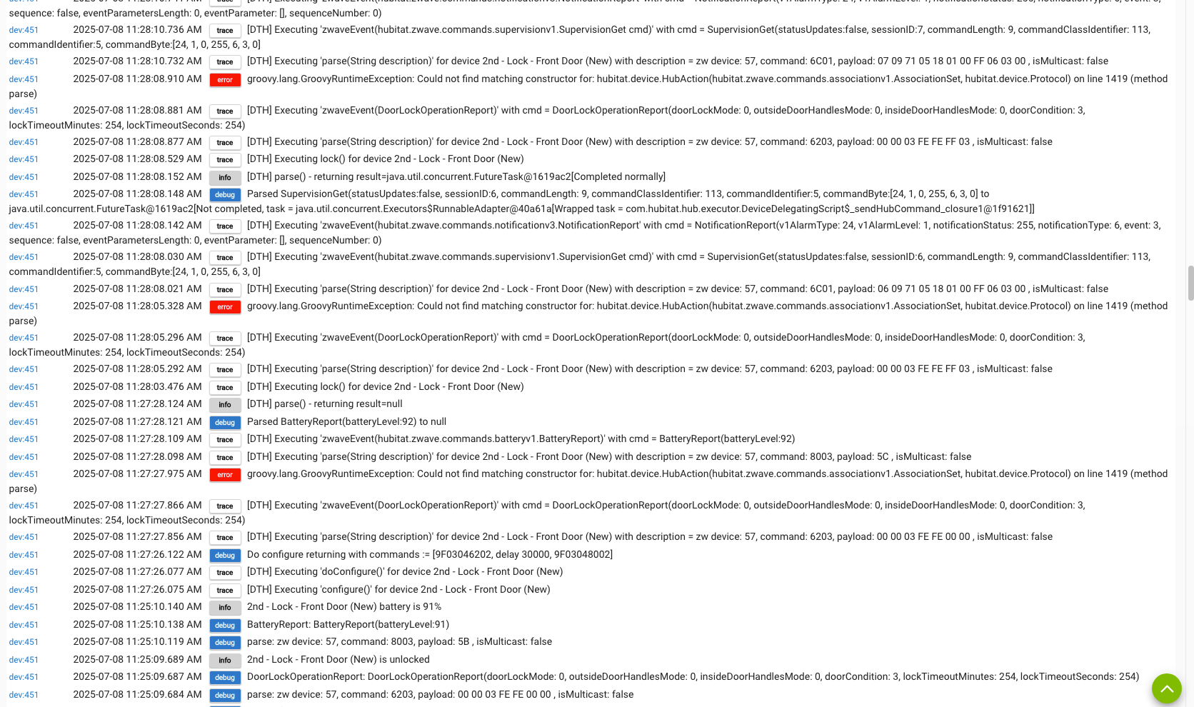

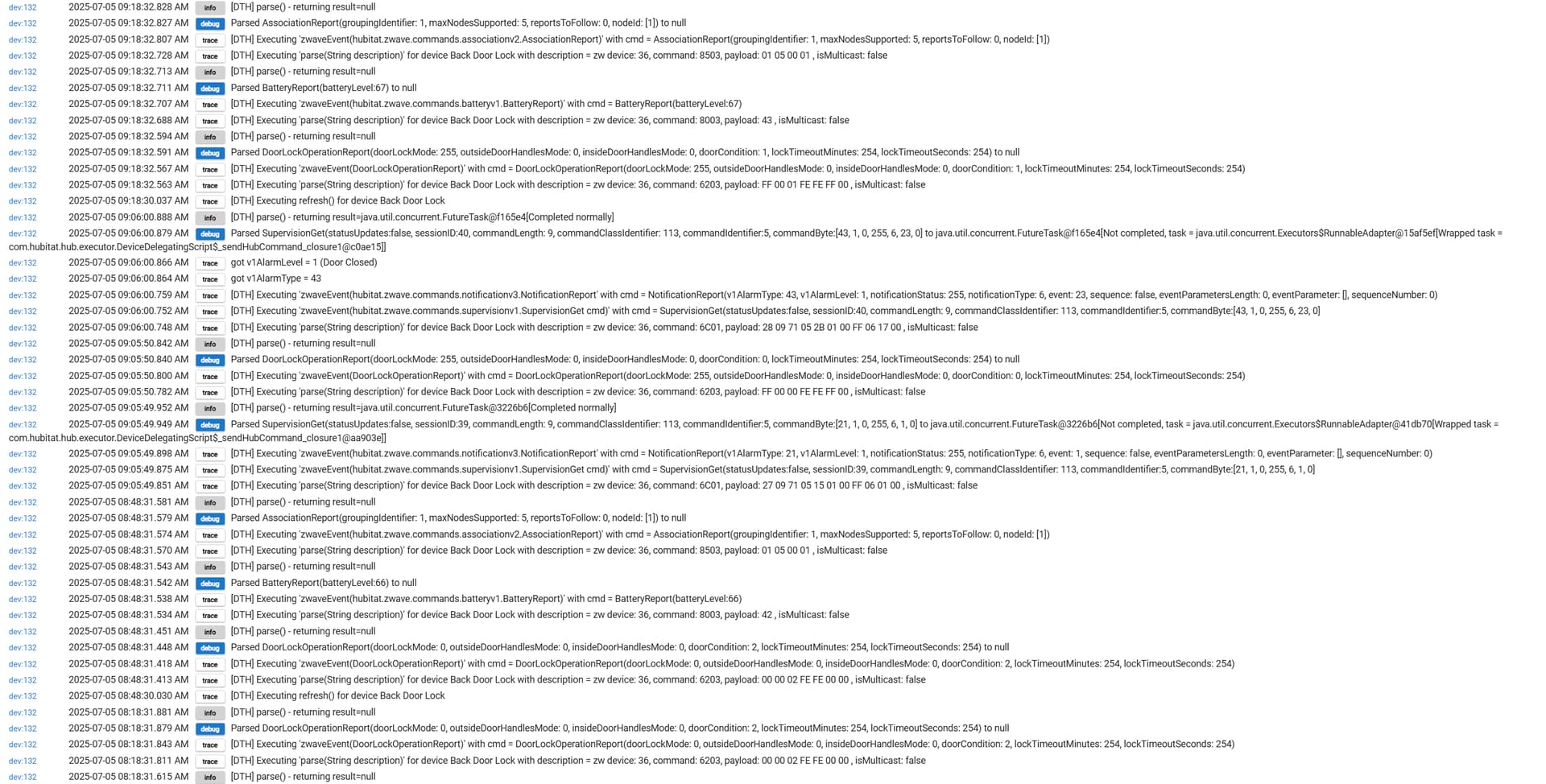

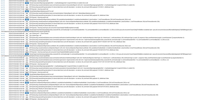

Post a screenshot of the logs. I looked at the driver code and it should be producing an ungodly amount of debug and trace logs all the time. I don't see any way to turn them on or off. I should be able to see whats going wrong with the logs.
Thanks for your help. I've attached a screenshot of the logfile before and after I closed and locked the door this morning.

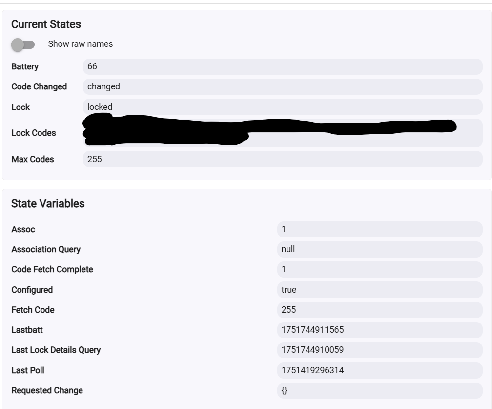

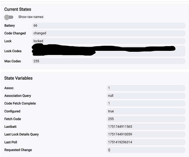

I've also attached a screenshot of the state variables that I see on the device page.

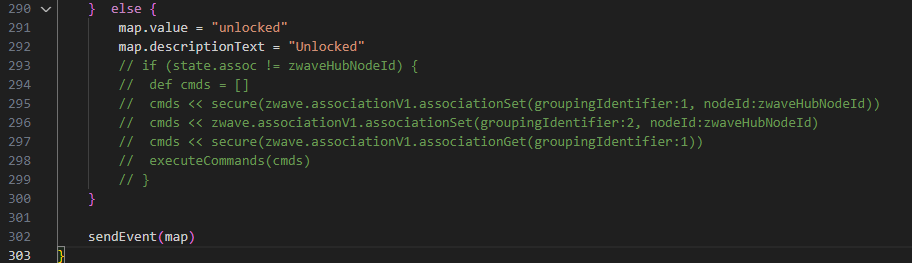

OK I see the issue. When @joemc91 converted it to use the contact state, one section was missed which is where the reports from your device are landing.
Try this code, you can just overwrite the existing driver with it. I only changed a few lines.

Here are my logs:
[dev:451](http://192.168.11.4/device/list#)2025-07-08 11:40:05.441 AM
error
groovy.lang.GroovyRuntimeException: Could not find matching constructor for: hubitat.device.HubAction(hubitat.zwave.commands.associationv1.AssociationSet, hubitat.device.Protocol) on line 1419 (method parse)
[dev:451](http://192.168.11.4/device/list#)2025-07-08 11:40:05.408 AM
trace
[DTH] Executing 'zwaveEvent(DoorLockOperationReport)' with cmd = DoorLockOperationReport(doorLockMode: 0, outsideDoorHandlesMode: 0, insideDoorHandlesMode: 0, doorCondition: 2, lockTimeoutMinutes: 254, lockTimeoutSeconds: 254)
[dev:451](http://192.168.11.4/device/list#)2025-07-08 11:40:05.402 AM
trace
[DTH] Executing 'parse(String description)' for device 2nd - Lock - Front Door (New) with description = zw device: 57, command: 6203, payload: 00 00 02 FE FE 00 00 , isMulticast: false
[dev:451](http://192.168.11.4/device/list#)2025-07-08 11:40:04.546 AM
info
[DTH] parse() - returning result=java.util.concurrent.FutureTask@120e553[Completed normally]
[dev:451](http://192.168.11.4/device/list#)2025-07-08 11:40:04.542 AM
debug
Parsed SupervisionGet(statusUpdates:false, sessionID:24, commandLength: 19, commandClassIdentifier: 113, commandIdentifier:5, commandByte:[19, 6, 0, 255, 6, 6, 10, 99, 3, 6, 1, 57, 53, 54, 56, 50, 52] to java.util.concurrent.FutureTask@120e553[Not completed, task = java.util.concurrent.Executors$RunnableAdapter@142c48[Wrapped task = com.hubitat.hub.executor.DeviceDelegatingScript$_sendHubCommand_closure1@14ca516]]
[dev:451](http://192.168.11.4/device/list#)2025-07-08 11:40:04.535 AM
trace
[DTH] Executing 'zwaveEvent(hubitat.zwave.commands.notificationv3.NotificationReport' with cmd = NotificationReport(v1AlarmType: 19, v1AlarmLevel: 6, notificationStatus: 255, notificationType: 6, event: 6, sequence: false, eventParametersLength: 10, eventParameter: [99, 3, 6, 1, 57, 53, 54, 56, 50, 52], sequenceNumber: 0)
[dev:451](http://192.168.11.4/device/list#)2025-07-08 11:40:04.528 AM
trace
[DTH] Executing 'zwaveEvent(hubitat.zwave.commands.supervisionv1.SupervisionGet cmd)' with cmd = SupervisionGet(statusUpdates:false, sessionID:24, commandLength: 19, commandClassIdentifier: 113, commandIdentifier:5, commandByte:[19, 6, 0, 255, 6, 6, 10, 99, 3, 6, 1, 57, 53, 54, 56, 50, 52]
[dev:451](http://192.168.11.4/device/list#)2025-07-08 11:40:04.522 AM
trace
[DTH] Executing 'parse(String description)' for device 2nd - Lock - Front Door (New) with description = zw device: 57, command: 6C01, payload: 18 13 71 05 13 06 00 FF 06 06 0A 63 03 06 01 39 35 36 38 32 34 , isMulticast: false
[dev:451](http://192.168.11.4/device/list#)2025-07-08 11:39:39.829 AM
info
[DTH] parse() - returning result=null
[dev:451](http://192.168.11.4/device/list#)2025-07-08 11:39:39.827 AM
debug
Parsed DoorLockOperationReport(doorLockMode: 255, outsideDoorHandlesMode: 0, insideDoorHandlesMode: 0, doorCondition: 0, lockTimeoutMinutes: 254, lockTimeoutSeconds: 254) to null
[dev:451](http://192.168.11.4/device/list#)2025-07-08 11:39:39.776 AM
trace
[DTH] Executing 'zwaveEvent(DoorLockOperationReport)' with cmd = DoorLockOperationReport(doorLockMode: 255, outsideDoorHandlesMode: 0, insideDoorHandlesMode: 0, doorCondition: 0, lockTimeoutMinutes: 254, lockTimeoutSeconds: 254)
[dev:451](http://192.168.11.4/device/list#)2025-07-08 11:39:39.771 AM
trace
[DTH] Executing 'parse(String description)' for device 2nd - Lock - Front Door (New) with description = zw device: 57, command: 6203, payload: FF 00 00 FE FE FF 00 , isMulticast: false
[dev:451](http://192.168.11.4/device/list#)2025-07-08 11:39:38.853 AM
info
[DTH] parse() - returning result=java.util.concurrent.FutureTask@62757c[Completed normally]
[dev:451](http://192.168.11.4/device/list#)2025-07-08 11:39:38.850 AM
debug
Parsed SupervisionGet(statusUpdates:false, sessionID:23, commandLength: 9, commandClassIdentifier: 113, commandIdentifier:5, commandByte:[21, 2, 0, 255, 6, 1, 0] to java.util.concurrent.FutureTask@62757c[Not completed, task = java.util.concurrent.Executors$RunnableAdapter@1d02e66[Wrapped task = com.hubitat.hub.executor.DeviceDelegatingScript$_sendHubCommand_closure1@4830fc]]
[dev:451](http://192.168.11.4/device/list#)2025-07-08 11:39:38.845 AM
trace
[DTH] Executing 'zwaveEvent(hubitat.zwave.commands.notificationv3.NotificationReport' with cmd = NotificationReport(v1AlarmType: 21, v1AlarmLevel: 2, notificationStatus: 255, notificationType: 6, event: 1, sequence: false, eventParametersLength: 0, eventParameter: [], sequenceNumber: 0)
[dev:451](http://192.168.11.4/device/list#)2025-07-08 11:39:38.840 AM
trace
[DTH] Executing 'zwaveEvent(hubitat.zwave.commands.supervisionv1.SupervisionGet cmd)' with cmd = SupervisionGet(statusUpdates:false, sessionID:23, commandLength: 9, commandClassIdentifier: 113, commandIdentifier:5, commandByte:[21, 2, 0, 255, 6, 1, 0]
[dev:451](http://192.168.11.4/device/list#)2025-07-08 11:39:38.836 AM
trace
[DTH] Executing 'parse(String description)' for device 2nd - Lock - Front Door (New) with description = zw device: 57, command: 6C01, payload: 17 09 71 05 15 02 00 FF 06 01 00 , isMulticast: false

[dev:451](http://192.168.11.4/device/list#)2025-07-08 11:34:00.273 AM
trace
got v1AlarmLevel = 0 (Door Open)
[dev:451](http://192.168.11.4/device/list#)2025-07-08 11:34:00.272 AM
trace
got v1AlarmType = 43
[dev:451](http://192.168.11.4/device/list#)2025-07-08 11:34:00.265 AM
trace
[DTH] Executing 'zwaveEvent(hubitat.zwave.commands.notificationv3.NotificationReport' with cmd = NotificationReport(v1AlarmType: 43, v1AlarmLevel: 0, notificationStatus: 255, notificationType: 6, event: 22, sequence: false, eventParametersLength: 0, eventParameter: [], sequenceNumber: 0)
[dev:451](http://192.168.11.4/device/list#)2025-07-08 11:34:00.259 AM
trace
[DTH] Executing 'zwaveEvent(hubitat.zwave.commands.supervisionv1.SupervisionGet cmd)' with cmd = SupervisionGet(statusUpdates:false, sessionID:12, commandLength: 9, commandClassIdentifier: 113, commandIdentifier:5, commandByte:[43, 0, 0, 255, 6, 22, 0]
[dev:451](http://192.168.11.4/device/list#)2025-07-08 11:34:00.255 AM
trace
[DTH] Executing 'parse(String description)' for device 2nd - Lock - Front Door (New) with description = zw device: 57, command: 6C01, payload: 0C 09 71 05 2B 00 00 FF 06 16 00 , isMulticast: false
[dev:451](http://192.168.11.4/device/list#)2025-07-08 11:33:50.374 AM
error
[dev:451](http://192.168.11.4/device/list#)2025-07-08 11:33:50.302 AM
trace
[DTH] Executing 'zwaveEvent(DoorLockOperationReport)' with cmd = DoorLockOperationReport(doorLockMode: 0, outsideDoorHandlesMode: 0, insideDoorHandlesMode: 0, doorCondition: 3, lockTimeoutMinutes: 254, lockTimeoutSeconds: 254)
[dev:451](http://192.168.11.4/device/list#)2025-07-08 11:33:50.295 AM
trace
[DTH] Executing 'parse(String description)' for device 2nd - Lock - Front Door (New) with description = zw device: 57, command: 6203, payload: 00 00 03 FE FE 00 00 , isMulticast: false
[dev:451](http://192.168.11.4/device/list#)2025-07-08 11:33:49.378 AM
info
[DTH] parse() - returning result=java.util.concurrent.FutureTask@b4e1e4[Completed normally]
[dev:451](http://192.168.11.4/device/list#)2025-07-08 11:33:49.375 AM
debug
Parsed SupervisionGet(statusUpdates:false, sessionID:11, commandLength: 9, commandClassIdentifier: 113, commandIdentifier:5, commandByte:[22, 1, 0, 255, 6, 2, 0] to java.util.concurrent.FutureTask@b4e1e4[Not completed, task = java.util.concurrent.Executors$RunnableAdapter@f8307[Wrapped task = com.hubitat.hub.executor.DeviceDelegatingScript$_sendHubCommand_closure1@10d0a62]]
[dev:451](http://192.168.11.4/device/list#)2025-07-08 11:33:49.370 AM
trace
[DTH] Executing 'zwaveEvent(hubitat.zwave.commands.notificationv3.NotificationReport' with cmd = NotificationReport(v1AlarmType: 22, v1AlarmLevel: 1, notificationStatus: 255, notificationType: 6, event: 2, sequence: false, eventParametersLength: 0, eventParameter: [], sequenceNumber: 0)
[dev:451](http://192.168.11.4/device/list#)2025-07-08 11:33:49.363 AM
trace
[DTH] Executing 'zwaveEvent(hubitat.zwave.commands.supervisionv1.SupervisionGet cmd)' with cmd = SupervisionGet(statusUpdates:false, sessionID:11, commandLength: 9, commandClassIdentifier: 113, commandIdentifier:5, commandByte:[22, 1, 0, 255, 6, 2, 0]
[dev:451](http://192.168.11.4/device/list#)2025-07-08 11:33:49.360 AM
trace
[DTH] Executing 'parse(String description)' for device 2nd - Lock - Front Door (New) with description = zw device: 57, command: 6C01, payload: 0B 09 71 05 16 01 00 FF 06 02 00 , isMulticast: false
[dev:451](http://192.168.11.4/device/list#)2025-07-08 11:31:07.836 AM
info
[dev:451](http://192.168.11.4/device/list#)2025-07-08 11:31:07.834 AM
debug
Parsed DoorLockOperationReport(doorLockMode: 255, outsideDoorHandlesMode: 0, insideDoorHandlesMode: 0, doorCondition: 1, lockTimeoutMinutes: 254, lockTimeoutSeconds: 254) to null
[dev:451](http://192.168.11.4/device/list#)2025-07-08 11:31:07.816 AM
trace
[DTH] Executing 'zwaveEvent(DoorLockOperationReport)' with cmd = DoorLockOperationReport(doorLockMode: 255, outsideDoorHandlesMode: 0, insideDoorHandlesMode: 0, doorCondition: 1, lockTimeoutMinutes: 254, lockTimeoutSeconds: 254)
[dev:451](http://192.168.11.4/device/list#)2025-07-08 11:31:07.812 AM
trace
[DTH] Executing 'parse(String description)' for device 2nd - Lock - Front Door (New) with description = zw device: 57, command: 6203, payload: FF 00 01 FE FE FF 00 , isMulticast: false
[dev:451](http://192.168.11.4/device/list#)2025-07-08 11:31:06.976 AM
info
[DTH] parse() - returning result=java.util.concurrent.FutureTask@156600a[Completed normally]
[dev:451](http://192.168.11.4/device/list#)2025-07-08 11:31:06.905 AM
debug
Parsed SupervisionGet(statusUpdates:false, sessionID:10, commandLength: 9, commandClassIdentifier: 113, commandIdentifier:5, commandByte:[24, 1, 0, 255, 6, 3, 0] to java.util.concurrent.FutureTask@156600a[Not completed, task = java.util.concurrent.Executors$RunnableAdapter@1ae0b7a[Wrapped task = com.hubitat.hub.executor.DeviceDelegatingScript$_sendHubCommand_closure1@169febf]]
[dev:451](http://192.168.11.4/device/list#)2025-07-08 11:31:06.898 AM
trace
[DTH] Executing 'zwaveEvent(hubitat.zwave.commands.notificationv3.NotificationReport' with cmd = NotificationReport(v1AlarmType: 24, v1AlarmLevel: 1, notificationStatus: 255, notificationType: 6, event: 3, sequence: false, eventParametersLength: 0, eventParameter: [], sequenceNumber: 0)
[dev:451](http://192.168.11.4/device/list#)2025-07-08 11:31:06.887 AM
trace
[DTH] Executing 'zwaveEvent(hubitat.zwave.commands.supervisionv1.SupervisionGet cmd)' with cmd = SupervisionGet(statusUpdates:false, sessionID:10, commandLength: 9, commandClassIdentifier: 113, commandIdentifier:5, commandByte:[24, 1, 0, 255, 6, 3, 0]
[dev:451](http://192.168.11.4/device/list#)2025-07-08 11:31:06.881 AM
trace
[DTH] Executing 'parse(String description)' for device 2nd - Lock - Front Door (New) with description = zw device: 57, command: 6C01, payload: 0A 09 71 05 18 01 00 FF 06 03 00 , isMulticast: false
[dev:451](http://192.168.11.4/device/list#)2025-07-08 11:31:04.292 AM
error
[dev:451](http://192.168.11.4/device/list#)2025-07-08 11:31:04.263 AM
trace
[dev:451](http://192.168.11.4/device/list#)2025-07-08 11:31:04.260 AM
trace
[DTH] Executing 'parse(String description)' for device 2nd - Lock - Front Door (New) with description = zw device: 57, command: 6203, payload: 00 00 03 FE FE FF 03 , isMulticast: false
[dev:451](http://192.168.11.4/device/list#)2025-07-08 11:31:03.820 AM
trace
[DTH] Executing lock() for device 2nd - Lock - Front Door (New)
[dev:451](http://192.168.11.4/device/list#)2025-07-08 11:31:01.915 AM
error
[dev:451](http://192.168.11.4/device/list#)2025-07-08 11:31:01.884 AM
trace
[dev:451](http://192.168.11.4/device/list#)2025-07-08 11:31:01.880 AM
trace
[dev:451](http://192.168.11.4/device/list#)2025-07-08 11:31:00.965 AM
info
[DTH] parse() - returning result=java.util.concurrent.FutureTask@1155cec[Completed normally]
[dev:451](http://192.168.11.4/device/list#)2025-07-08 11:31:00.962 AM
debug
Parsed SupervisionGet(statusUpdates:false, sessionID:9, commandLength: 9, commandClassIdentifier: 113, commandIdentifier:5, commandByte:[25, 1, 0, 255, 6, 4, 0] to java.util.concurrent.FutureTask@1155cec[Not completed, task = java.util.concurrent.Executors$RunnableAdapter@1ed379c[Wrapped task = com.hubitat.hub.executor.DeviceDelegatingScript$_sendHubCommand_closure1@12ad191]]
[dev:451](http://192.168.11.4/device/list#)2025-07-08 11:31:00.956 AM
trace
[DTH] Executing 'zwaveEvent(hubitat.zwave.commands.notificationv3.NotificationReport' with cmd = NotificationReport(v1AlarmType: 25, v1AlarmLevel: 1, notificationStatus: 255, notificationType: 6, event: 4, sequence: false, eventParametersLength: 0, eventParameter: [], sequenceNumber: 0)
[dev:451](http://192.168.11.4/device/list#)2025-07-08 11:31:00.951 AM
trace
[DTH] Executing 'zwaveEvent(hubitat.zwave.commands.supervisionv1.SupervisionGet cmd)' with cmd = SupervisionGet(statusUpdates:false, sessionID:9, commandLength: 9, commandClassIdentifier: 113, commandIdentifier:5, commandByte:[25, 1, 0, 255, 6, 4, 0]
[dev:451](http://192.168.11.4/device/list#)2025-07-08 11:31:00.947 AM
trace
[DTH] Executing 'parse(String description)' for device 2nd - Lock - Front Door (New) with description = zw device: 57, command: 6C01, payload: 09 09 71 05 19 01 00 FF 06 04 00 , isMulticast: false
[dev:451](http://192.168.11.4/device/list#)2025-07-08 11:31:00.785 AM
error
[dev:451](http://192.168.11.4/device/list#)2025-07-08 11:31:00.751 AM
trace
[dev:451](http://192.168.11.4/device/list#)2025-07-08 11:31:00.748 AM
trace
[DTH] Executing 'parse(String description)' for device 2nd - Lock - Front Door (New) with description = zw device: 57, command: 6203, payload: 00 00 03 FE FE 00 03 , isMulticast: false
[dev:451](http://192.168.11.4/device/list#)2025-07-08 11:31:00.264 AM
error
[dev:451](http://192.168.11.4/device/list#)2025-07-08 11:31:00.230 AM
trace
[dev:451](http://192.168.11.4/device/list#)2025-07-08 11:31:00.226 AM
trace
[dev:451](http://192.168.11.4/device/list#)2025-07-08 11:31:00.136 AM
trace
[DTH] Executing unlock() for device 2nd - Lock - Front Door (New)
[dev:451](http://192.168.11.4/device/list#)2025-07-08 11:30:59.332 AM
info
[DTH] parse() - returning result=java.util.concurrent.FutureTask@11fbd3d[Completed normally]
[dev:451](http://192.168.11.4/device/list#)2025-07-08 11:30:59.329 AM
debug
Parsed SupervisionGet(statusUpdates:false, sessionID:8, commandLength: 9, commandClassIdentifier: 113, commandIdentifier:5, commandByte:[25, 1, 0, 255, 6, 4, 0] to java.util.concurrent.FutureTask@11fbd3d[Not completed, task = java.util.concurrent.Executors$RunnableAdapter@1e7d64d[Wrapped task = com.hubitat.hub.executor.DeviceDelegatingScript$_sendHubCommand_closure1@12036c1]]
[dev:451](http://192.168.11.4/device/list#)2025-07-08 11:30:59.251 AM
trace
[dev:451](http://192.168.11.4/device/list#)2025-07-08 11:30:59.246 AM
trace
[DTH] Executing 'zwaveEvent(hubitat.zwave.commands.supervisionv1.SupervisionGet cmd)' with cmd = SupervisionGet(statusUpdates:false, sessionID:8, commandLength: 9, commandClassIdentifier: 113, commandIdentifier:5, commandByte:[25, 1, 0, 255, 6, 4, 0]
[dev:451](http://192.168.11.4/device/list#)2025-07-08 11:30:59.243 AM
trace
[DTH] Executing 'parse(String description)' for device 2nd - Lock - Front Door (New) with description = zw device: 57, command: 6C01, payload: 08 09 71 05 19 01 00 FF 06 04 00 , isMulticast: false
[dev:451](http://192.168.11.4/device/list#)2025-07-08 11:30:56.563 AM
info
[dev:451](http://192.168.11.4/device/list#)2025-07-08 11:30:56.561 AM
debug
[dev:451](http://192.168.11.4/device/list#)2025-07-08 11:30:56.524 AM
trace
[dev:451](http://192.168.11.4/device/list#)2025-07-08 11:30:56.520 AM
trace
[DTH] Executing 'parse(String description)' for device 2nd - Lock - Front Door (New) with description = zw device: 57, command: 6203, payload: FF 00 01 FE FE 00 03 , isMulticast: false
[dev:451](http://192.168.11.4/device/list#)2025-07-08 11:30:54.959 AM
trace
[dev:451](http://192.168.11.4/device/list#)2025-07-08 11:28:11.693 AM
info
[dev:451](http://192.168.11.4/device/list#)2025-07-08 11:28:11.691 AM
debug
[dev:451](http://192.168.11.4/device/list#)2025-07-08 11:28:11.689 AM
info
2nd - Lock - Front Door (New) command "lock" succeeded on retry: 1.
[dev:451](http://192.168.11.4/device/list#)2025-07-08 11:28:11.668 AM
trace
[dev:451](http://192.168.11.4/device/list#)2025-07-08 11:28:11.664 AM
trace
[dev:451](http://192.168.11.4/device/list#)2025-07-08 11:28:10.750 AM
info
[DTH] parse() - returning result=java.util.concurrent.FutureTask@cc0d74[Completed normally]
[dev:451](http://192.168.11.4/device/list#)2025-07-08 11:28:10.747 AM
debug
Parsed SupervisionGet(statusUpdates:false, sessionID:7, commandLength: 9, commandClassIdentifier: 113, commandIdentifier:5, commandByte:[24, 1, 0, 255, 6, 3, 0] to java.util.concurrent.FutureTask@cc0d74[Not completed, task = java.util.concurrent.Executors$RunnableAdapter@eddbde[Wrapped task = com.hubitat.hub.executor.DeviceDelegatingScript$_sendHubCommand_closure1@1ef4727]]
[dev:451](http://192.168.11.4/device/list#)2025-07-08 11:28:10.741 AM
trace
[dev:451](http://192.168.11.4/device/list#)2025-07-08 11:28:10.736 AM
trace
[DTH] Executing 'zwaveEvent(hubitat.zwave.commands.supervisionv1.SupervisionGet cmd)' with cmd = SupervisionGet(statusUpdates:false, sessionID:7, commandLength: 9, commandClassIdentifier: 113, commandIdentifier:5, commandByte:[24, 1, 0, 255, 6, 3, 0]
[dev:451](http://192.168.11.4/device/list#)2025-07-08 11:28:10.732 AM
trace
[DTH] Executing 'parse(String description)' for device 2nd - Lock - Front Door (New) with description = zw device: 57, command: 6C01, payload: 07 09 71 05 18 01 00 FF 06 03 00 , isMulticast: false
[dev:451](http://192.168.11.4/device/list#)2025-07-08 11:28:08.910 AM
error
[dev:451](http://192.168.11.4/device/list#)2025-07-08 11:28:08.881 AM
trace
[dev:451](http://192.168.11.4/device/list#)2025-07-08 11:28:08.877 AM
trace
[dev:451](http://192.168.11.4/device/list#)2025-07-08 11:28:08.529 AM
trace
[dev:451](http://192.168.11.4/device/list#)2025-07-08 11:28:08.152 AM
info
[DTH] parse() - returning result=java.util.concurrent.FutureTask@1619ac2[Completed normally]
[dev:451](http://192.168.11.4/device/list#)2025-07-08 11:28:08.148 AM
debug
Parsed SupervisionGet(statusUpdates:false, sessionID:6, commandLength: 9, commandClassIdentifier: 113, commandIdentifier:5, commandByte:[24, 1, 0, 255, 6, 3, 0] to java.util.concurrent.FutureTask@1619ac2[Not completed, task = java.util.concurrent.Executors$RunnableAdapter@40a61a[Wrapped task = com.hubitat.hub.executor.DeviceDelegatingScript$_sendHubCommand_closure1@1f91621]]
[dev:451](http://192.168.11.4/device/list#)2025-07-08 11:28:08.142 AM
trace
[dev:451](http://192.168.11.4/device/list#)2025-07-08 11:28:08.030 AM
trace
[DTH] Executing 'zwaveEvent(hubitat.zwave.commands.supervisionv1.SupervisionGet cmd)' with cmd = SupervisionGet(statusUpdates:false, sessionID:6, commandLength: 9, commandClassIdentifier: 113, commandIdentifier:5, commandByte:[24, 1, 0, 255, 6, 3, 0]
[dev:451](http://192.168.11.4/device/list#)2025-07-08 11:28:08.021 AM
trace
[DTH] Executing 'parse(String description)' for device 2nd - Lock - Front Door (New) with description = zw device: 57, command: 6C01, payload: 06 09 71 05 18 01 00 FF 06 03 00 , isMulticast: false
[dev:451](http://192.168.11.4/device/list#)2025-07-08 11:28:05.328 AM
error
[dev:451](http://192.168.11.4/device/list#)2025-07-08 11:28:05.296 AM
trace
[dev:451](http://192.168.11.4/device/list#)2025-07-08 11:28:05.292 AM
trace
[dev:451](http://192.168.11.4/device/list#)2025-07-08 11:28:03.476 AM
trace
[dev:451](http://192.168.11.4/device/list#)2025-07-08 11:27:28.124 AM
info
[dev:451](http://192.168.11.4/device/list#)2025-07-08 11:27:28.121 AM
debug
Parsed BatteryReport(batteryLevel:92) to null
[dev:451](http://192.168.11.4/device/list#)2025-07-08 11:27:28.109 AM
trace
[DTH] Executing 'zwaveEvent(hubitat.zwave.commands.batteryv1.BatteryReport)' with cmd = BatteryReport(batteryLevel:92)
[dev:451](http://192.168.11.4/device/list#)2025-07-08 11:27:28.098 AM
trace
[DTH] Executing 'parse(String description)' for device 2nd - Lock - Front Door (New) with description = zw device: 57, command: 8003, payload: 5C , isMulticast: false
[dev:451](http://192.168.11.4/device/list#)2025-07-08 11:27:27.975 AM
error
[dev:451](http://192.168.11.4/device/list#)2025-07-08 11:27:27.866 AM
trace
[dev:451](http://192.168.11.4/device/list#)2025-07-08 11:27:27.856 AM
trace
[dev:451](http://192.168.11.4/device/list#)2025-07-08 11:27:26.122 AM
debug
Do configure returning with commands := [9F03046202, delay 30000, 9F03048002]
[dev:451](http://192.168.11.4/device/list#)2025-07-08 11:27:26.077 AM
trace
[DTH] Executing 'doConfigure()' for device 2nd - Lock - Front Door (New)
[dev:451](http://192.168.11.4/device/list#)2025-07-08 11:27:26.075 AM
trace
[DTH] Executing 'configure()' for device 2nd - Lock - Front Door (New)
[dev:451](http://192.168.11.4/device/list#)2025-07-08 11:25:10.140 AM
info
2nd - Lock - Front Door (New) battery is 91%
FYI - a screenshot of logs is usually much easier to read than text which is cut & paste.
Thanks. I was concerned that the screenshot wouldn't capture all of the details that are needed. I have modified the post to put the logs in a pre-formatted code box and I will add a screenshot.
Try commenting out 293-299.
TBH this code is sort of a mess, and I am not sure why it is trying to set associations right here. Also not sure why this would be tossing an error, it looks fine. But I am pretty sure it is not liking one of these commands.
I will give that a try. Thanks!
