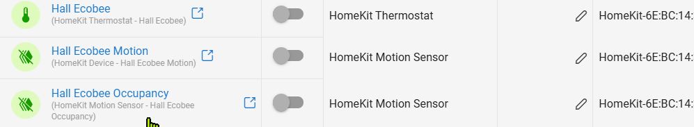

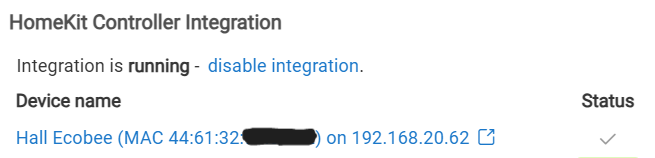

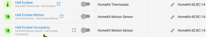

I follwed the same steps you did...looks like this in the HomeKit Controller app after successful pairing:
25-07-11-3536
In Device list:
I don't understand where you are seeing this...can you add a screen cap and description?

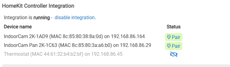

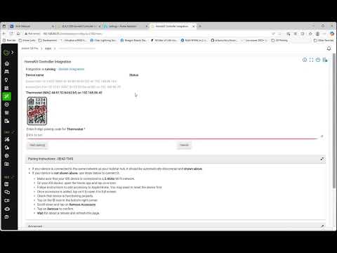

Here is a screen shot of it below. From what I can tell that icon should appear only when your device is paired to another HomeKit Controller. Unfortunately in my case it seems to go there right after being successfully paired to the Hubitat.
Here is a short video of what i am talking about. The video starts after i have clicked on the option to pair the thermostate. To get that option i had to go into the ecobee menus and disconnect since it thought it was already paird. Once i did that the option to pair appeared again.
I think that means it thinks it's already paired or something.

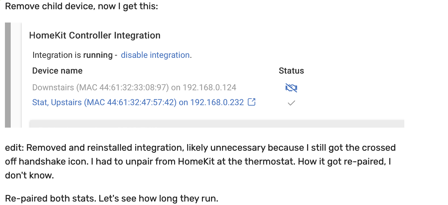

Here's a clip from the thread I noted above (I got the nixed handshake icon as well):
I totally agree that is the meaning of that icon.
The issue is that it presents that icon while doing the pairing as shown in the clip. You can't get into the pairing screen as shown in the clip without already being unpaired. That icon appears in the middle of the pairing process.
From this state the only way to get it to allow me to pair it again is to disconnect it from Homekit from the Ecobee itself. Once that is done the icon returns to the option to pair it again. I have done this many, many times.

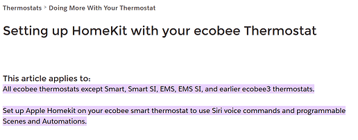

Per @aaiyar
And @ogiewon posted this info on Ecobee HomeKit support as well:
You should be good w/Ecobee 4... :man_shrugging:
Yea all that seems to indicate the Ecobee 4 even from late 2017 should be fine.
