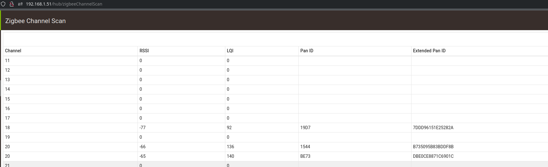

I woke up this morning to find my Zigbee in a funk....
I did a channel scan, and look what I found: one of my neighbours has put their zigbee on the same exact channel as mine (channel 20):
Sometimes my full channel scan works, and sometimes it doesn't....
I'm not sure under what circumstances it doesn't work, but many times it just doesn't show anything...
