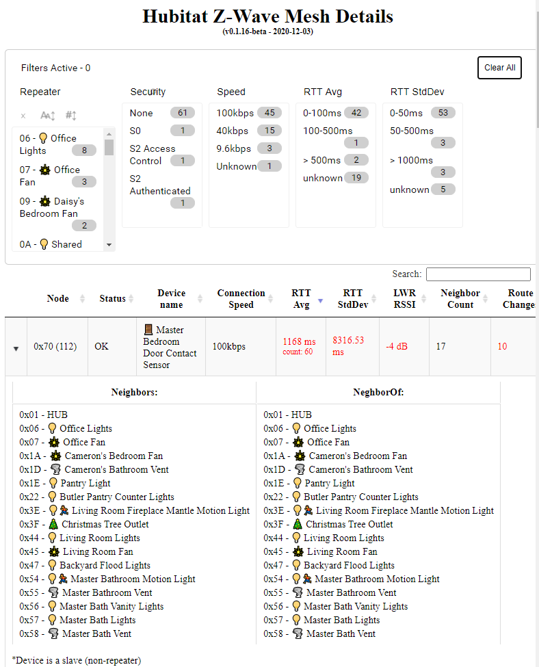

All devices have something in the clusters column correct?
It's just an enhanced version of the existing page. Makes it a little easier to filter and only runs when you click it.
Yes.

You haven't don a version report on any of your Ecolinks, have you. Mine said this:
Not familiar with the version report. Where do you find that?
