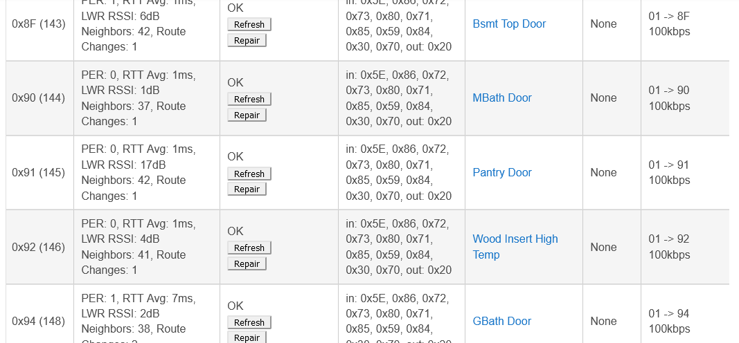

Here are some z-wave details on the four Ecolink door sensors.

You have the community app Hubitat Z-Wave Mesh Details installed? Anything look out of the ordinary?
