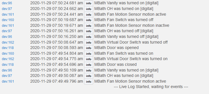

Interestingly, the log doesn't reflect an 8 second delay:
Also interestingly, the basement logs DO show a 9 second delay:
The delay is not shown on closing but is on opening!
(door close and open trips lights and fan)
Sounds like a device on the route may be going to sleep and needs to wakeup before repeating, or that a new route is being discovered and then at some point becomes invalid.
