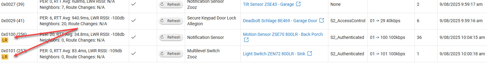

I had similar problems on JS, and what resolved adds for me, was the shutdown, power off, and reboot.. - Had that coordinated with the devices already added in Mesh mode (non-LR), then added to your SmartStart application, then deleted devices from mesh.. So the final sequenced that resolved LR bootstrapping errors (for me) was:
  1. Add device to Mesh (no LR)
  2. Add device to SmartStart App (and backup)
  3. Shutdown, power off 30 secs, power on.
  4. Let hub settle, verify SmartStart setup still pending
  5. Delete devices from Mesh.
Then they "automagically" added to LR. - So it seems the "delete" does something, more that just a regular LR add.. None of that makes much sense to me -
But it is repeatable on JS (with FW 7.18), so sort of a mystery, but at least I was able to a few LR sensors/remote scene controllers back. I'm almost afraid to go back to ZIP at this point, but I likely should try that.

Correct - Normal "non-smartstart" inclusion to the mesh,,
No - The endpoint device remains powered the entire time - But since it's already included in the mesh, from step one, Step 2 doesn't really do anything (other than set it up in Jeff's app), and the device will be shown as pending in the SmartStart app. And still a member of the "old school" Zwave mesh, so it will not join anything else (LR or some other Zwave mesh)
When you get to step 5, excluding it (Hub: ZWave->Exclude; then Device: 3 down taps for a Zooz) from the "regular mesh" then device realizes that it's "free" to rejoin, And the LR stuff is all prepared on the hub (from step 2), and it joins as a LR device. - Clearly the back to back "mesh exclude" and LR join on the hub, is slightly different from a endpoint power up LR join - makes little sense..
Again, I don't really understand why (it seems to be hub related, and not device related), and this was pointed out to me, in another thread - I just added the hub shutdown/power off/power on in step 3 to clear the Zwave radios (and perhaps put the mesh into a state without a controller). - The trick is just not "adding" as part of a power on, rather it being on a regular mesh, then exlcuding, and it gets picked up for LR at that point...
Clearly, YMMV but that has been actually repeatable for me... - Strange, I know.
