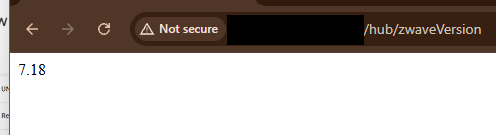

When switching to ZwaveJS, should there be an option to update the Zwave Firmware? In several threads that I have read related to switching to ZwaveJS, the posts mention updating to the 7.22 firmware after the switch. My hub is currently on version 7.18 (found via /hub/zwaveVersion) and I am not seeing an upgrade option. I have performed several restarts after the change to ZwaveJS and have also shutdown and pulled the power for 30+ seconds.

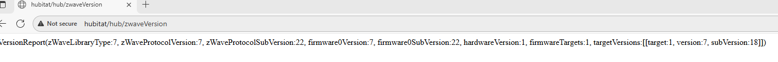

are you looking at the last "subversion"? I think you need look where is says firmware0SubVersion:22:
VersionReport(zWaveLibraryType:7, zWaveProtocolVersion:7, zWaveProtocolSubVersion:22, firmware0Version:7, firmware0SubVersion:22, hardwareVersion:1, firmwareTargets:1, targetVersions:[[target:1, version:7, subVersion:18]])
I'm getting the ZWave version from here. Where did you pull the VersionReport string you are showing?

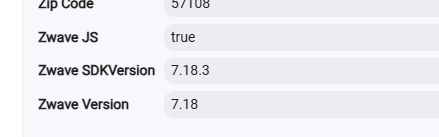

From the Hub Info device driver I see the following:

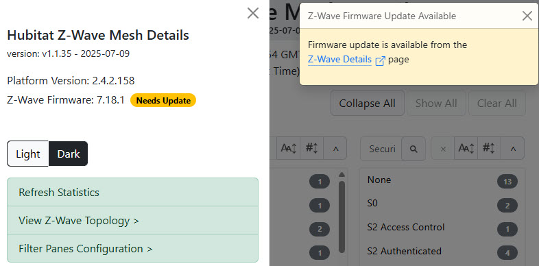

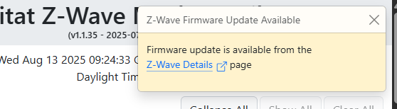

And from the Hub Z-Wave Mesh Details app it's notifying me that a firmware update is available, but when I go to the Zwave settings page the button is not present.
I'm getting from the same URL - but I am back on Z/IP gateway right now

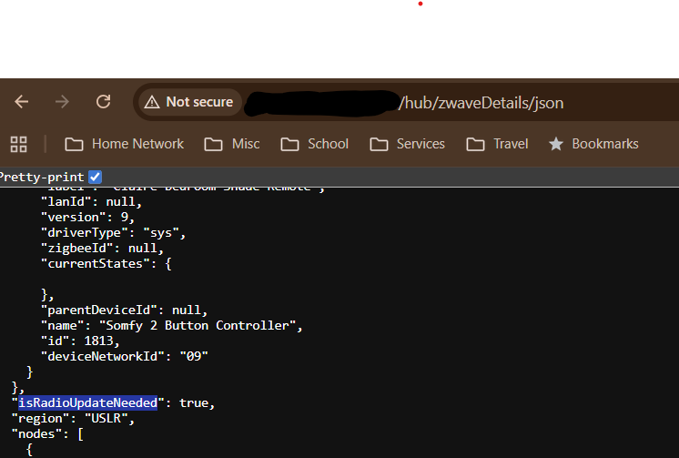

I went thru the Hubitat Zwave Mesh Details app to see where it was getting the info for the Firmware version update available popup. I found that it's hitting the /hub/zwaveDetails/json endpoint and querying the isRadioUpdateNeeded attribute which is showing true.
Still not sure if this is a UI bug or possibly something leftover from pulling the 7.22 firmware back.

Never switched to ZwaveJS, still running legacy. Recently bought 3 Zooz 800LR devices & tried installing by changing Region to "US-LR - 908.4 Mhz, 916 Mhz" & using jtp10181's SmartStart app. Ended up using SmartStart & got all 3 included with "SmartStart Boot Mode". Just noticed the Firmware Update popup in the Hubitat Zwave Mesh Details app & also wondering if I miss configured something or experiencing or UI bug.

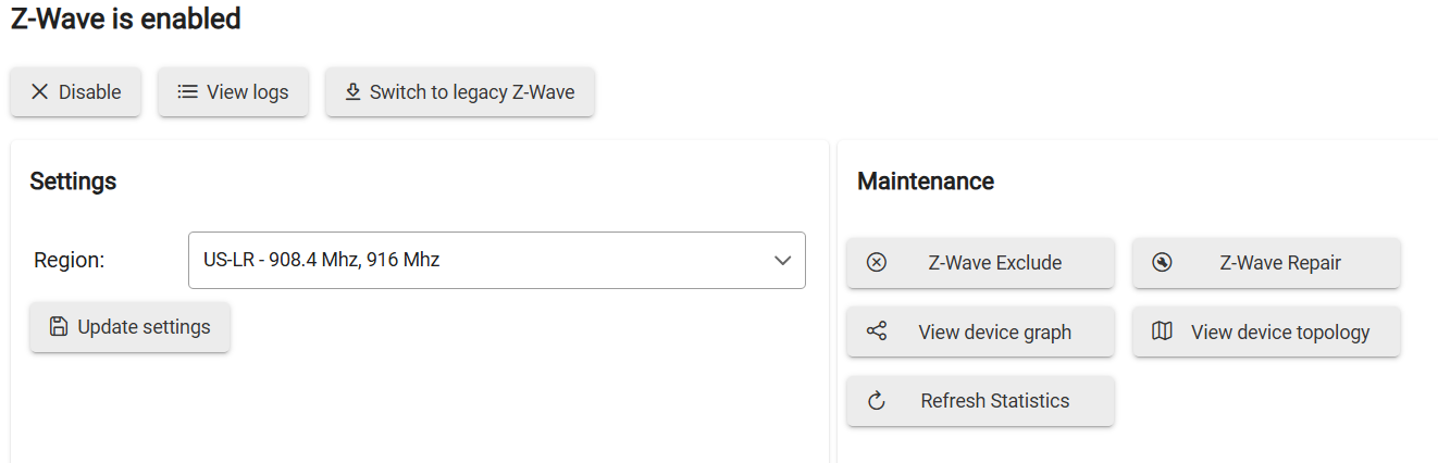

Since you said you changed the hub's Region to US, where are you located?
If you're in the US, then "US-LR - 908.4 Mhz, 916 Mhz" should've already been the default setting for 8-series hubs -- it covers both LR and mesh z-wave.
That firmware update note is unique to the (community-developed) ZW Mesh Details app -- as mjarends indicates in the post above yours, I suspect that's a leftover artifact back from from when 7.22 was available.

I'm located in Southern Indiana, my original region was "US-908.4 MHz, 916 MHz".
Right on... It's odd the LR setting wasn't already set, but stranger things, I guess!

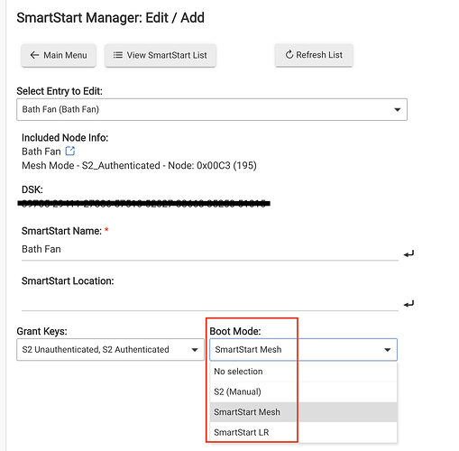

Now that you have the devices in Jeff's SS Manager app, have you tried editing one of them to Boot Mode = SmartStart LR? (then exlcude/re-include)?
That may be a shot in the dark, but perhaps worth a try...
Yes, was able to exclude it without creating any Ghosts, now when rescanning the QR code it defaults to LR but get the error below in system log. Have shutdown the hub, waited for over a minute & powered backup so many times I can't count .

Thanks for your responses Hydro! I'll just chalk the firmware update message in Zwave Mesh Details app as an anomaly & move on.
