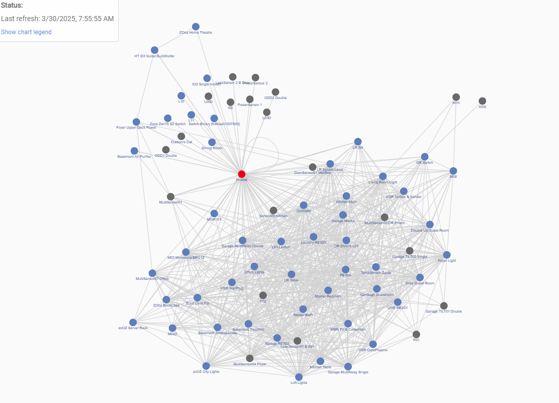

I have a Hubitat C8 running version 2.4.0.151. It has been on line for a year but in the last week it has developed a problem where overnight ZWave stops working. All the devices are listed but none of them respond. If go to the ZWave option, all the of the buttons are grayed out. If I reboot the hub everything returns to normal. I discovered the problem when I turned on the light switch to my office physically and it is supposed to turn on a dozen or so items in my office. I have reloaded that switch, I have performed ZWave repair twice as well.
I see nothing in the logs. Mesh below.

Also, pasting screen shots of your Z-Wave details will allow others to see RTT and error counters - That may help identify any ghosts or devices that are generating problematic statistics.

that bendy loop from and to you hub looks dodgy, could it be a ghost device?

Nice catch and it is still there now. Not sure how to track it with no label
The loop is harmless, possibly the hub is reporting itself as a neighbor. Happens with Zigbee too for some people.
