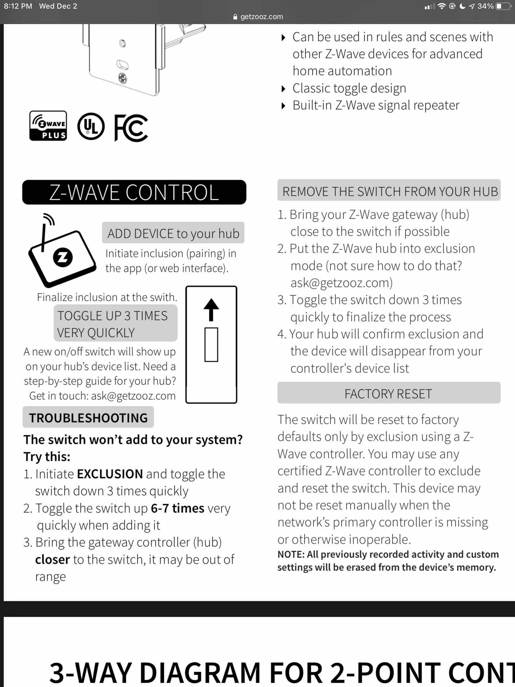

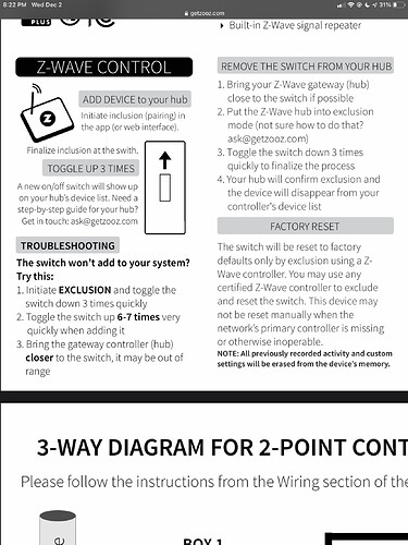

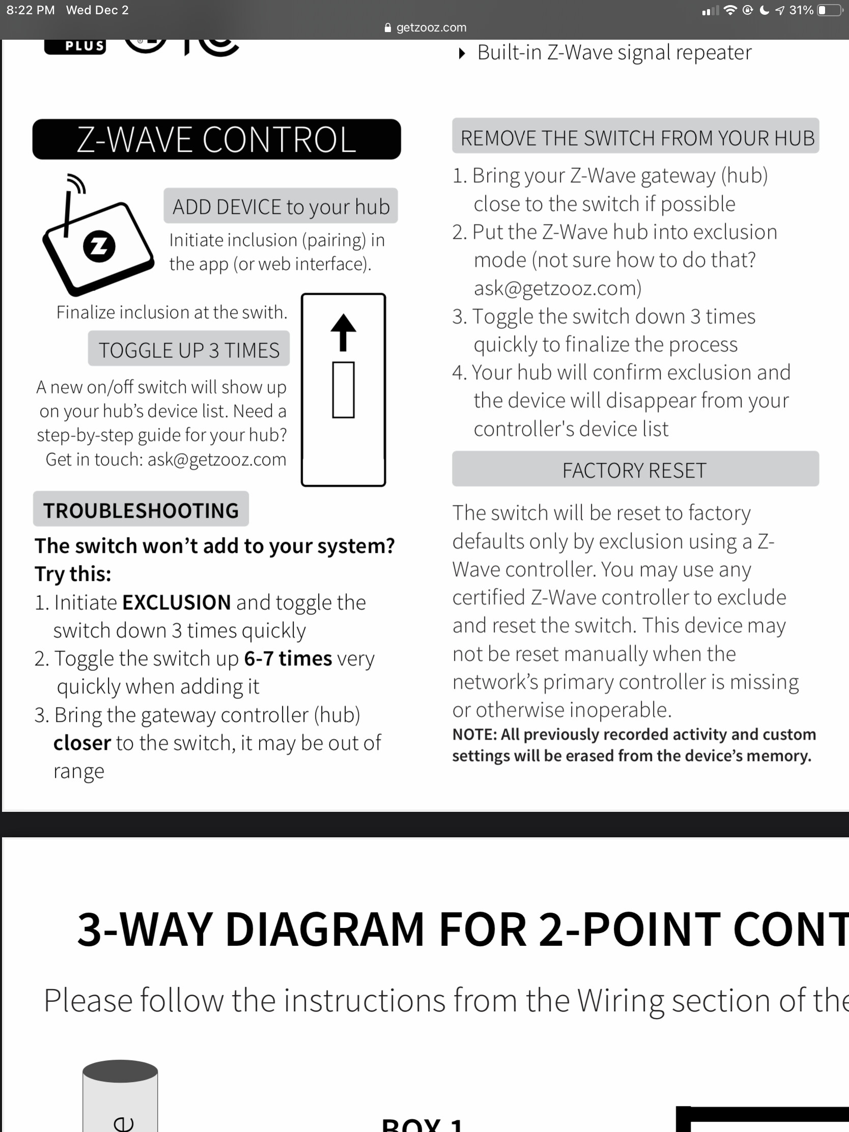

Edit: ok, here is the inclusion/exclusion/reset stuff for the ZEN23 toggle:
Looks like you are correct, it gets factory reset on every exclude, and that’s the only way to do it. Because of that, after you hard reset the hub, you still need to exclude the switch (which the hub has now forgotten). To do so: on Z-Wave Device Discovery page (Discover Devices in upper right menu), hit Z-Wave Exclusion, then do the Exclusion dance for the switch (“Remove device from your hub”). You should get a response “unknown device excluded”. That may have been the problem - the switches wouldn’t include because they thought they were already included.

Hey - Yeah, that's the documentation that comes with the devices. Excluding the switches is effectively a factory reset, and the dimmers you can triple-down and hold.
