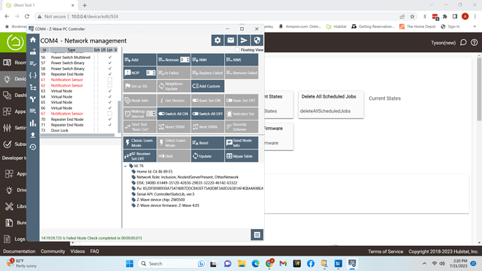

I did the exact procedure you indicated. I downloaded Silicon labs and Simplicity and followed all instructions. It took a while but did step by step. I had printed out the PDF file and did the removal.
I think I missed something on Com4 Network Management I clicked the ID one number. I guess I was supposed to go back and repeat the other 4 ID numbers.
I am at this point and directions say to click on IS FAILED but it is greyed out but IS failed has a check mark the ghost device turned red but REmove Failed is greyed out. I tried NOP but Is Failed is greyed out.
