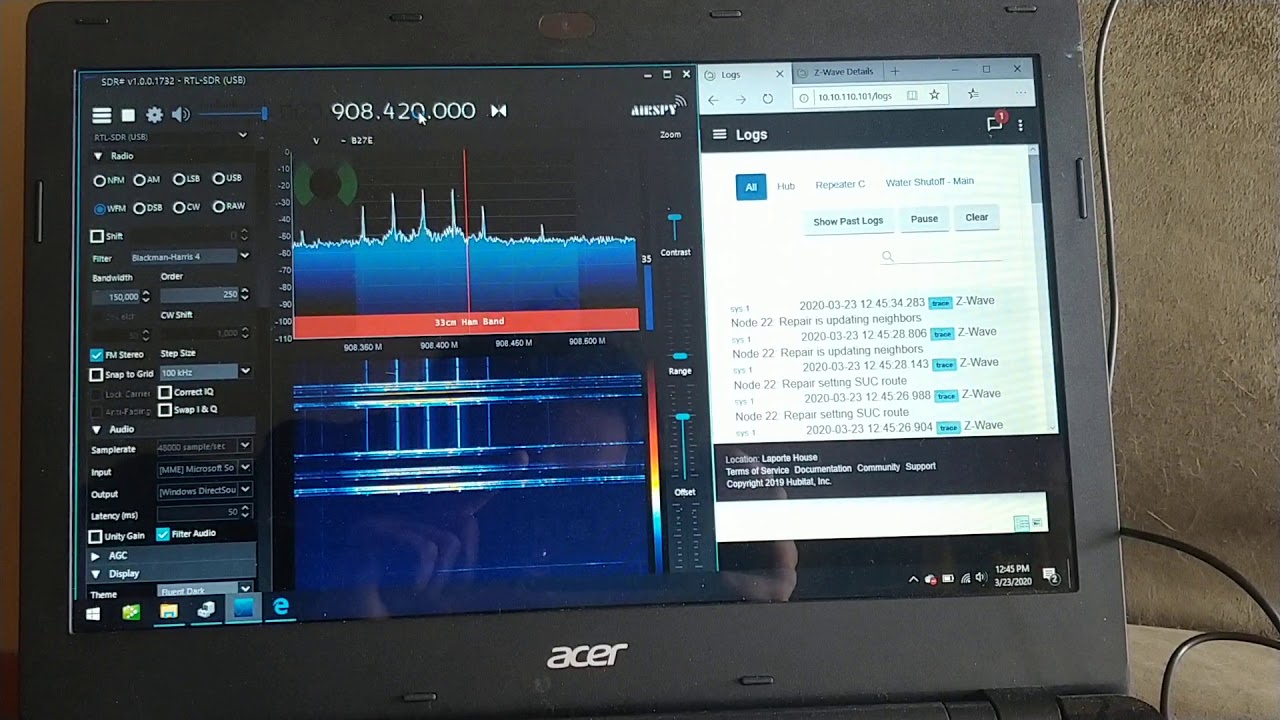

@bcopeland I have been doing wireless network engineering since 2001... I would put money on the solid carrier wave analog interference source..
Just for you ![]()
I managed to get my "spectrum analyzer" working on my laptop, showing no excitement on the 908.42MHz band (until I force a rebuild, which I made a video of it happening).
Note: In this video, I started recording when stuff started to happen (you can see the commands on the right). The last 5-ish seconds of video is what is happening 100% of the time if I turn off power to my ZWave devices (aka: no interference). I'd also note this spectrum analyzer is garbage, as is the antenna, but you can see the ZWave signal is dramatically higher than background noise.
The one thing I would note from your spectrum analyzer .. and I'm hoping it's because of some artificial amplification.. But if this is correct your noise floor is at ~-55dBm that's high..
It's only because the spectrum analyzer is garbage; paid like $10 for it off eBay, so it's SNR is abysmal.
If I pull out the antenna, meaning it is basically not getting any signal, it does not impact the noise floor. The only value the device really has in this scenario is to show that the ZWave signals are considerably higher than surrounding signals.
