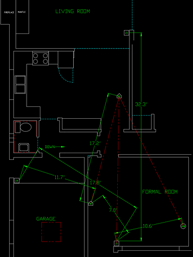

It appears nothing I own that is ZWave+ will pair away from the hub. I tried to pair an Iris repeater; no problem if it's in range of the hub. I tried pairing another one, but this one is about 20' from the Iris repeater with line of sight (Line of Sight to both the repeater, and the behaving Zooz switch), but is through 3 walls from the hub; will not pair.

Hopefully the image I've attached clarifies the "3 walls / Line of Sight" confusion; sorry about that.
After the iris repeater (R1) was paired, it has not moved. The second repeater is sitting on my kitchen table on an extension cord to ensure it has Line of Sight (not to the Hubitat hub, but the Zooz switch, and the iris repeater).
Legend:
Z1 (Functioning Zooz ZEN21 switch *using the recommended Zooz Central Scene Switch)
R1 ("Working" Iris 3210-L Repeater *Using shackrat's driver)
R2 (Iris Repeater that will not pair)
Z2 (Paired Zooz ZEN22 that cannot communicate *using the recommended Zooz Central Scene Dimmer driver)
Z3 (Paired Zooz ZEN22 that cannot communicate *using the recommended Zooz Central Scene Dimmer driver)
Hmmm, maybe view it on imgur: Imgur: The magic of the Internet
Nice drawing.. Where is the hub?
I see it now
Ok .. This drawing helps a lot .. These devices should be able to talk.. So now I'm going to have to ask about potential interference sources.. Do you have anything that operates in the 900Mhz range?.. Possible sources: cordless phones, baby monitors, some alarm systems, etc..
