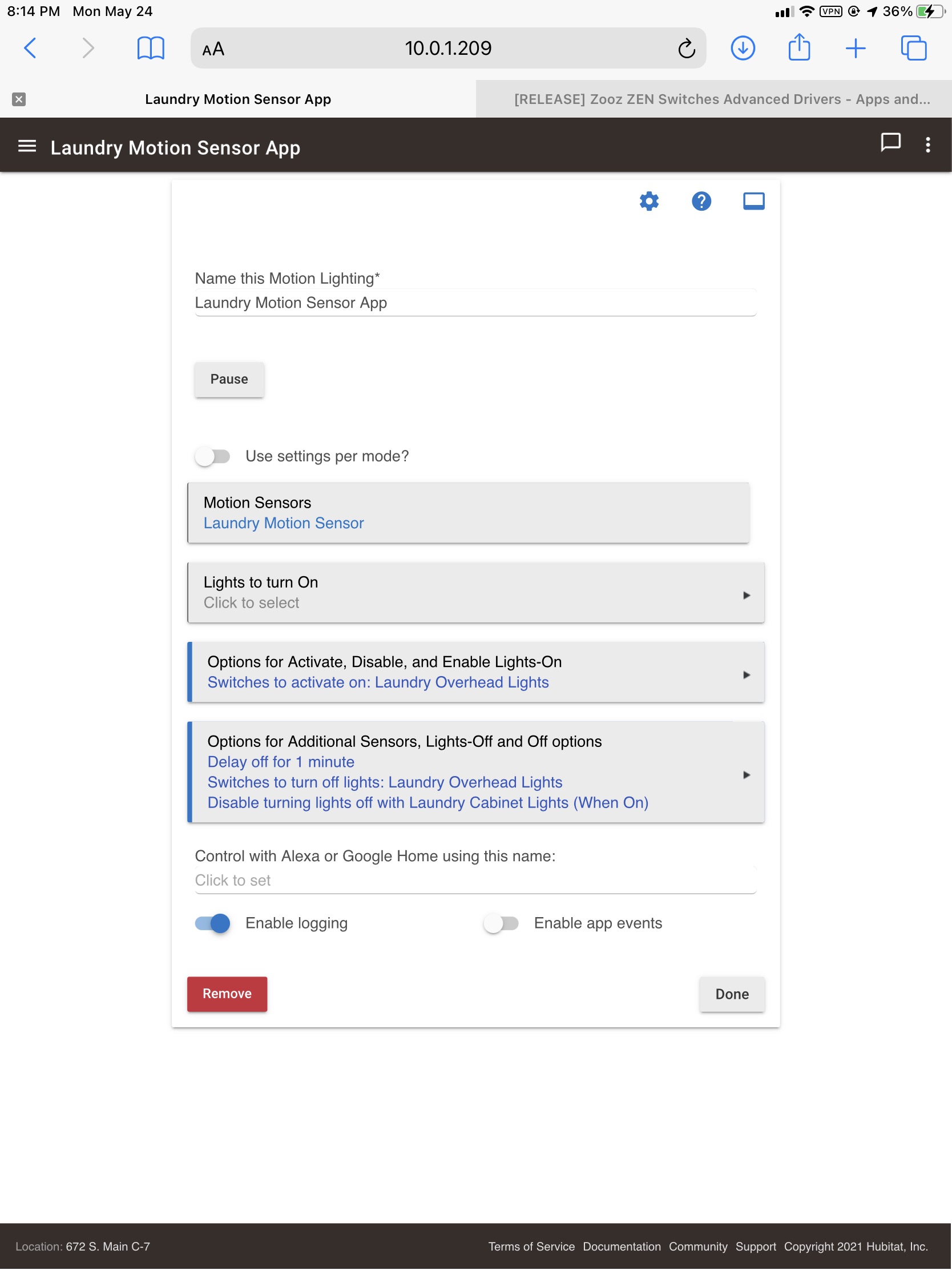

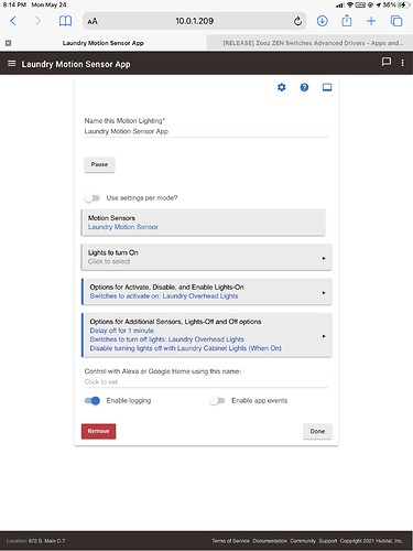

I then removed the Child switch from Motion Lighting’s “Lights to turn on” (the Occupancy mode was handling that), left the switch in “Lights to turn off” for MotionLighting.

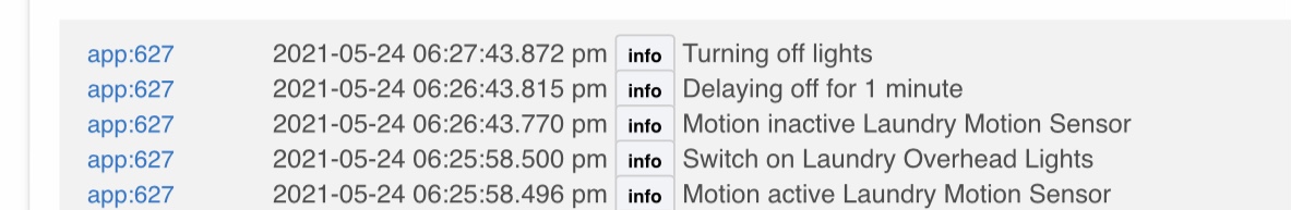

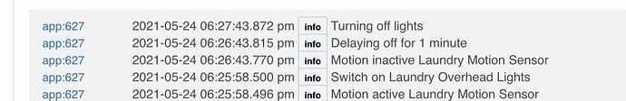

Motion Sensor correctly caused the switch to turn on, the device driver saw that, Dashboard state changed to on. However, the switch never turned off, even though the logs said it did in Motion Lighting.
I will test further after the driver is changed, and turn on logging in the driver.
However, the motion sensor turns the child on instantly, no latency whatsoever, when in Occupancy mode, and, according to the logs, Motion Lighting believes it turned the lights off.
Lights never turned off. Note that 1 minute elapsed before turn off. May be a Motion Lighting bug. Worked fine before in Manual mode when the switch was in Lights to turn On. Or, the switch may be ignoring hub commands when on Occupancy mode.
Screenshots of logs and Motion Lighting
Only change to Motion Lighting was to delete “Lights to Turn On (Was Laundry Overhead Lights)
The two component children are “Laundry Motion Sensor” and “”Laundry Overhead Lights”.

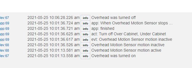

I tried enabling the basic rule to that turns off other lights when no motion is detected. Motion inactive was detected and the slave lights DID turn off at the delay specified in the rule.
log
