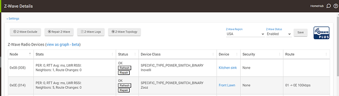

It is just hit and miss on working when I push buttons digitally, or has a delay in response (focused on those Zwave dimmers and the scenes they are a part of). I thought I would monitor [as recommended] for next few days tracking which areas are most problematic. If there are any guides on troubleshooting weak RSSI signals, questionable routes, I will read those.
This and dont do a full repair, just let it work itself out.
Using some of the devices may help as well but do not furiously push buttons if its not working quick.
I would like to see the full zwave page AND Topology map after 12-24 hours of the hub being restarted. This allows for the stats to build up and get a better picture.
One last thing, what types of materials is the home constructed from? Wood/Drywall, or something else? Also what type of boxes are the switches in? Metal or Plastic? I am asking this because your neighbor counts seem low for the number of devices you have, unless they are extremely spread out in a very large home.

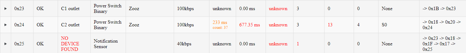

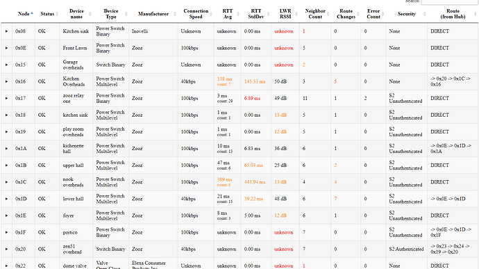

FWIW, here are the details again. 08,15, 22, and 25 are not online devices at this time. I ordered a stick to remove ghost 25 since I don't know what it was and can't remove it from zwave page. Still having delayed or non-responsive items this morning [eg. foyer, zen51 overhead, nook overhead).

C1 and C2 are ZooZ Zen15 outlets that supply and monitor two dehumidifiers.

Your C2 outlet seems to be the most problematic, it has a lot of hops and the most route changes. Also as mentioned it is paired with S0 which causes 3x the zwave traffic overhead.
08, 15, and 22 you said are offline? If possible I would bring them back online, your mesh could use more devices to be stronger. Are they plugs you could plug in somewhere? If so, I would try and position them so they are between your more problematic devices and the hub. Otherwise just power them up if possible. If you are not planning on using them anymore I would exclude / remove them to prevent any routing issues.
I did unpair/re-pair the Zooz plug [that was high in route changes and security 'Z0'.] Did this several times using the instructions for security pairing for device, but a no-go. It only loads Z0 even with a power cycle at the plug. But the dimmers seem to be better with the plug out of the mesh it was in, for the moment; I just haven't placed it physically back where it is supposed to be used. I will look at adding devices soon (from other hub, etc) since it seems that there is a population factor to the zwave mesh quality.
