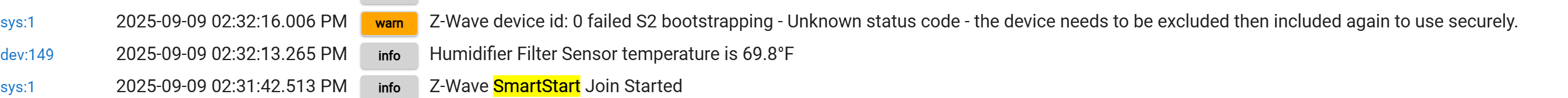

SmartStart Manager - I've used this to add several device successfully. This is all I ever get with this device. It's almost like the device stops trying before the process is finished.
I've excluded it every try.

This appears to be the SS bootstrapping issue described in this thread - it may be worth a read...
Corrected thread link:
Ugh, I just realized that thread is tagged as Beta -- moderators, any thoughts on possibly freeing up that Bootstrapping thread now? We're well clear of that particular beta...
Another ugh... now just realized that thread was spilt off into a non-Beta version... Editing my post here accordingly now... Moderators, my apologies for the false alarm.
I was just going to post that other thread you found.
I skimmed through it, and it is relatively confusing.
TLDR: Typically you have to reset the z-wave radio and rebuild everything to fix the constant bootstrapping error when pairing LR devices.
However, someone just recently has found a trick that is working for them, may work for
others.
After Step 5 exclude, since you already have it sitting in SmartStart in LR mode the device will immediately try to pair as LR. It will either get the bootstrapping error still, or maybe it will work...?

Fingers crossed... - To add some context, I was doing this under ZWaveJS running SiLabs Zwave Radio FW ver 7.18. - I have no idea if that matters or not, or if there is a specific combination of versions that need to be inplace for this to work.. But I can believe ZIP versus JS could make a difference.
The reason any of this works is both unclear and surprising to me.

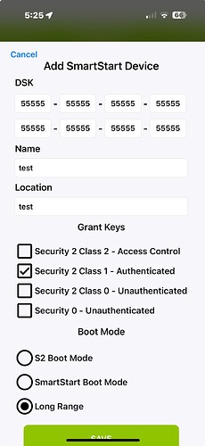

Why can't I hit "save" in the Hubitat app on my iPhone for adding an LR device? Is this feature actually non-functional?
You should be able to add an LR device to SmartStart in the 2.0 mobile app using the QR code, or I think optionally by manually typing in the entire DSK. Highly recommended to use the QR code to add it in, which also sets a bunch of defaults from the QR code. Then use my SmartStart manager app just to manage the list.
For your Save issue, you would need to provide more detailed steps on what you are trying to do exactly, or a screenshot (or both would be best).
So the scan was my fault. Sigh...it was for the device but not the QR code to add.

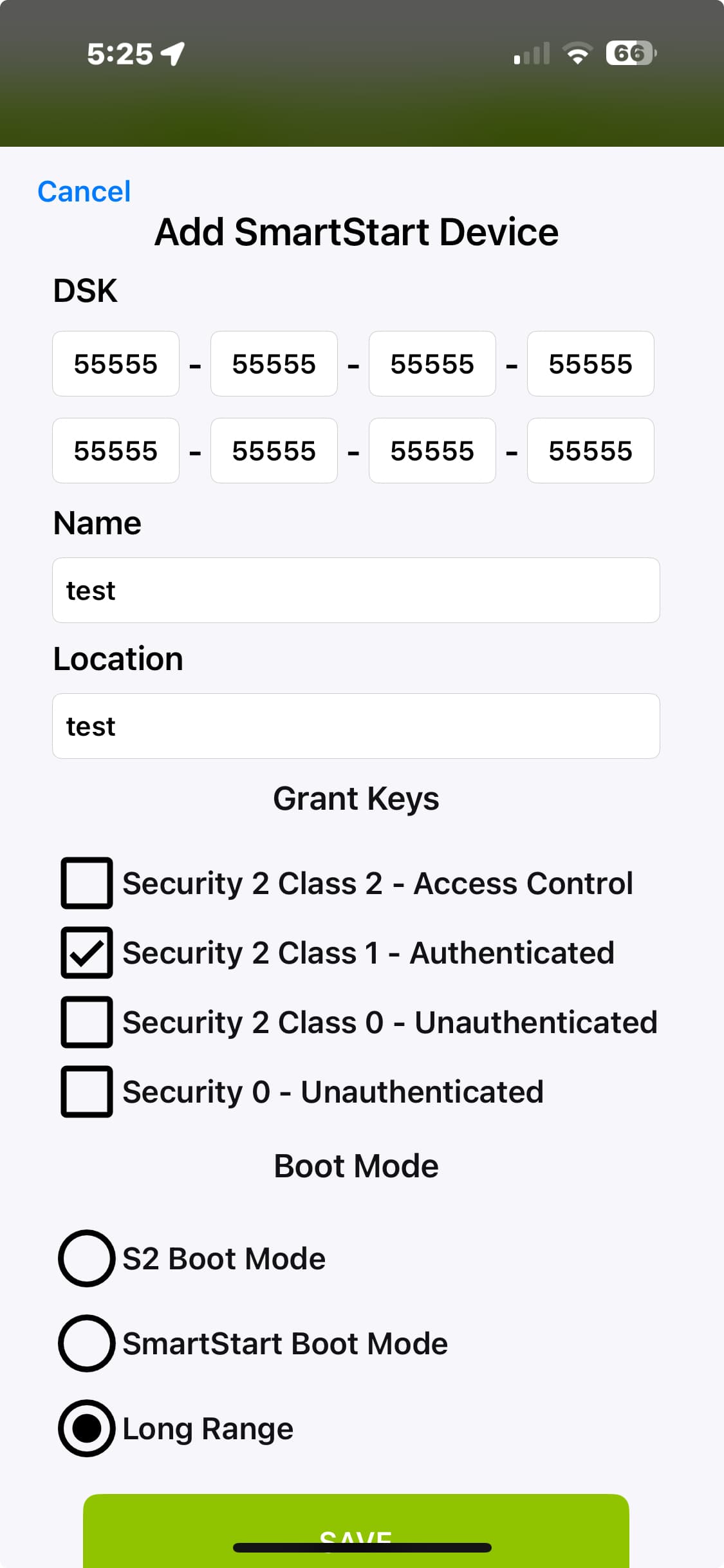

The Smartstart APP issue is repeatable. iPhone 16 Pro latest OS and App. It's actually really hard just to select LR as well....but save is impossible.
I tried changing font sizes on the phone etc...nothing helped. Obviously, I made up the DSK...but a real one changes nothing.
That part of the screen seems to be reserved for the phone. Just need to move that button.
I can replicate that on my iPhone 13 mini too (using latest prod-release iOS HE app).
