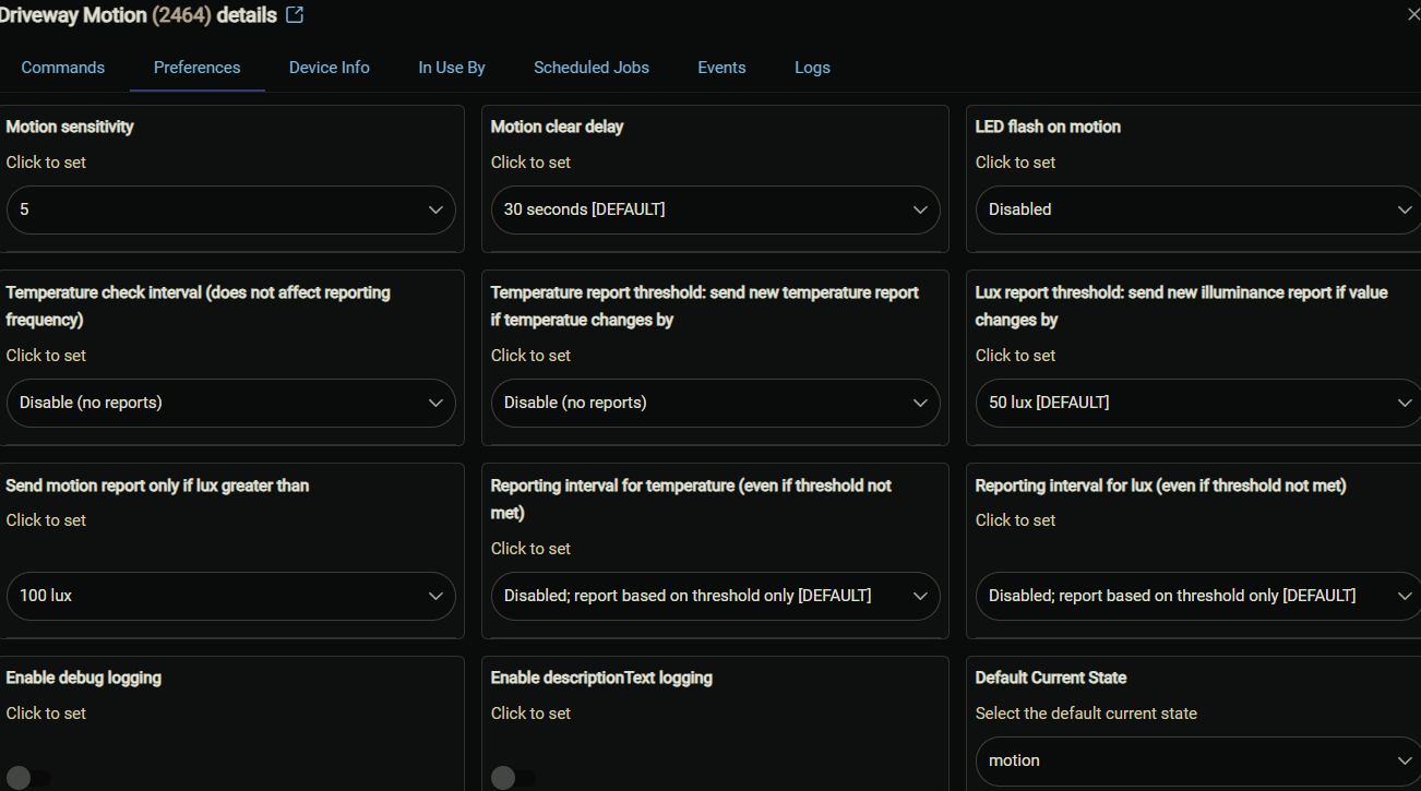

I don't want any other reporting just to keep the battery life but these settings seem to have killed all lux reporting, I always have 0 now.
Fresh eyes on a setting mistake? ![]()
Edit: I have switched to @jtp10181 driver to test.
