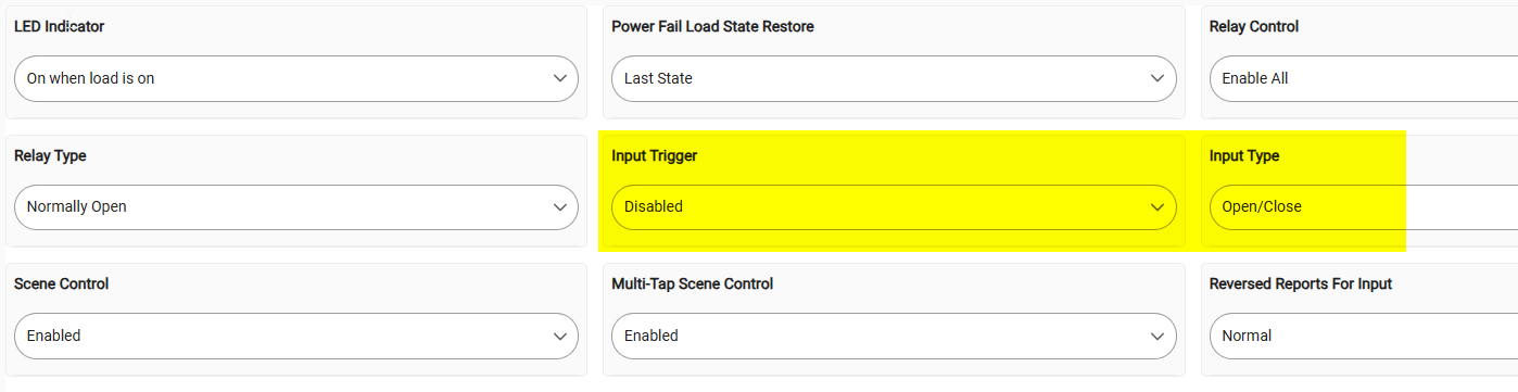

Here are the settings to disconnect the input from the relay, that IS working. But I dont get any events for the open/close sensor.

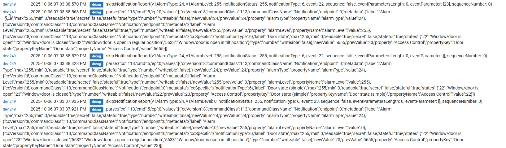

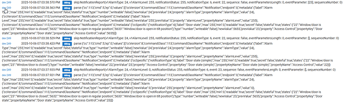

This is open/close reports with Zwave JS, I need to switch back to ZIP but I dont think it will help. You can see the driver is skipping them over, it says "skip".
I could see the input in the logs when switched in legacy.zip mode

I have it setup where the input does not trigger the relay
and the input does trigger on/off state
I can turn on/off the relay and it also sets the state to on or off,
the issue is this on/off state is shared between the input and the relay.
