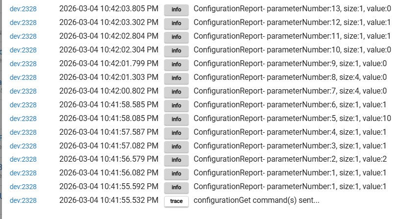

This is a Zen58. Here are my parameters:
No child device hiding there, and pressing Configure does not create one.
The only thing I can think of, is that the value 10 (dry contact) is different than the rest, since it uses the switch command class it actually sends it on another endpoint. Very annoying for making a custom driver in a platform like this. I just made that setting not available in SmartThings so I didn't have to deal with it. I always test with the contact sensor option.
Other than that @bcopeland or @bertabcd1234 would need to take a look at it.
