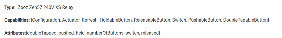

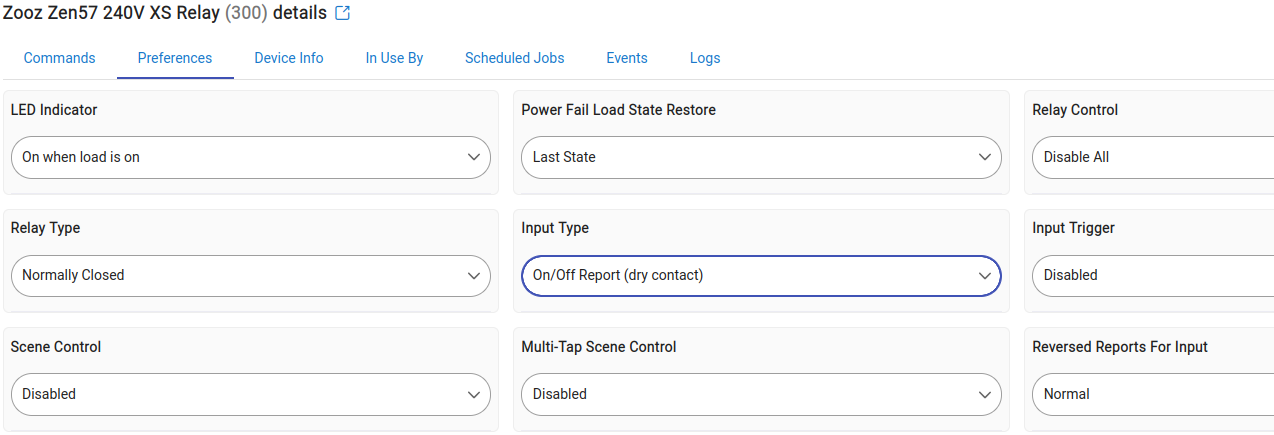

This on my C8-Pro with Zwave JS, the device is joined using SmartStart and is in Long Range mode.
On/Off report (dry contact) -- and the other settings as below:
Interestingly even after changing these settings, and mashing the config button, nothing really changed in the behavior -- the contact is NC, so to test, I removed one lead from the connection, expecting the device to report "open" or "off". However, I got "button 1 pressed", and "button 1 held" events.
Upon re-reading the Zooz FAQ page on this device, I saw that it required a remove and rejoin from the network after those settings were changed -- so I excluded and rejoined it.

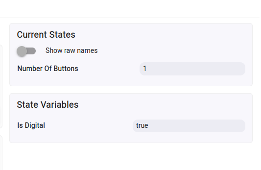

At that point, the state information changed to:
Yet, what should have happened (according to the FAQ), is that a switch device tied to the contact should have been created as a child, to show the state of the contact.
No child devices were created.
I think the device is configured correctly, and that is should be reading the state of the contact, but without the child device (as you noted) it has no way to report the changes.

So -- the device seems to be working as designed -- but without a child or other way to read t he state...
Seems like I need to be patient! :slight_smile:
Scott
Thats what I figured it would be. Seems like driver was just made quick and not tested for functionality. Its going to be at least a few weeks before I can even think about starting on this.
All good sir! At least we know that it works, and can be used as a dry contact monitor.
Thanks for assisting me in checking this out.
Scott

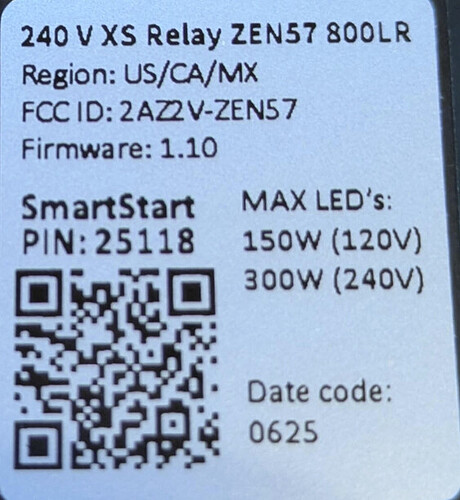

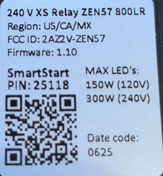

Hello.
I just got my Zen57, but it says on the box "240V", not "120V".
Here is the picture:
Even though it's 240v instead of 120v, can I use this in North America?
I want to use it to control a chandelier.
Yes. Instructions say power supply is 100-240 V 50/60 Hz

I got the Zen58 inputs to work for the "Dry Contact Sensor" needs
But I cannot get the relay to be FULLY independent by itself, I can disable the input from controlling but the relay itself cannot be controlled like a separate device.
What Am I missing?
I use a 58 for my garage door activator. Not using the inputs just z-wave. Works. What are you trying to do that is not working?
Dont use the dry contact sensor option, some really screwy stuff goes on when you use that option I found out. Ended up just not including it in the SmartThings driver I made for Zooz. Try doing it as just a "Contact Sensor" or "Open Close Sensor"
I have it working as far as my input sensing needs.
I was hoping to use the relay independently, However if I turn on or off the relay that also triggers the input which then triggers the rule I have running based on input state.
The relay would have to be controlled like a "Child Device" with a different name to allow what I want most likely?
No big deal as it works for the main purpose it was purchased for.....
Just would of been nice to utilize the relay fully independent of input :smiley:
