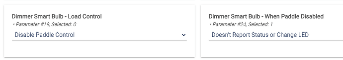

If you have the settings like this:
Then the switch state will not reflect the load state, if you click the paddle down the switch will report off but the load stays where ever it was (hopefully on).

You could also disable only the paddle control, allowing z-wave commands to work:
This is how the settings have been the whole time? Should I not have had them like this previously?
