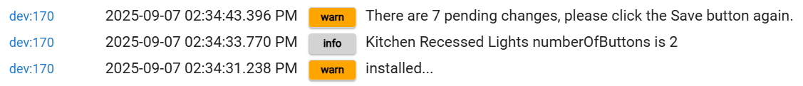

In the logs, I see this now...
Not sure what the 7 changes are...

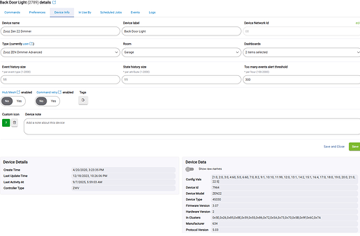

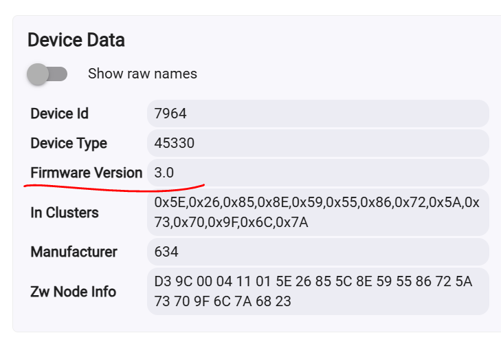

They are also asking what firmware this switch is. When I used SmartThings I could tell them. I don't know where to find that in Hubitat...
That is odd that it would change behavior from when it was not using a hub. But as long as it is fixed I guess...

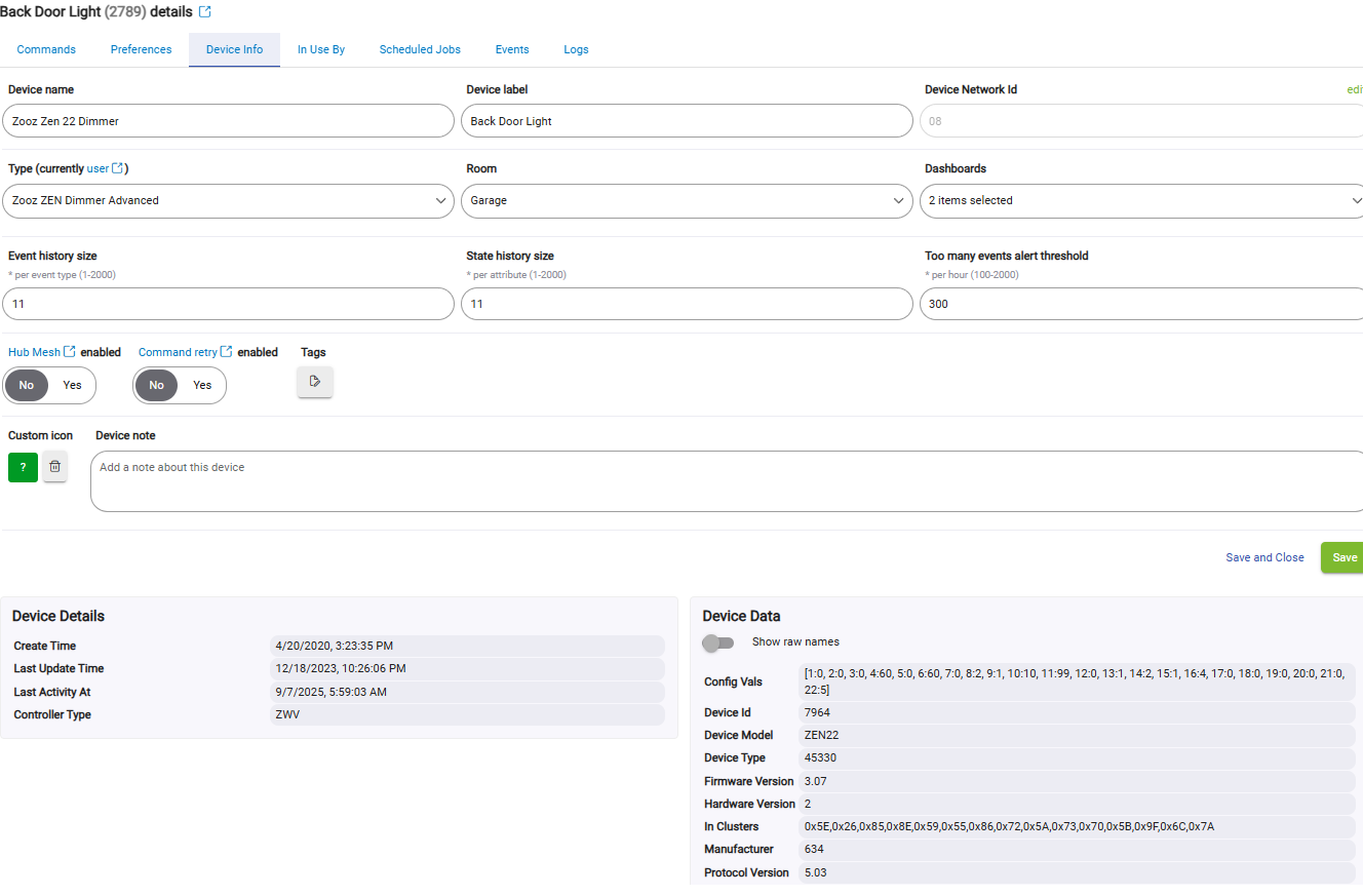

From the device settings, go to the Device Info tab. Then look in the bottom corner under Device Data. I am using a community driver here, but I think the stock driver should expose this as well.
It was not there using generic Driver. It is there using Scene Controller...
Zooz ZEN Dimmer Advanced

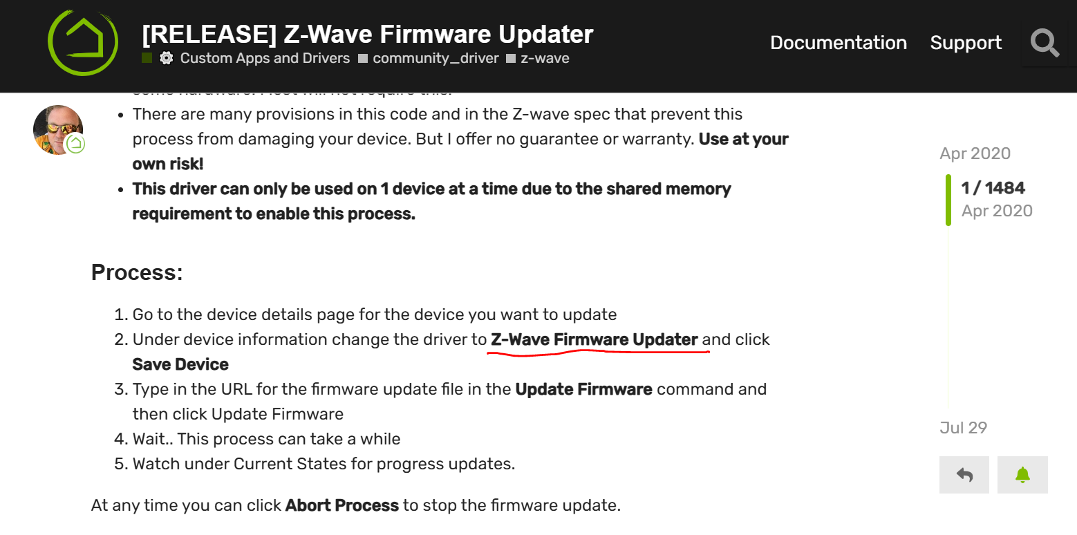

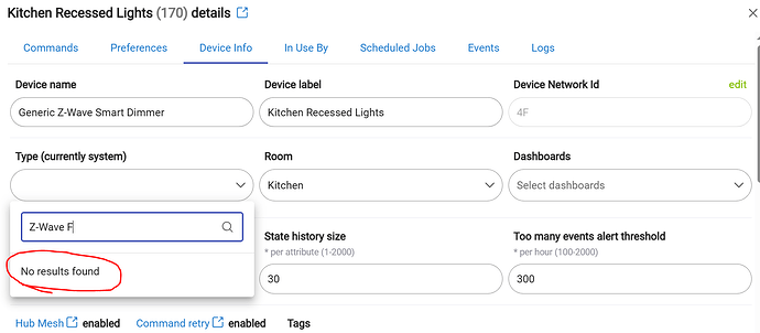

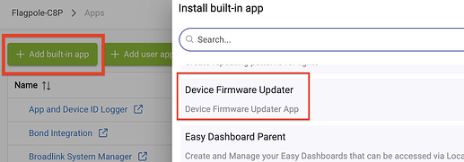

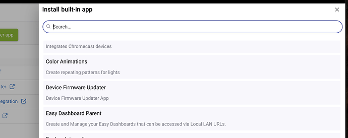

@bcopeland ZOOZ sent an email today suggesting a firmware update using your tool. I don't see Z-Wave Firmware Updater in the drop down. Is this not available on a C8-Pro?

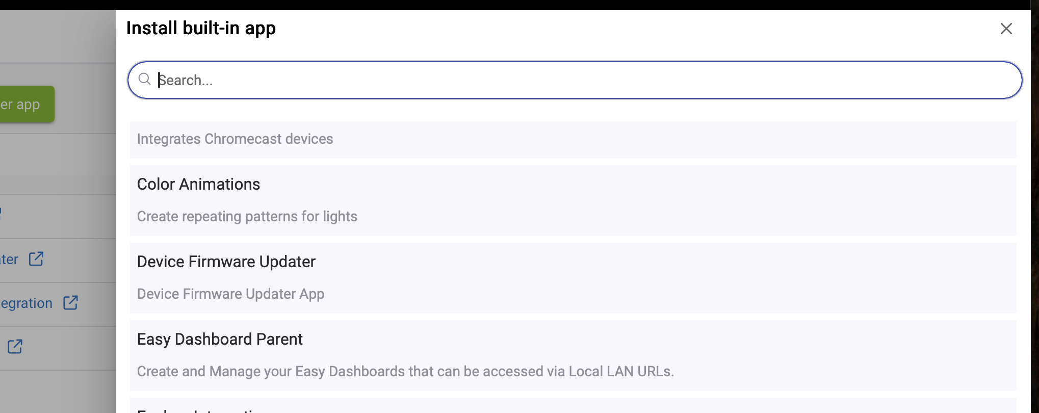

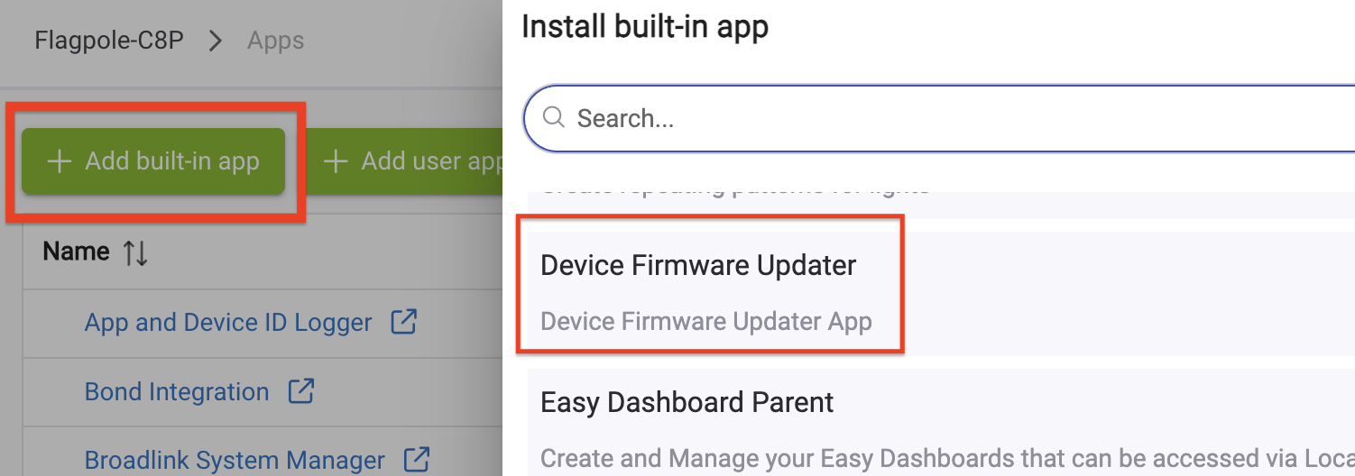

Maybe something's changed, but there's a built-in app for that:
Those directions are for an old updater path that's no longer applicable.

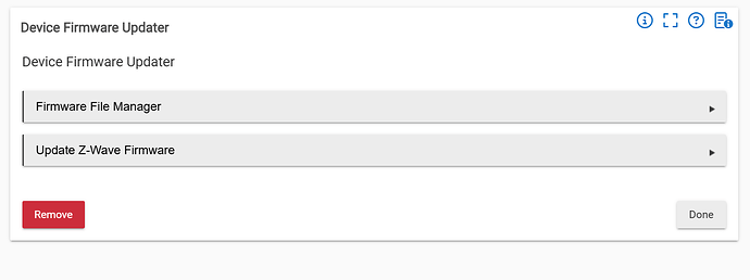

The z-wave Device Firmware Updater tool is available to add as a built-in app.
If you're on legacy ZIP and all devices paired mesh, the updater tool should work fine.
