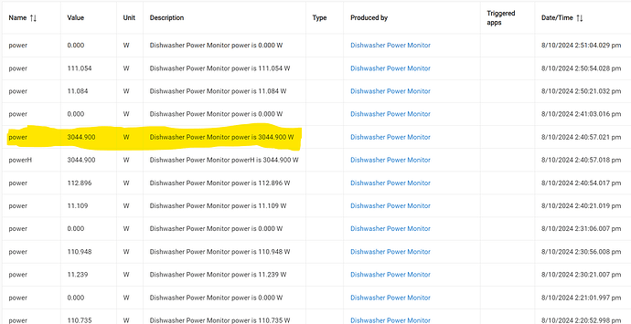

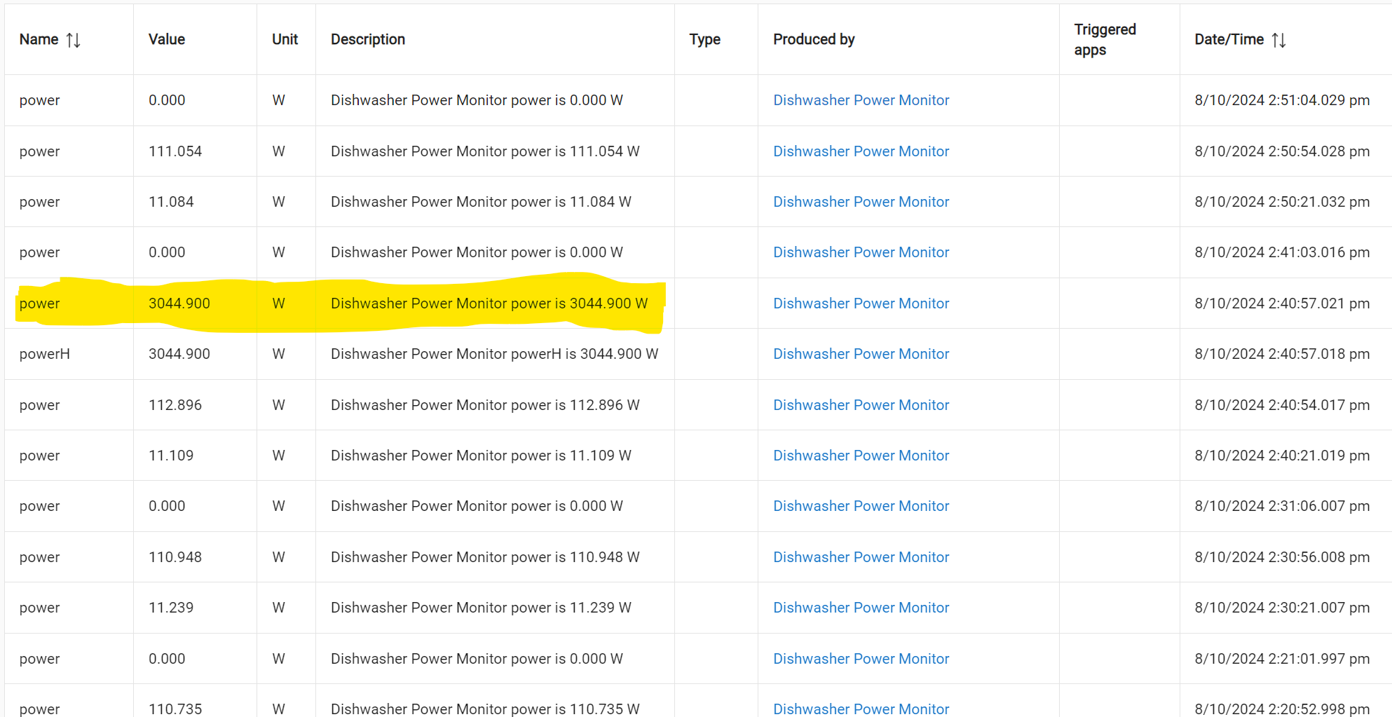

A different ZEN15 (also Model ZEN15 VER. 2.0) with firmware 1.6 exhibits the same behavior. Only this time it reported power consumption of 3044 W/25 amps (!!!) before it cut off. I don't doubt it saw a very, very short inrush current of that, but the other ZEN15s I have don't have any issues with inrush current on dehumidifiers, radon fans, sump pump, etc.
I notice that the 3044W reading wasn't what caused the switch to turn off as it reported other non-zero reading 10 minutes later. And I should say I am just assuming that the switch turned off because of overload protection. The LED was reddish .. was it reddish orange? Maybe. But it wasn't flashing. So it seems to me it was just off. But I was fixated on the overload theory since the switch could not be commanded back on remote despite many attempts.

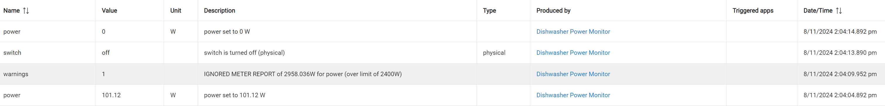

I repro'ed this problem with some more verbose logging (and a different driver). I also disabled both digital and physical off commands to rule out everything but the case where the ZEN15 turns itself off. The logs seem to confirm that a spurious (?) high reading is why the plug cut off and the LED was red.

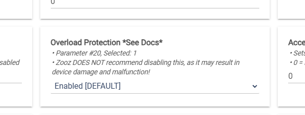

I have disabled overload protection and that appears to fix the problem. Before anyone starts saying that might be dangerous, keep in mind the actual max load is 12A, and the circuit is protected by a brand new 15A breaker. Having the ZEN15 in place with overload off can't possibly be any different than removing the ZEN15 and plugging the dishwasher directly into the outlet.

It looks like this may be a higher than usual inrush current displayed and tripping overload protection. If a ZEN15 that you're using on some of the other devices you mentioned (like sump pump, fans, etc) behave the same way here, then it's likely that the appliance is actually producing this spike. If the device is connected to an appliance that will often go over its rated limit, it may damage it over time so I would not recommend turning off the overload protection even if that means you'd need to find an alternative power plug for this particular appliance.

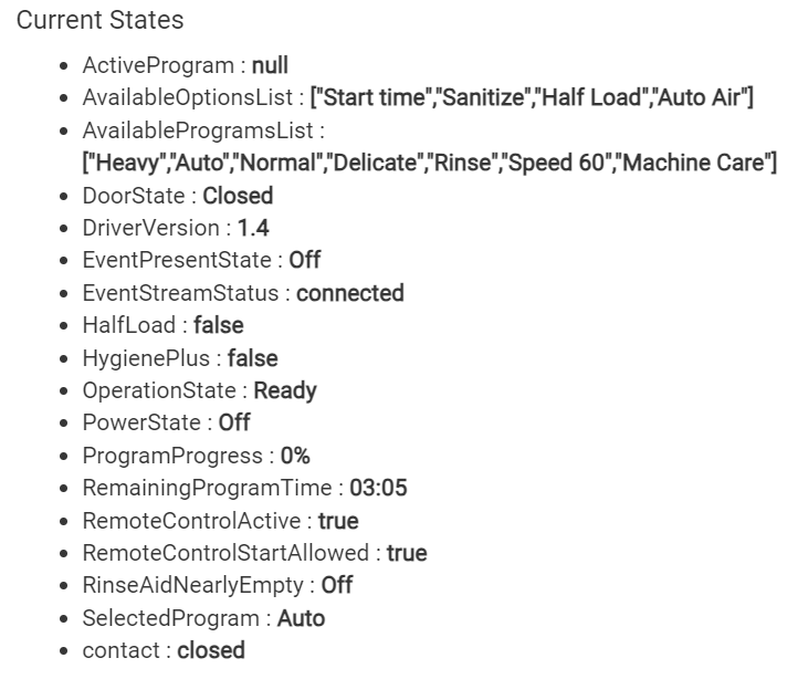

Yeah, I was actually doing some experimenting to give me supplemental information about the dishwasher's progress. I'm already using the HomeConnect API that allows me to start it, know when the rinse aid is nearly out, and when it is running. Unfortunately, it doesn't tell me cycles. This model opens the front door when complete, but as a "safety" measure, waits an hour after the dishes are done before it opens the door. I wanted to watch for a sustained period of near zero power to tell me the dishes were done and I could open the door my own self. But there's another way of achieving this so I won't be too sad I can't use the power monitor solution.

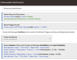

I use a Z15 on my Bosch d/w too, but my rule is admittedly pretty crude.
After instaling the Z15, I watched the logs for a couple cycles, and I came up my rule below... For the Z15 itself, I then set it so 1000W is its only power reporting threshold.
The "done" alert is always within a few minutes of the actual stop (sometimes before, sometimes after), and that's totally good enough for us.
My main goal was to prevent the Z15 from flooding the logs with incidental power reports during a cycle.
I started using this rule with a 700 Z15, and now using a 800 Z15. 800 is not paired LR, but both Z15s used S2.

If your Bosch support HomeConnect, you might want to look at it. It doesn't tell you as much as you might want (like what cycle it is on), but does tell you remaining time which is what you are calculating.

Interesting. I just noticed that with the ZEN15 800LR with firmware 2.1, you can no longer turn off overload. You can "adjust" it but the only thing you can do is make it more likely to trip, not less.
