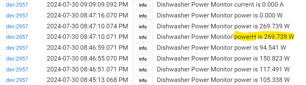

Using same on a new Bosch dishwasher, and it consistently cuts off power to the load early into the cycle. The LED is solid orange. Last event recorded was a new high power reading, but it is only 269 watts. The dishwasher pulls max of 12A and never trips a 15A breaker. Bosch dishwashers don't have a heating element to dry dishes, but does heat the water. So I'm surprised ZEN15 is seeing something it doesn't like.

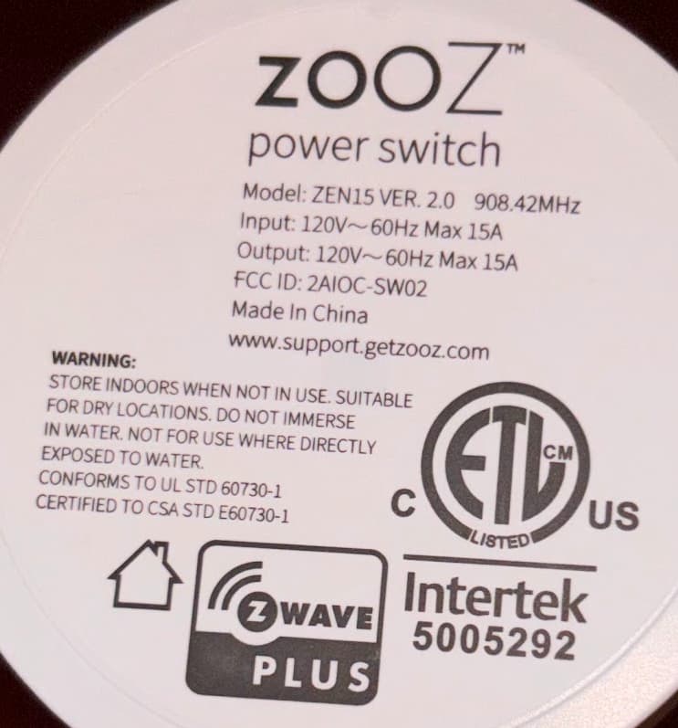

It's an older version 2.

Edit: @HAL9000, above you mentioned v2 generation of the product. Just to clarify, I was referring to the firmware version once joined to HE. Not sure those are one and the same.
I think the firmware pertaining to that bug I also refered to is only for the Zwave 800 LR models of the ZEN15, but I could be wrong.
Are you using it as a LR device? I heard there's no way to upgrade LR firmware, officially, in Hubitat.
The posted photo is of a non LR device

The powerH was 269.739 watts just before it turned off. Yes, there could be a surge higher than that before it could be reported, but the ZEN15 is built to handle momentary surges that you'd get from appliances, so I doubt this is actually an overload condition.
