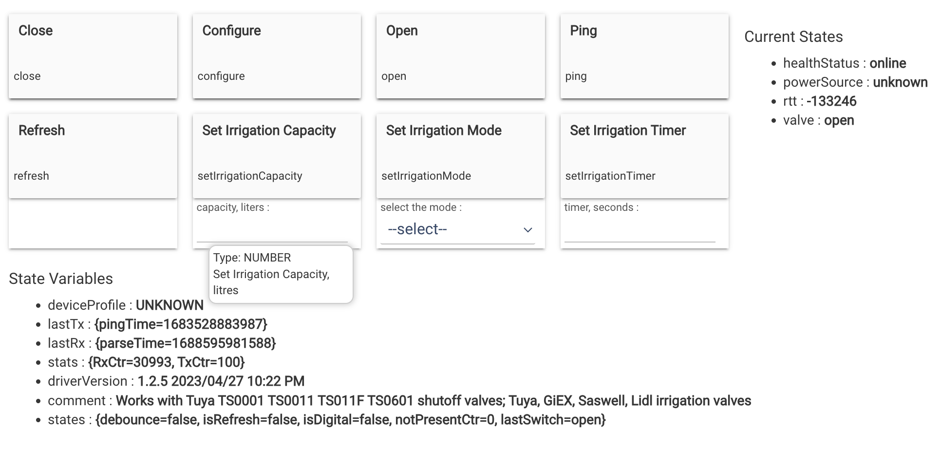

@Bruce123 - in addition to the information @kkossev requested, could you also indicate the driver your valve is using? A screenshot of the data section from the device page would also be useful.

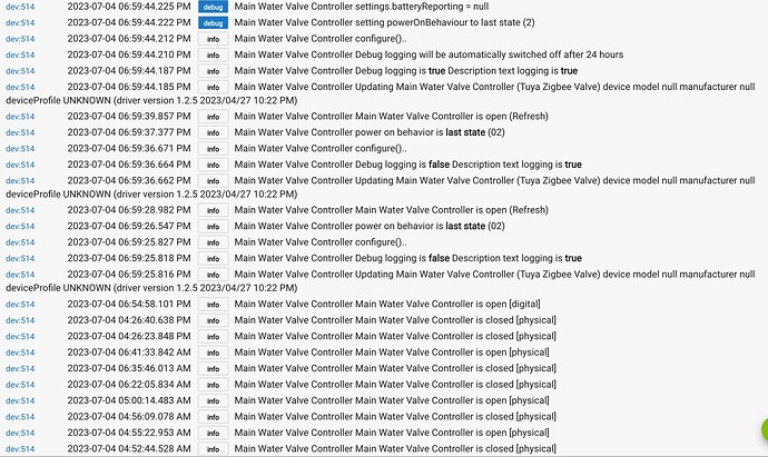

This is the log.

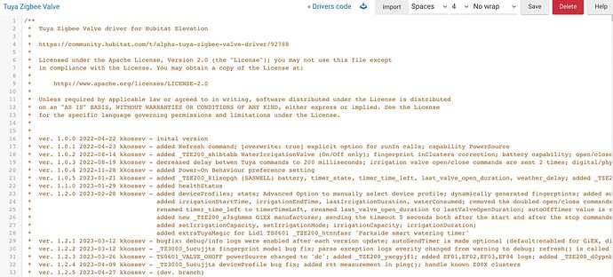

This is the driver version I'm currently using.

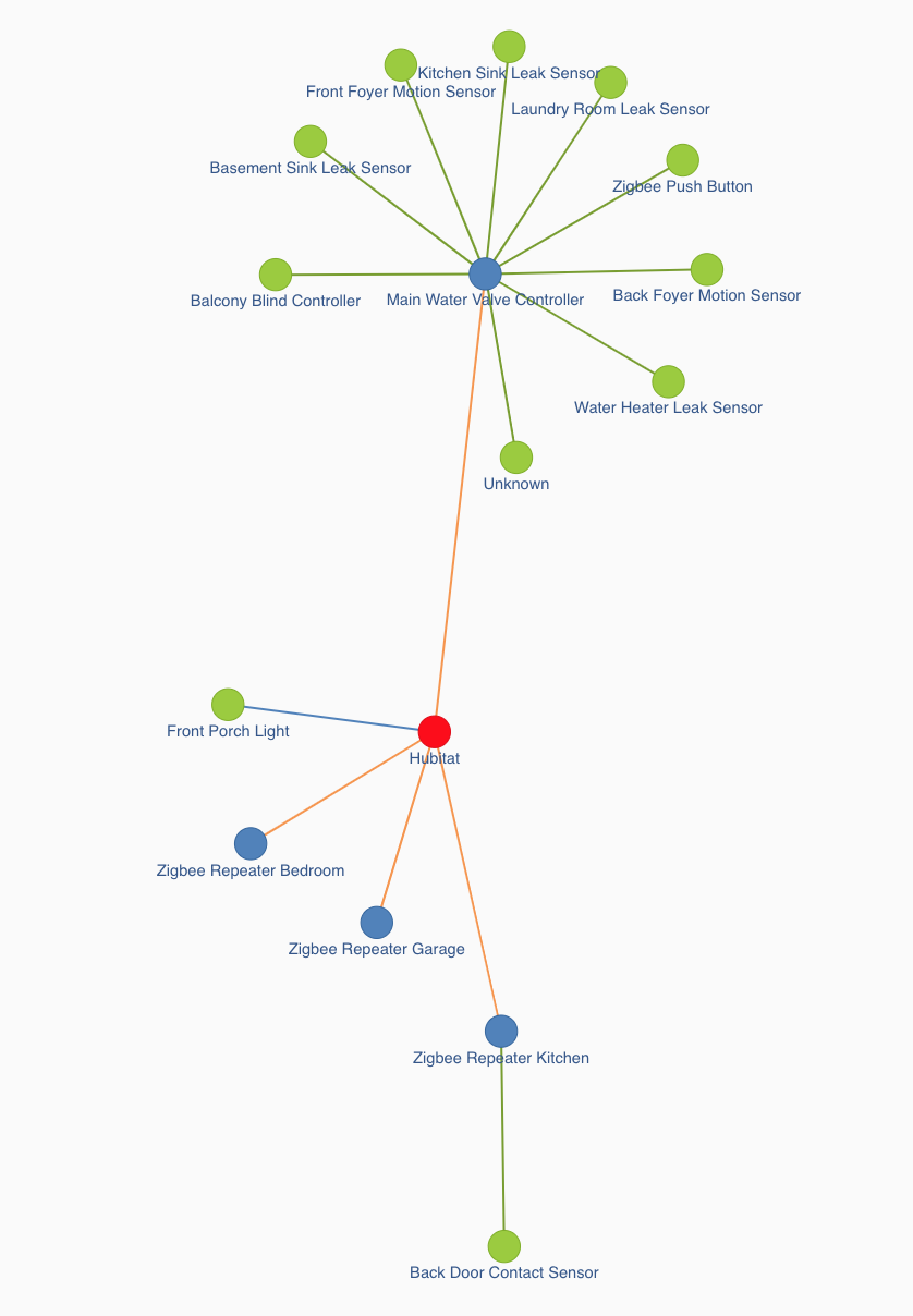

Looking at my Zigbee network graph now, it appears that all my Zigbee devices are linking off of the water valve controller. Is this normal?

Using this DC powered valve as a router/repeater is normal.
The driver is OK, but the button itself may not have paired correctly on the first try.

The open [physical] and closed [physical] events are several minutes apart… so it doesn’t look like an initialisation sequence when the power supply is switched off and then on. But it is worth to try, as the different valve models behave differently.
The driver registers a [physical] event if an open/closed message is received without sending an open or close command from the driver a few seconds before.
