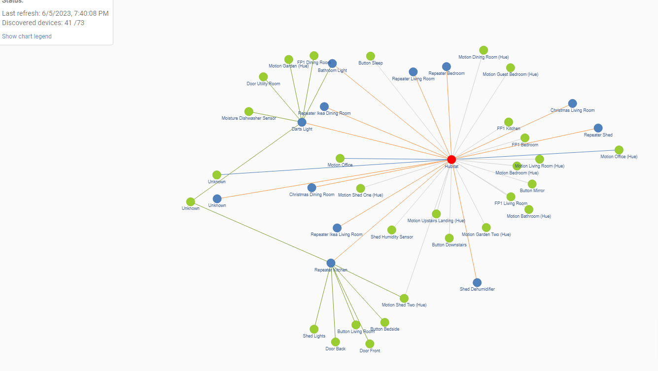

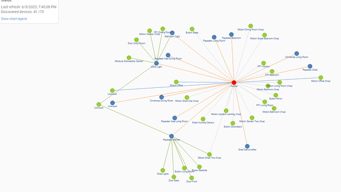

Using the built-in app
I have three unknowns
Address: 69AB
Address: 439E
and
Address: Unknown 0
69AB I've seen data on the Zigbee logs but I have no idea what the device could be
Address: 69AB
Address: 439E
and
Address: Unknown 0
You'll see them when they wake up and report in
He is seeing them in the logs, but it looks like the device entry was possibly deleted, and the device is still paired with the hub. Not sure how you fix that? Reset the device and pair it again? You have to know what device it is though.
Correct I cant see any devices missing so it has to be something every unimportant and one of them is reporting as a repeater so has to plugged in
All very strange

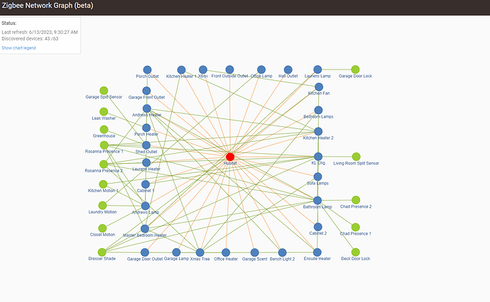

weird i have half of your devices but totally different topology.. mine is hub centric and hardly uses any of the repeaters..
What is your power setting at?
He may be on a c7
C8 default 16
I think that has been lowered in a more recent platform version… to 4 I think, but not 100% sure…
Current default Zigbee power level on C8 is 8.

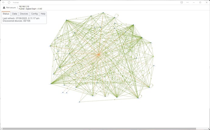

Hi all,
Long time no see, been busy with assembling IKEA products for my home
still a work in progress.
Good news is that version 2.0.0 is out now with the following changes:
zigbee-graph.html file from GitHub into the File Manager (you might need to first update HPM to latest version as this file install feature had some minor issues in older versions)getChildAndRouteInfoJson to remove text parsing and HTML scraping - big thanks to the Hubitat devs for this!As always, your feedback is welcome, especially on the FAQ section as my Zigbee knowledge is seriously lacking and I might have added wrong or misleading info there.
Have fun!
