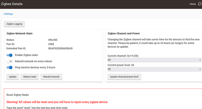

My zigbee details page looks like this:
Yeah, yours looks much better than mine :wink:

I think the C7 makes a difference.

Yes, this is only available on C-8.
That is correct, the additional features are only available on the C-8 models.
