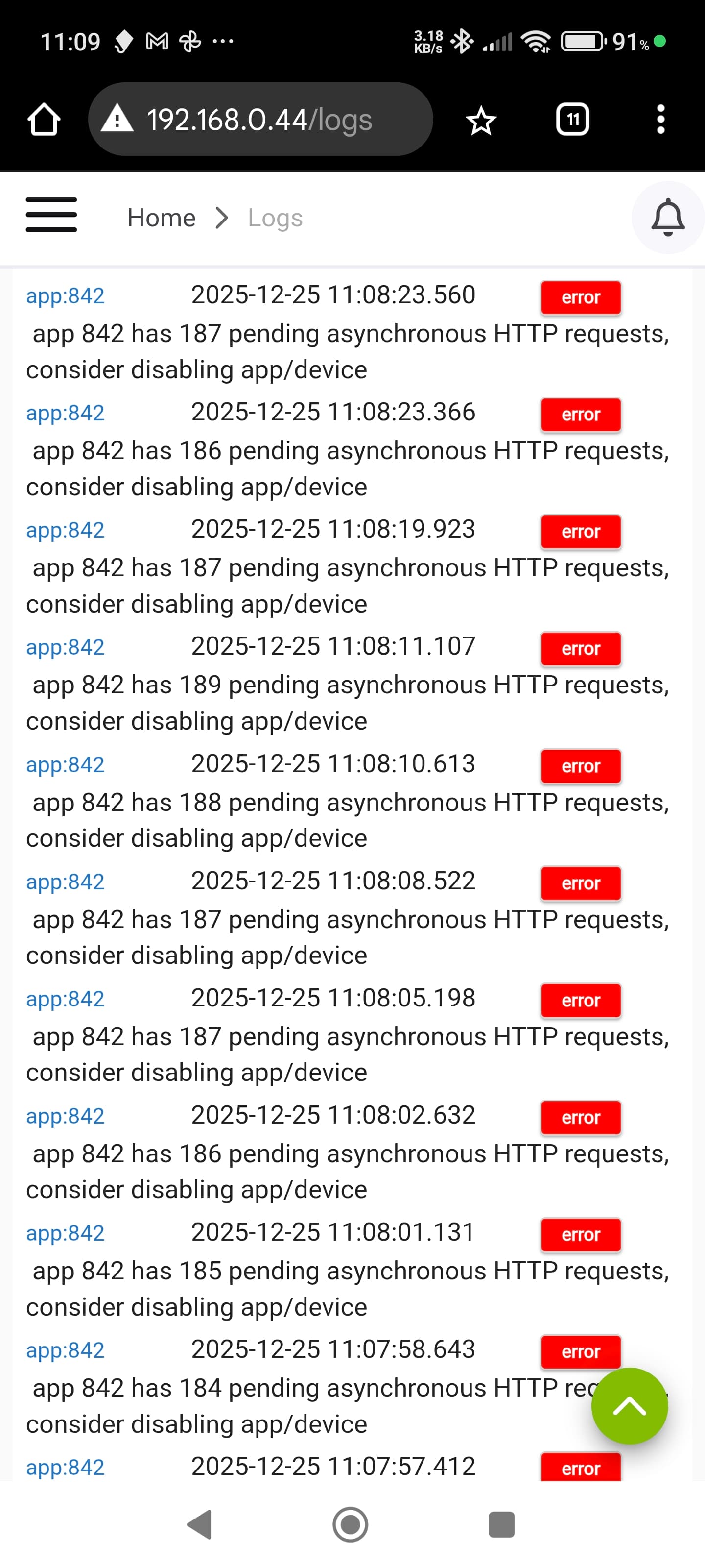

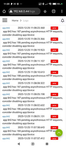

Hi, I have a C8 Pro and have received this message a few times in the last day or so. "ZigBee radio has gone offline or check processor isn't close to overload appears". I think it's attributed to this error linked to Maker API. Does anyone know what would cause such an error and how to resolve please? Appreciated :+1:

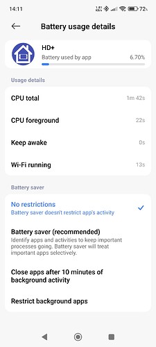

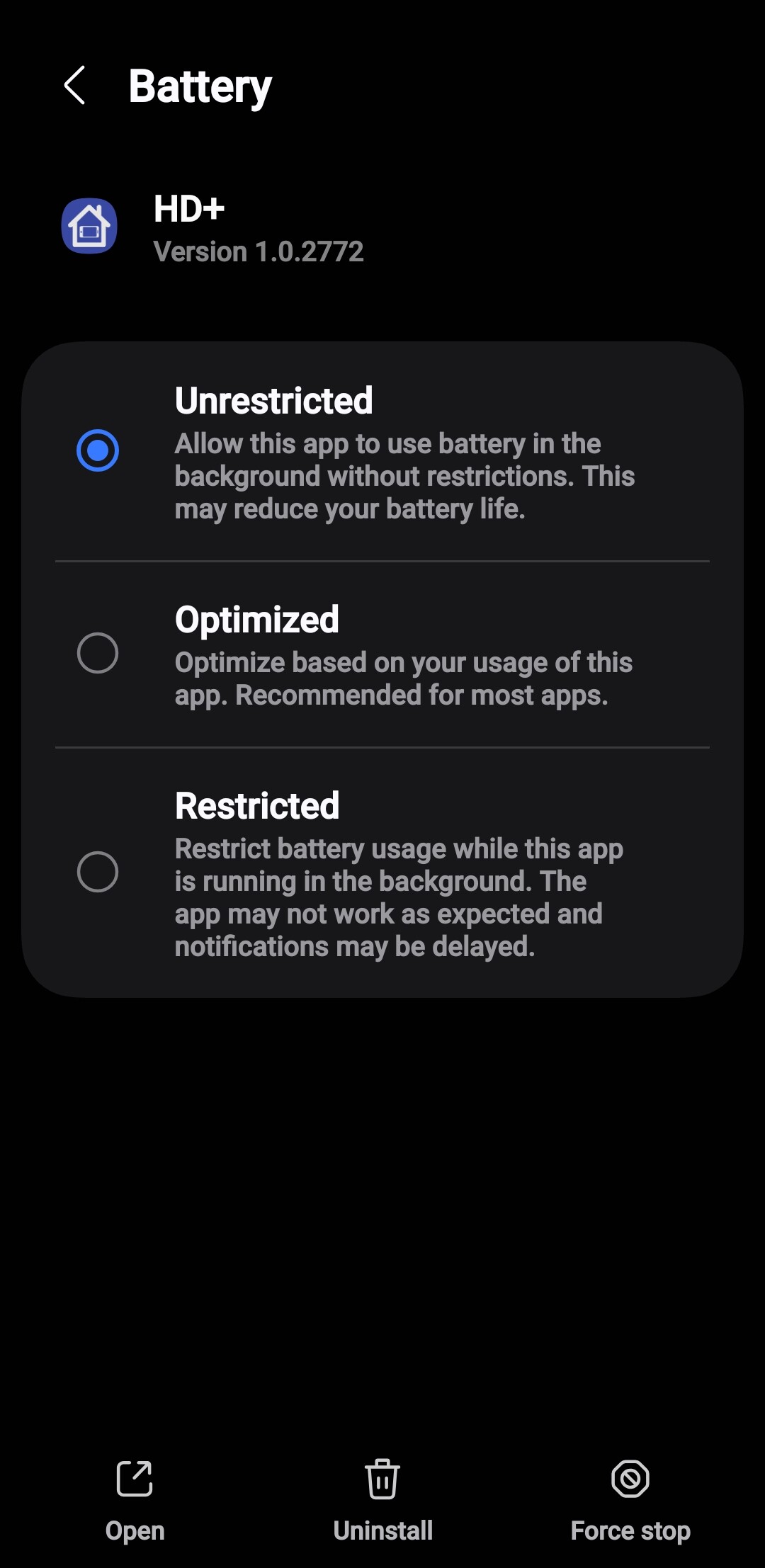

From his post:
"I was able to correct the multiple errors in the log by adjusting the "unrestricted battery" setting for the HD+ app on my Samsung phone. Thanks to those who pointed me in the right direction and helped me find this solution."
Set the HD+ app battery permissions to Unrestricted

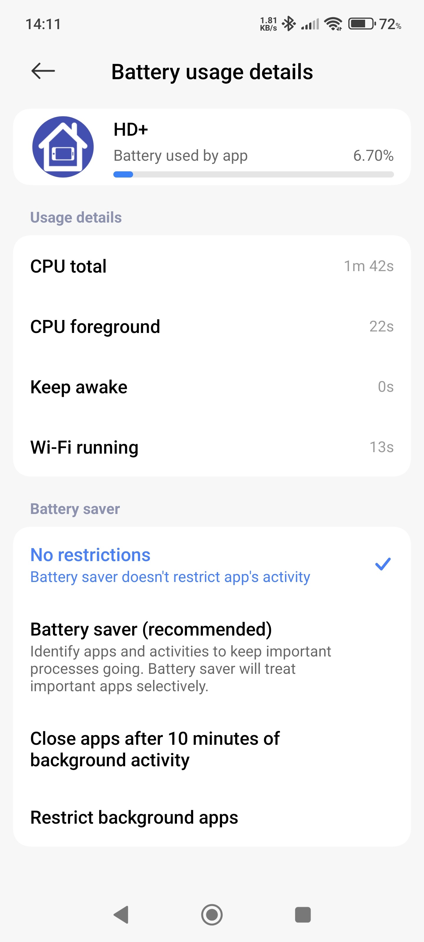

Yeah, I've tried this but to no avail. How frustrating.

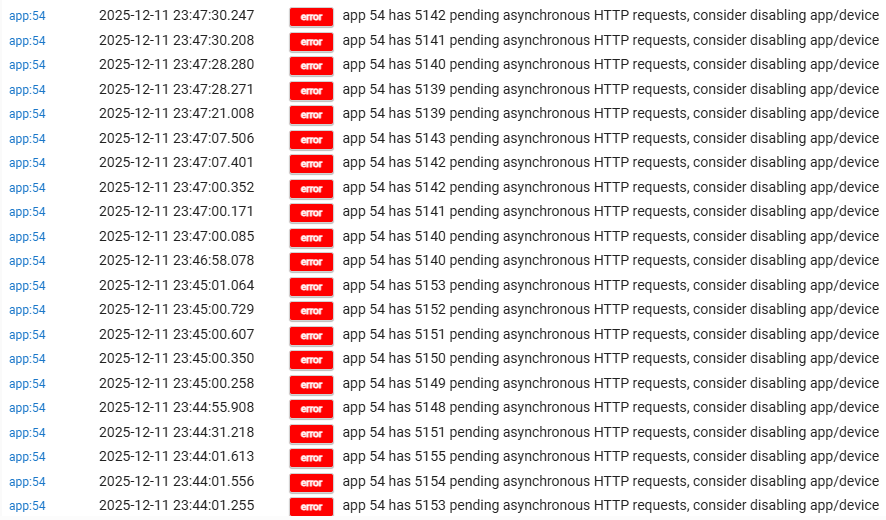

Do you POST a lot of device events ?
EDIT: the reason I ask is that the error you are seeing is because MakerAPI is making (too many) calls out to something. The technical explanation is that apps have a pool of up to 8 concurrent HTTP calls that can be pending at any given time. You have way more than that.
Things to try:
  • identify the device(s) spamming events & remove them
  • reduce the number of devices you post events for
  • split devices across multiple instances of MakerAPI
