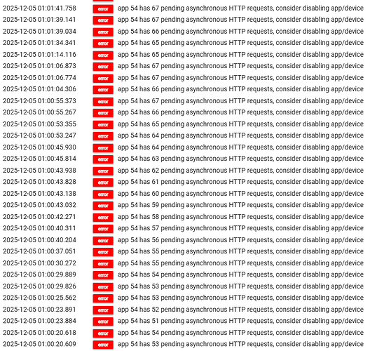

Maker API has started giving me more and more "pending asynchronous HTTP requests" errors. What would be the best way to diagnose this problem? I'm using Maker API to update a dashboard on my Android phone. Any help would be greatly appreciated.

I was able to correct the multiple errors in the log by adjusting the "unrestricted battery" setting for the HD+ app on my Samsung phone. Thanks to those who pointed me in the right direction and helped me find this solution.

Hello stueyhugues, the change I made was on my mobile device. I searched for HD+ in the device SETTINGS. Then I went to BATTERY where I selected the UNRESTRICTED BATTERY option.
