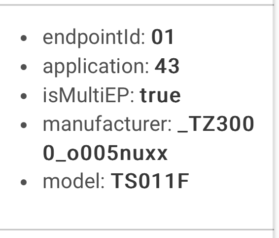

What do you get in the data section?
  • endpointId: 01
  • application: 64
  • isMultiEP: true
  • manufacturer: _TZ3000_cfnprab5
  • model: TS011F
@kkossev

I honestly can’t recall if I had any issues pairing but IF I ever do have issues, with new devices being discovered and then not performing as expected, I remove the device, then do a PAIR with the device close to my hub (C7) and that sorts it out and allows me then to just move the device to where I want it.
I’m using the Generic Multi-End point driver.
I have the Aussie version also and I use this driver - Zemismart ZigBee Wall Switch Multi-Gang.
