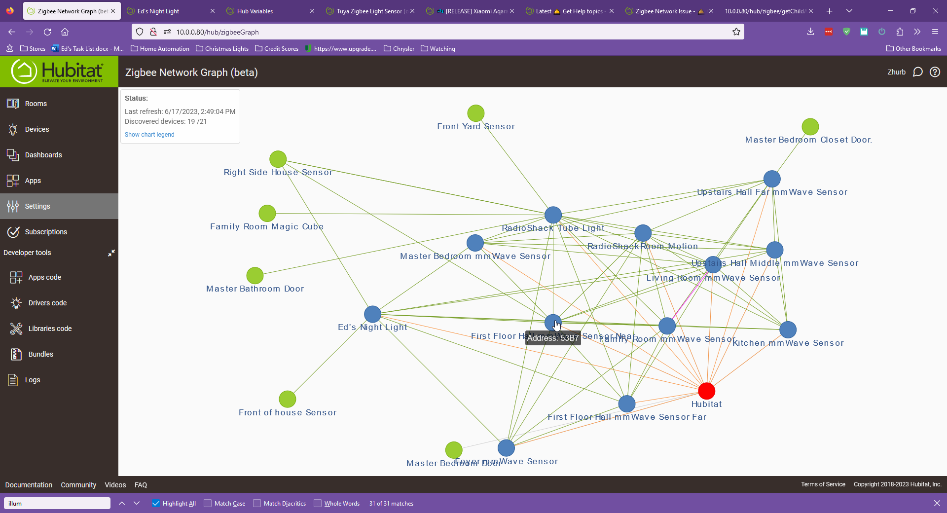

I think that my mesh looks good...

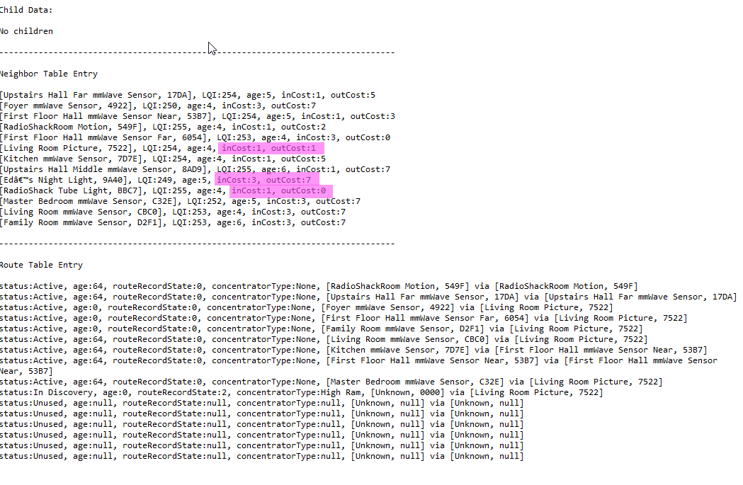

Here are the child and route info...

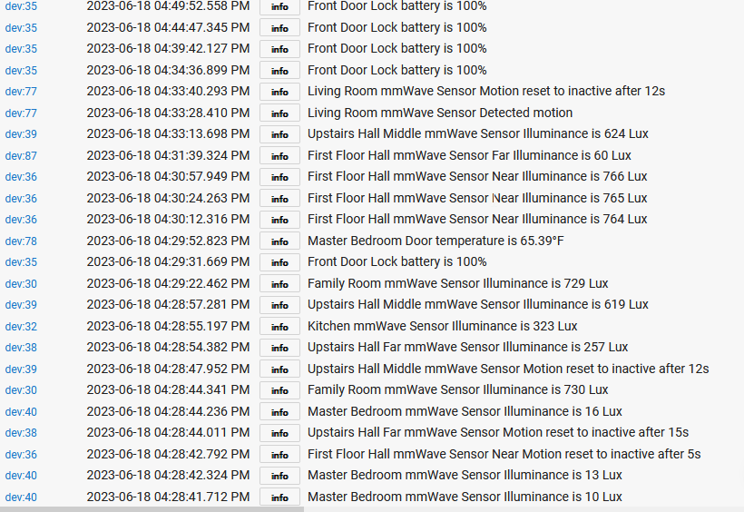

Things went down at 11:00 PM last night. Here are the logs from just prior to the outage...
I know that I probably shouldn't have two devices with debug, but even then, the traffic didn't seem too outrageous.

... and the mmWave radars seems to be bad repeaters/routers... or your Zigbee mesh may be suffering from a WiFi interference?
Here are my 2 Tuya radars stats: (inCost:1, outCost:1) :
[Radar Tuya _TZE200_ztc6ggyl LivingRoom, 8260], LQI:255, age:4, inCost:1, outCost:1
[Radar ZY-M100 MyRoom, DEA7], LQI:255, age:4, inCost:1, outCost:1

Good repeaters/routers should show in the Neighbour Table Entry section with low inCost and outCost values (but not 0!).

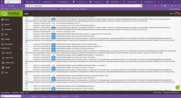

And it is down again this morning! I'm looking at the logs and nothing stands out. I'd say that the zigbee traffic was quite low.
The top 4 lines on this log are all z-wave. The 5th line (dev: 37) is the last zigbee transmission.

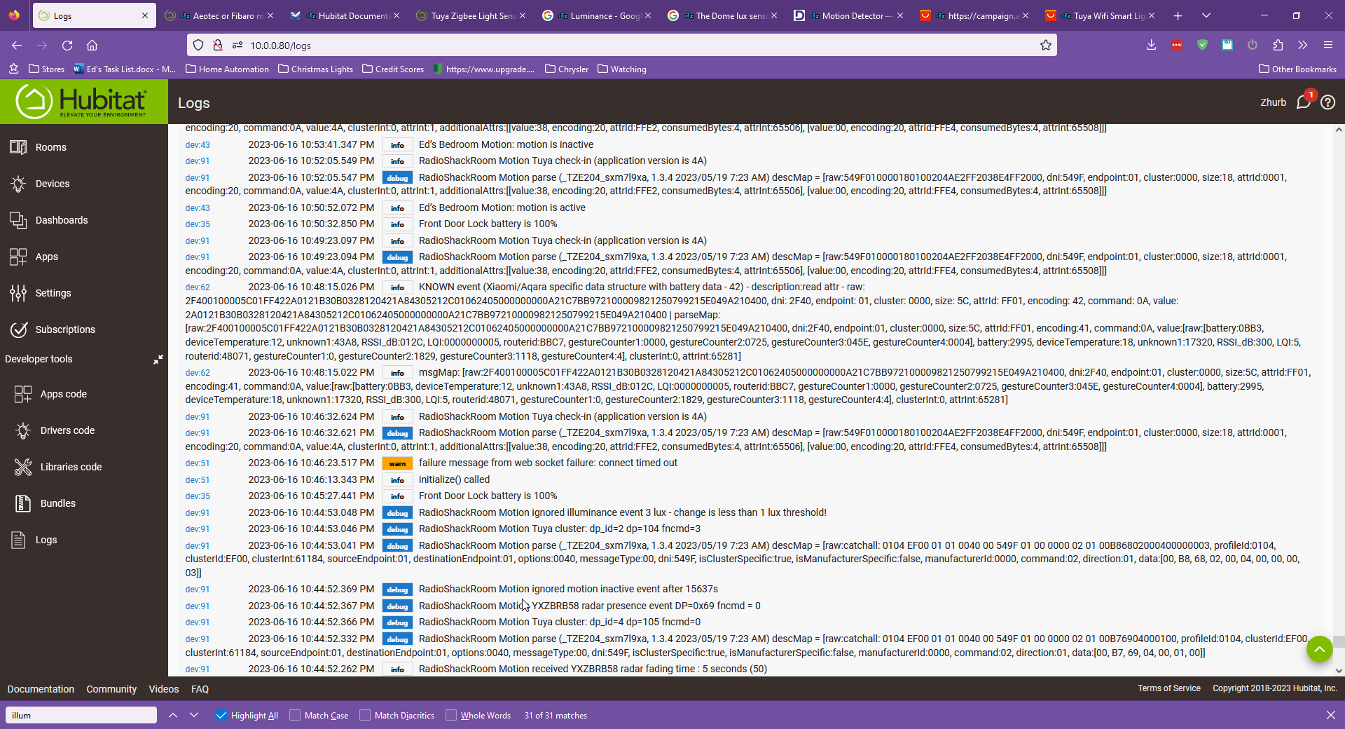

Here are the logs from immediately before the second down today...

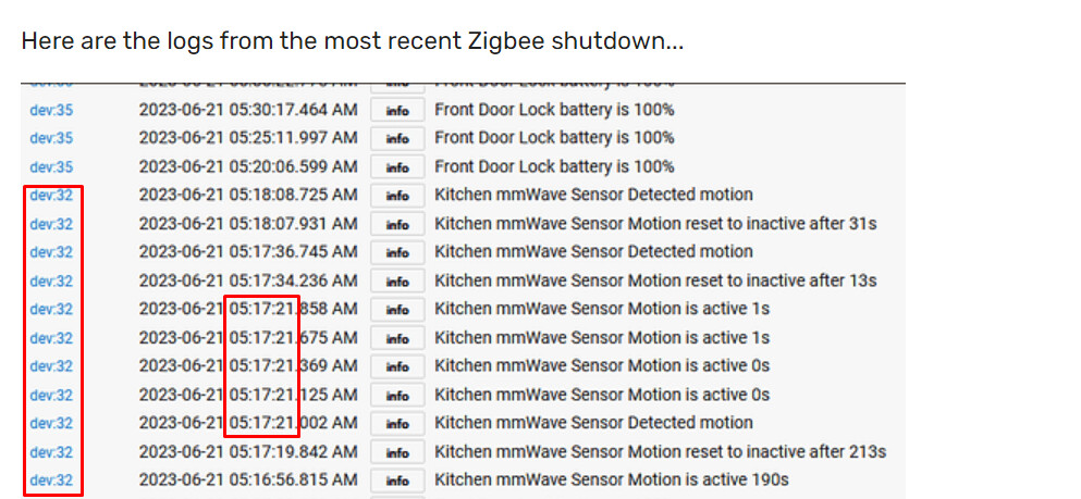

Here are the logs from the most recent Zigbee shutdown...
I still have the "end" devices (non-repeaters) shut off (no batteries) so that I can identify the issue with the zigbee network without too many variables.
Note that the TRÅDFRI repeaters (in purple) seem to be struggling as much as the Tuya mmWave sensors. So, I do not believe that this is device related.

These logs are not normal... You should not have 'motion is active' duplicated INFO logs. Seems like two instances of the driver are processing one and the same message from the device. I haven't seen something like that so far.
If you press Control-F to search for ""4 in 1" in HE Drivers Code page, do you see more than one driver named 'Tuya Multi Sensor 4 In 1' like in this screenshot?
