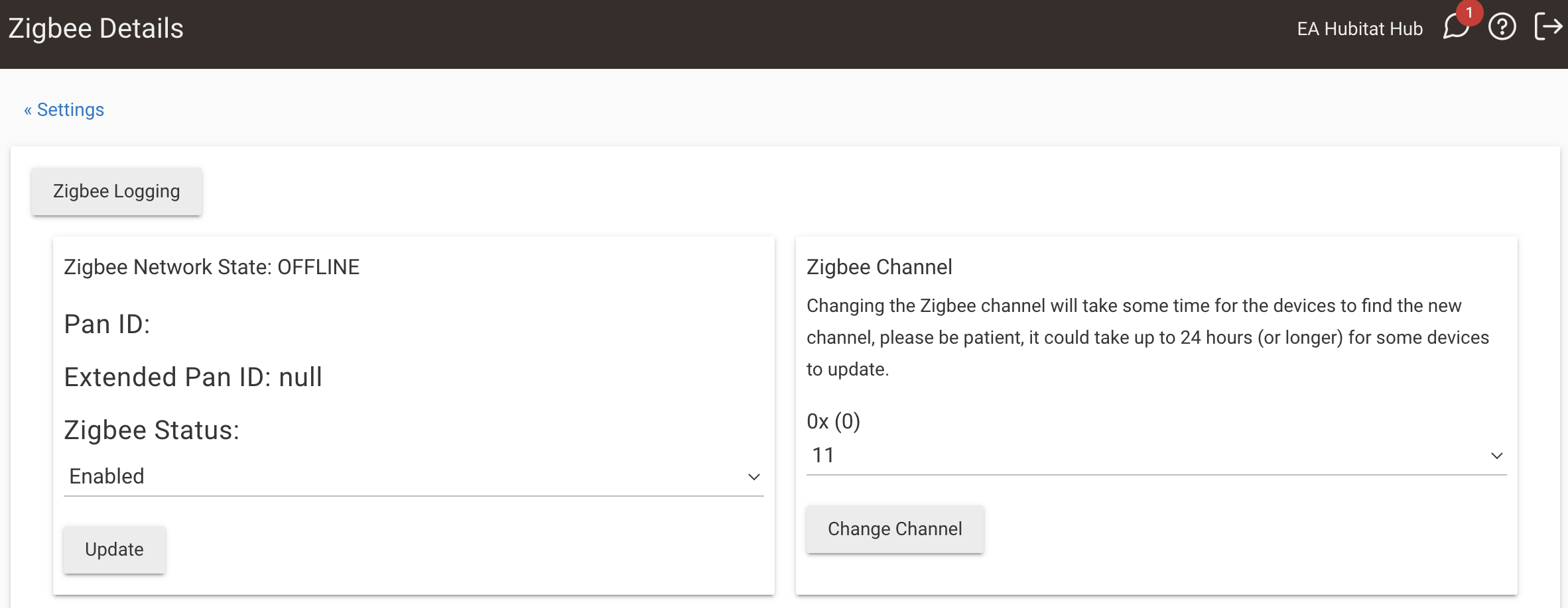

Hi!
  1. It is running on channel 11.
  2. This is what the getChildAndRouteInfo show:

Zigbee Channel 11 is often not very ideal, as it conflicts with 2.4GHz WiFi channel 1. What WiFi channel(s) are being used by your home network?
It is always best to make sure your 2.4GHz WiFi network is only using channels 1, 6, and/or 11, with a 20MHz channel width. This will create three distinct non-overlapping gaps that Zigbee channels 15, 20, and 25 will work with minimal interference.
This is not to say that 2.4GHz WiFi interference is the source of your issues. However, I know some devices really do prefer to be used on specific Zigbee channels. Most users seem to find Zigbee channel 20 to work with the vast majority of Zigbee devices that have been produced over the past decade.
If you have a Philips Hue bridge, or any other devices creating their own Zigbee mesh networks, you should also make certain that they are not using the same Zigbee channel as your Hubitat Zigbee mesh network. For example, I run my Hue bridge on Zigbee channel 25, and my Hubitat hub on Zigbee channel 20. My WiFi access points are configured to use 2.4GHz WiFi channels 1, 6, and 11 with a 20Mhx channel width. Both Zigbee networks in my home have been very reliable, and fast.
One more thing - I personally do not recommend Zigbee channel 26, as many devices do not work well with it, and it has a lower power output due to FCC regulations.

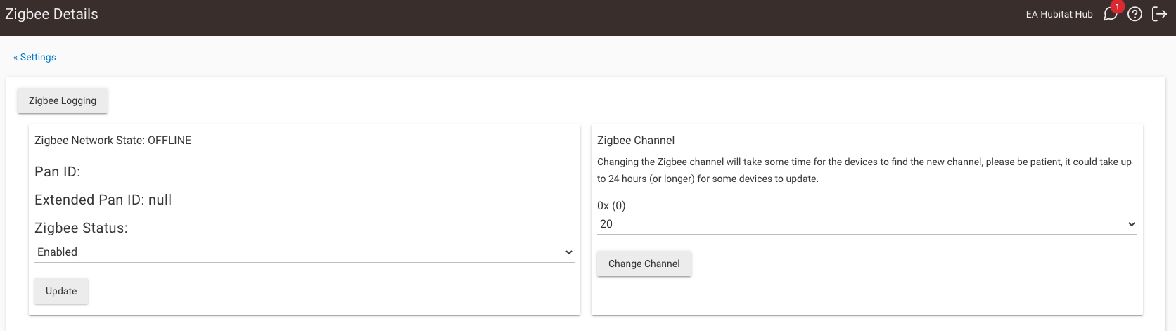

Hi @ogiewon,
I have changed the configuration of the router to use channel 6 at 20MHz in the 2.4 GHz network, I also updated the configuration of the ZigBee network to use channel 20.
Thanks for the recommendation.
Looks like your Zigbee network is currently showing as OFFLINE. If that is still the case, please perform an orderly shutdown of your hub from the SETTINGS menu. Then pull the power supply from the wall outlet, wait 10 seconds or so, and then plug it back in. Hopefully the Zigbee radio will then show up as being ONLINE.
Once you get past that hurdle, then take a look at each of your Leviton devices, to see if they have power reporting enabled. If so, let's disable that feature for now.

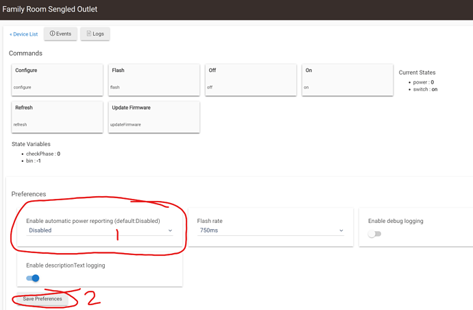

  2. "Another thing to check is whether or not the Leviton switches and dimmers are flooding the Zigbee mesh network with Power/Energy reporting messages. A very chatty set of devices could cause the hub to become overwhelmed with traffic."
Could you please explain to me how to do that? I was reading a similar post right here and changed the Logs setting in the "Device stats" part to 5.

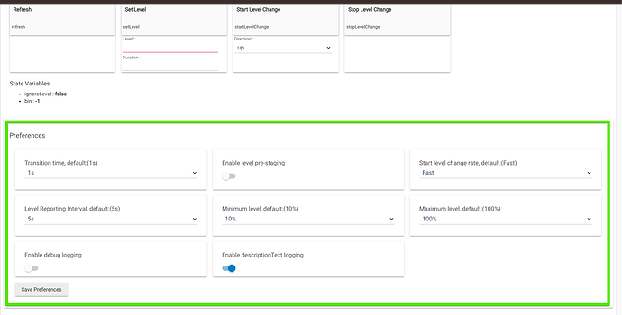

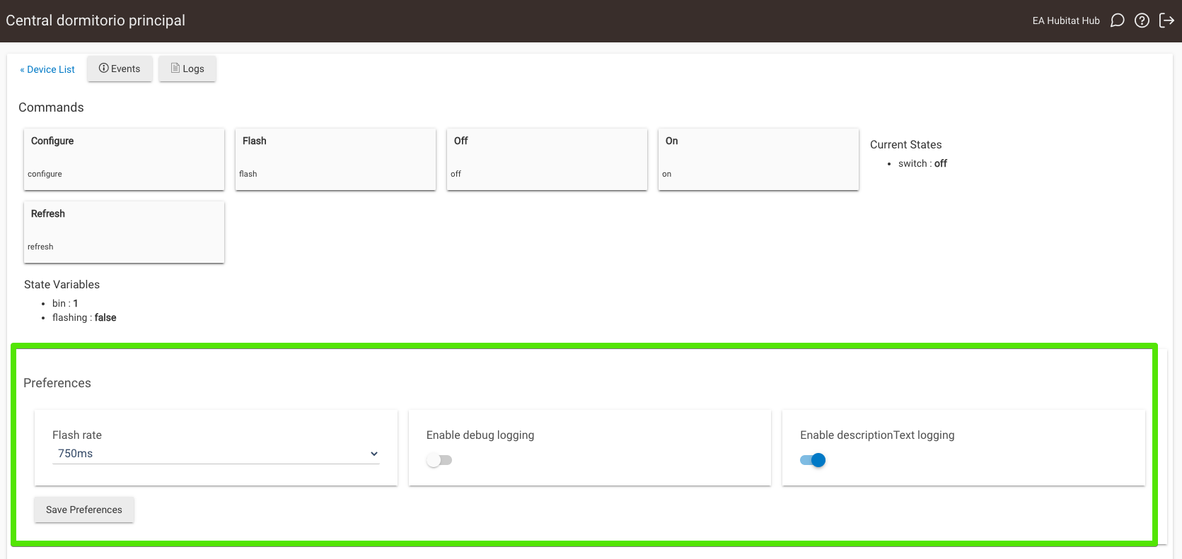

So, open up each of your Leviton switches and dimmers in Hubitat, one at a time, and look for a User Preference similar to that shown below. If there is a power reporting feature, please set it to disabled. Then click SAVE as highlighted below.
I already did the steps mentioned above,
But it didn't work, what I did was turn off all the breakers of the lights part of my house, I left the house without light for a while and then I reconnected everything, the ZigBee radio is now online.

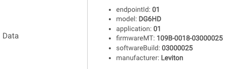

I've checked every single device I have and none of them have that option:
Switch:
Dimmer:
Thanks!
