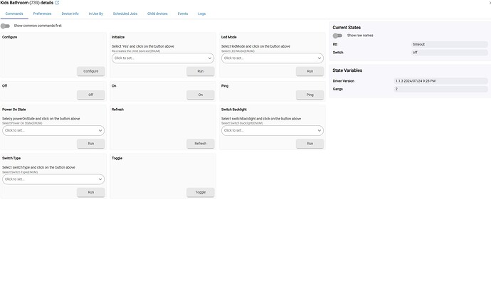

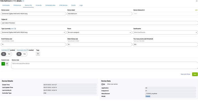

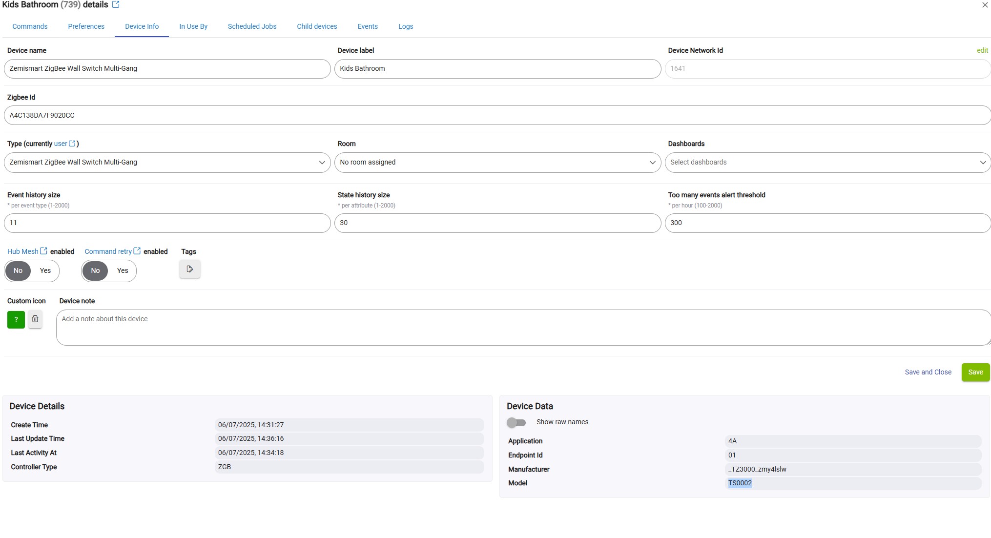

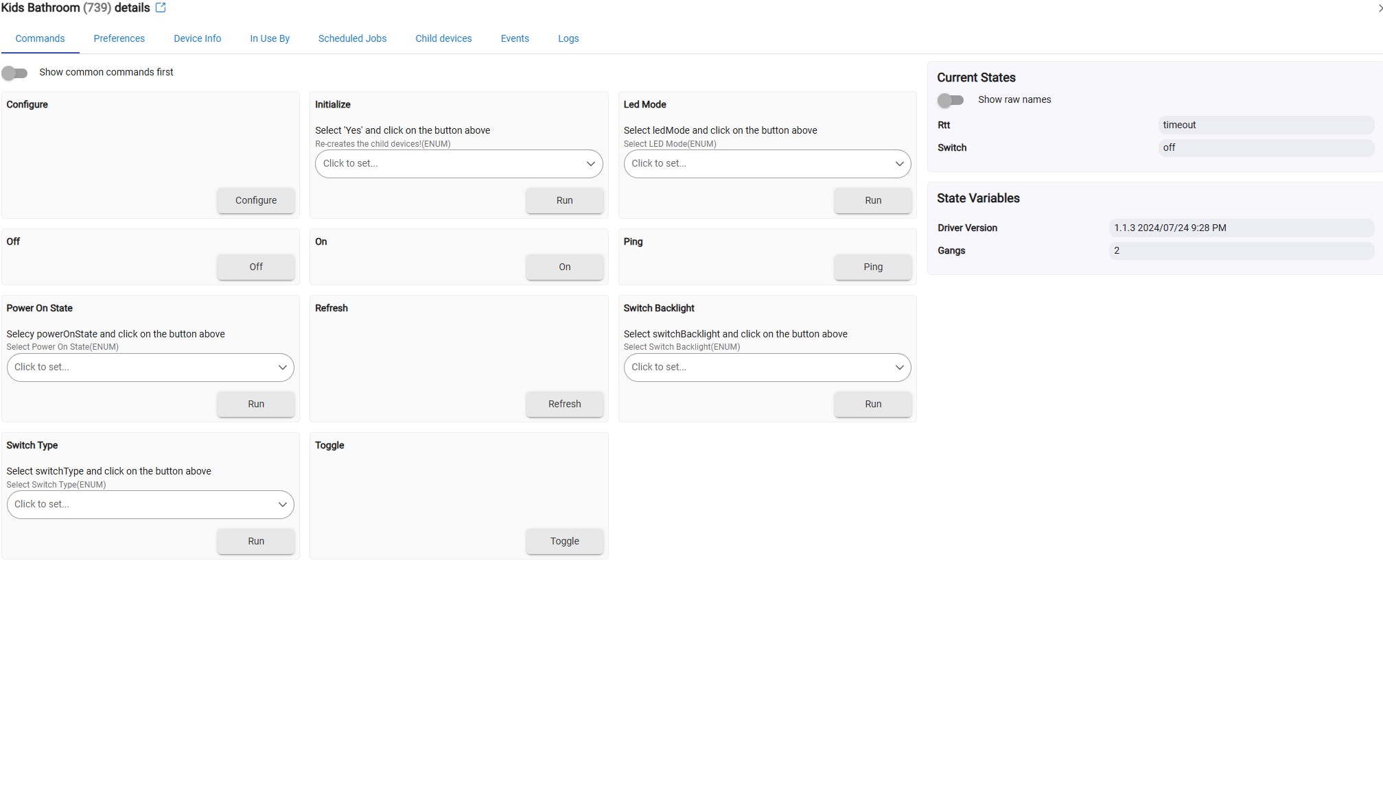

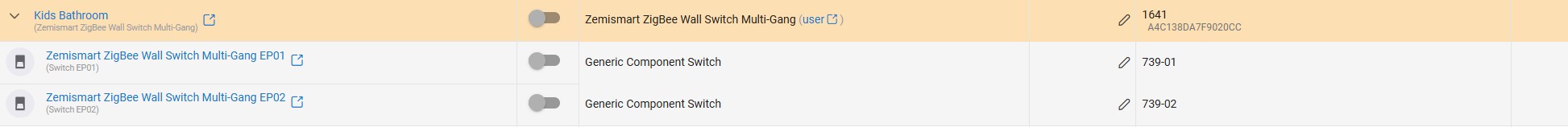

Been trying to get this device to work, Its a zigbee 2gang switch from aliexpress (Yes, I know I'm cheap). Its Model is the TS0002, from _TZ3000_zmy4lslw. I've tried heaps of different drivers, removed and readded about 50x but nothing. It adds fine, and I can see both child devices, it just does not want to command? Any help would be greatly appreciated,
