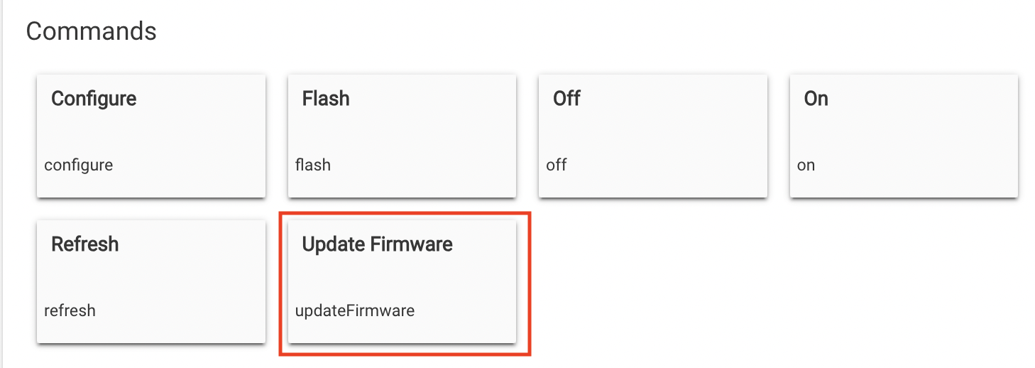

To check, go to the top of sensor's Device page and look for a "Update Firmware" button (hopefully that option will be there). My example here is from a different ZB device. If it's there, open a new browser tab with the Live Logs view up.
Click the Update Firmware button - the Live Logs page will reflect update status -- if no update is available, it will say that. If it is available, you'll be able to monitor the progress on the Logs page.

The Update Firmware button will always stay there -- it's unfortunately not dynamic based on f/w availability.
