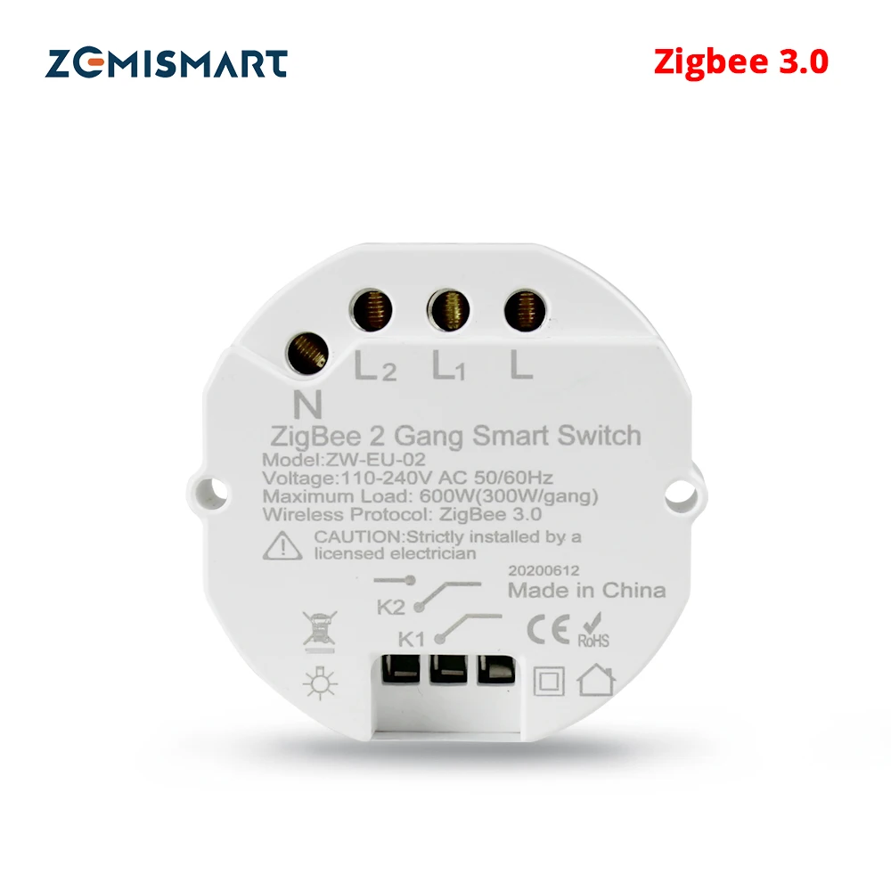

@mattias is the 2 switch model the zemismart?
Be keen to here how you go. Bout to order some myself
@bdydrp It’s this one here: Wholesale 2 Gang 3 Way Smart Light LED Switch Module Relay For Smart Home Automation Device Zigbee 3.0 Controller System From m.alibaba.com
The Alibaba site is crap at readily giving you the information you need but you should find the 2-gang device under variations and if you scroll down further there are some images of it as well
@mattias Haven't looked at alibaba!
These are the ones I was referring to...

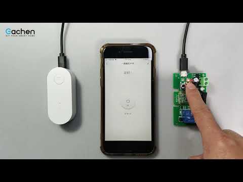

I wonder if these work with Hubitat:
From this video they seem to support adjusting the "inching" duration:
But I'm not quite clear on what app they are using there and what dongle thingy this is and whether you need a specific hub to do that adjustment and whether that adjustment would be reset if you then try to connect it to a Hubitat instead (probably).
But if the hardware supports it... maybe there would be some way of getting Hubitat to support it too.
FYI, those are the modules that @mike.maxwell is adding support for in platform 2.2.9. There are no exposed configuration parameters to adjust the inching duration. Also, I'm not seeing where they do the adjustment in the video.
Also the "dongle thingy" is a 5V USB power supply.

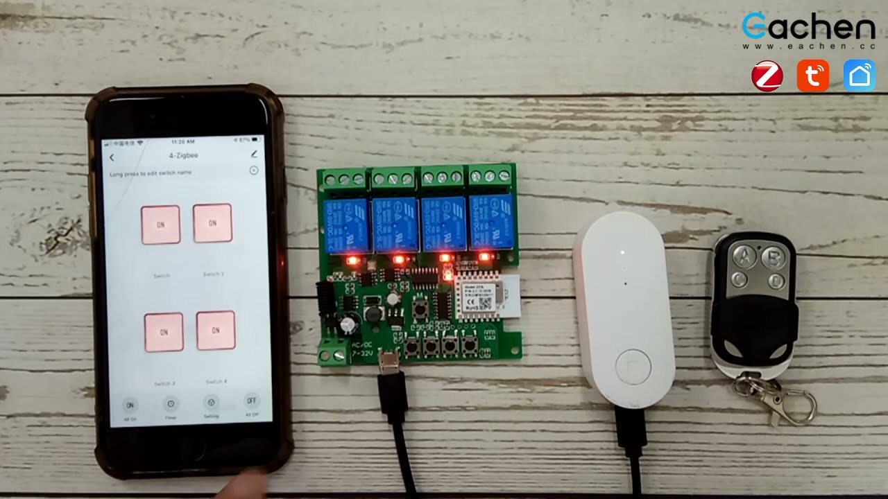

@aaiyar sorry I managed to mess up the link and used the wrong video.
Here's the correct one (I'm linking to the correct time also to waste as little more of your time as possible :wink: )
This link also suggests that the MHCOZY relays do have the ability to configure the inching duration (although this is the wifi version... not sure if that makes a difference):
I also swear that I saw a video of that somewhere but I can't find that now.
So I'm curious to know how much effort it would be (or if it's at all possible) to add that to a driver for these things. There's also the possibility that the inching functionality isn't really being implemented on the hardware itself at all, but rather that this is some functionality in the app/hub that they use, whatever that is.

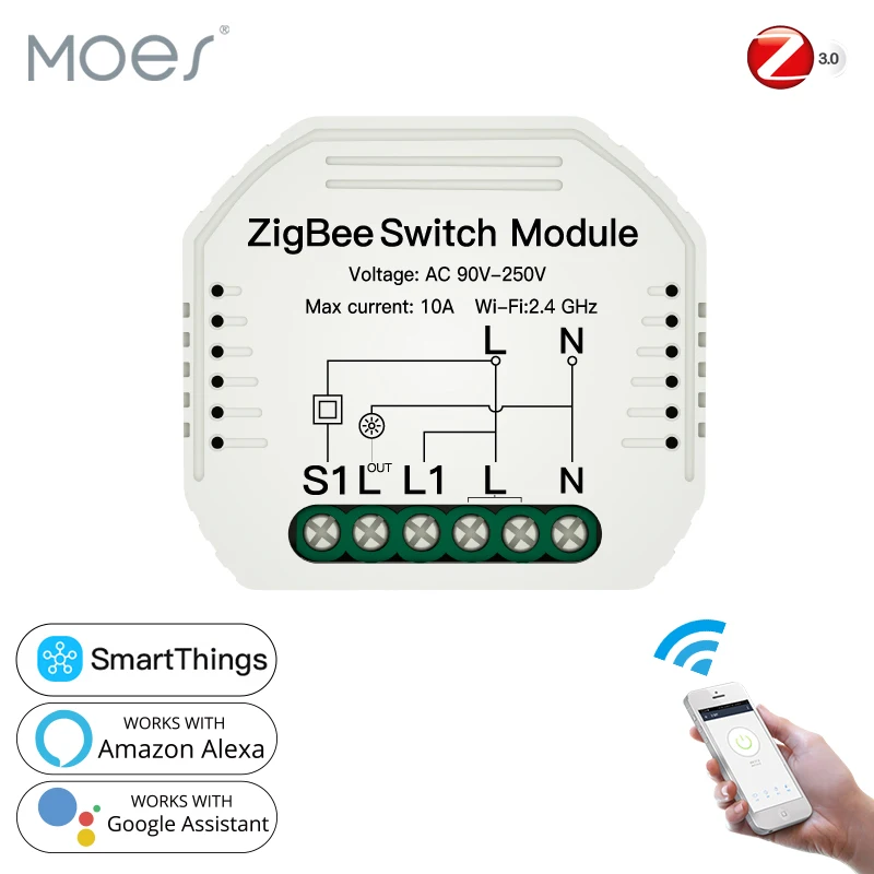

Any idea on how I can wire this to a NC circuit with a NC and C (common) wire so that it notifies me when the NC is opened. It’s for a sump pump. I have the NC and C wires from the sump pump wired to Lout and L1 but it does not change state when the NC is opened by an alarm.
Welcome to the community!
Can you maybe post a picture or drawing, my brain isn't getting what you're saying. :confused:
You might need to go to Hub owners - Hubitat , join the group and then you'll be able to post pics.
I have a sump pump where the alarm is connected to a NO/NC contact
9dda277df71174aa9700d7155b1d35483bf0aa4b_2_488x500
I connected the NC and C to the relay, Lout and L1.
a3d06f3932308f4edf2764a029bf62d13df10718_2_295x500
But I am not able to read the relay state by the software switch to get a notification when the alarm triggers.
I was wondering 1) is my wiring correct 2) does not module not support relay state to switch state mapping.
