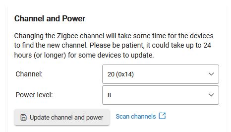

  • What channel and power level is your Zigbee on?

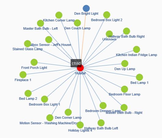

I have 1 device that serves as a repeater. Sometimes it has about 4 bulbs connected through it when I view the device graph, and sometimes it has none like the current photo shows.
Yes, My hub is within 15 -20 feet of nearly all devices. Furthest items are 35 feet away from a very centralized hub location in my residence
So without more repeater devices, is there a max qty of items? What are the other benefits of adding a few more repeaters if in my house layout distance from the hub is never an issue?
Zigbee Power
Zigbee Device Graph
Per the Hubitat document linked above, the max is 32 directly attached non-repeater (“End Devices”).
Add a few repeaters and the Zigbee network can grow very large, if desired.
