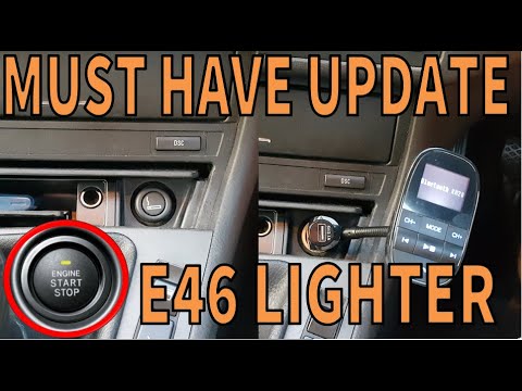

EDIT: I actually may go another route...I'm looking at a mod to change my cigarette lighter (which provides power to my USB devices) to be switched off when the car is off. Fixing that will fix all of my USB power issues. I also have an add-on BT receiver powered via the same circuit and I'd like that to be off when the car is off so the phone doesn't accidentally connect when I'm near the parked car. I have a button to turn off the power after it leaves the cigarette ligther, but both I and my wife keep forgetting to turn it off so it mostly is on all the time. Looking at this mod...looks like all I need is some wire and a couple insulated spade crimp connectors.
Fusebox will be in your manual. That said if you have an always on 12v jack (cigarette lighter or power port) you can tap into the back of that. Or if you have power seats you can tap into the hot under that. Use a multimeter to find. Ground at any bolt or find ground with multimeter.
I have the parts I need assembled to change my cigarette lighter over to only on when the car is on, and will be completing things after the required batteries arrive next week.
