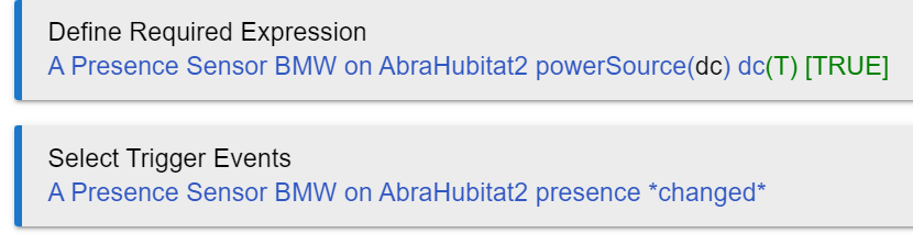

Thanks for the details - perfectly understandable and (surprisingly) what I hoped/suspected. Love it when a device works like I hope it will.
I do think that one simple adjustment to my presence/garage door rules would block any accidental openings of the garage, regadless of the situation.
If I make powerSource = dc a required condition in my presence rules that open the garage, my rules won't run unless the car is running:
When I come home the sensor joins the mesh and reports it's on dc and present my rule will run and open the door.
When the car is sitting in the driveway or garage, it's on battery (as noted I'm converting my BMW to be the same as our other car, USB power only when the car is running) so my rule can never run in that state, which will block any openings when the car is sitting in the garage or driveway.
Am I missing something?
Seems ok to me. But I've had a drink or two celebrating the Pels win :laughing:
LOL...I bet it's at least two drinks. Congrats!
Just tested it and worked fine - w/new mid-range antenna the garage door starts opening at the bottom of the dirveway.
Covers this case you noted:
I think this is locked down and ready to show to the wifey. :smiley: And yes, that is very high praise, @iharyadi, you done good!!
